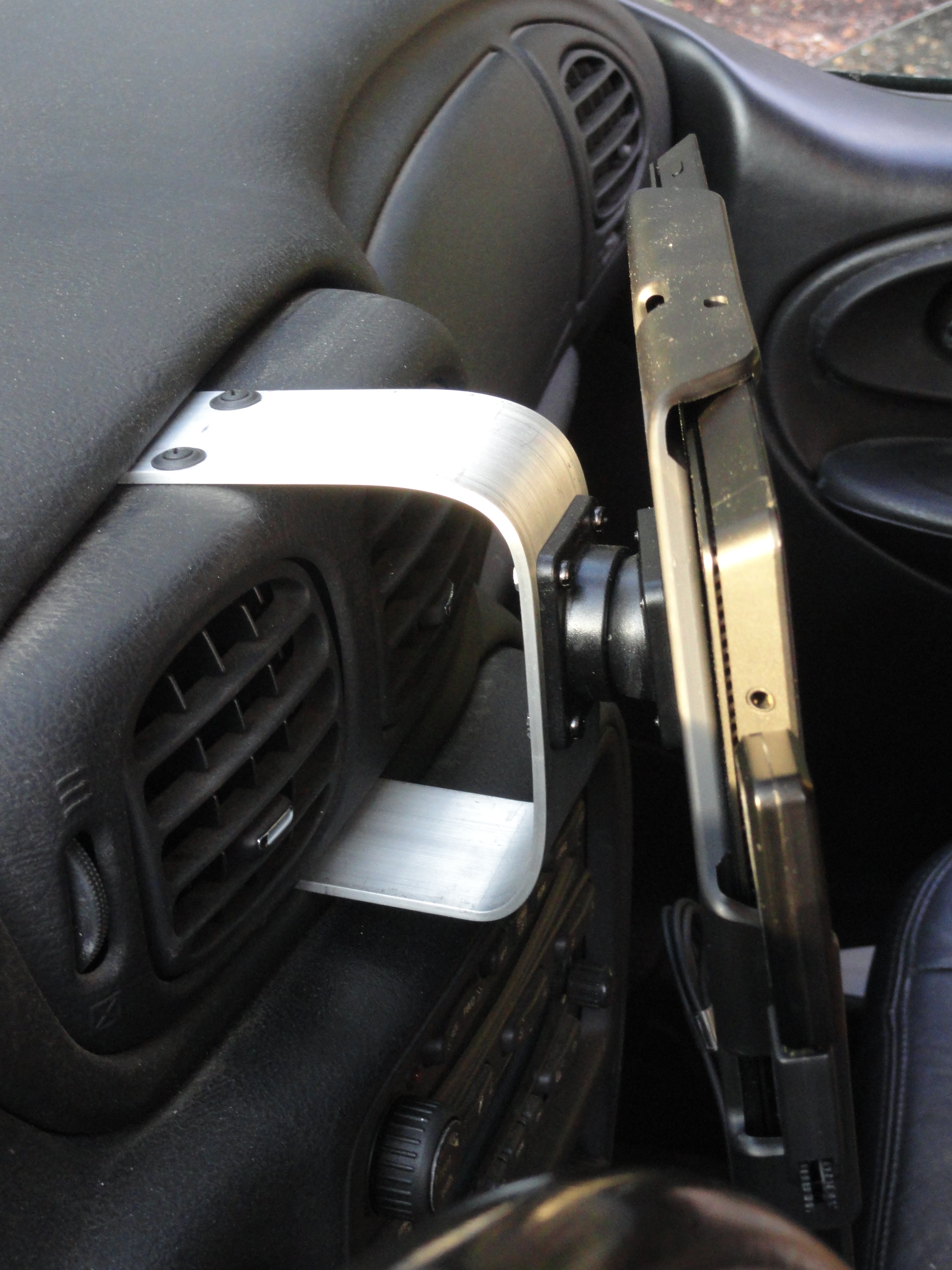

Tablet GPS navigation!

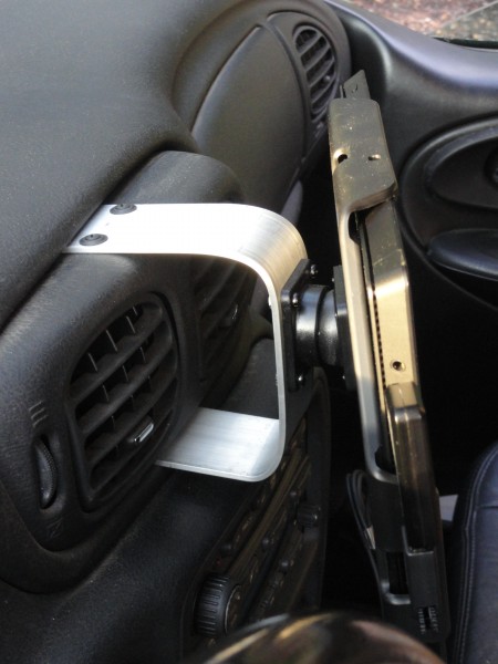

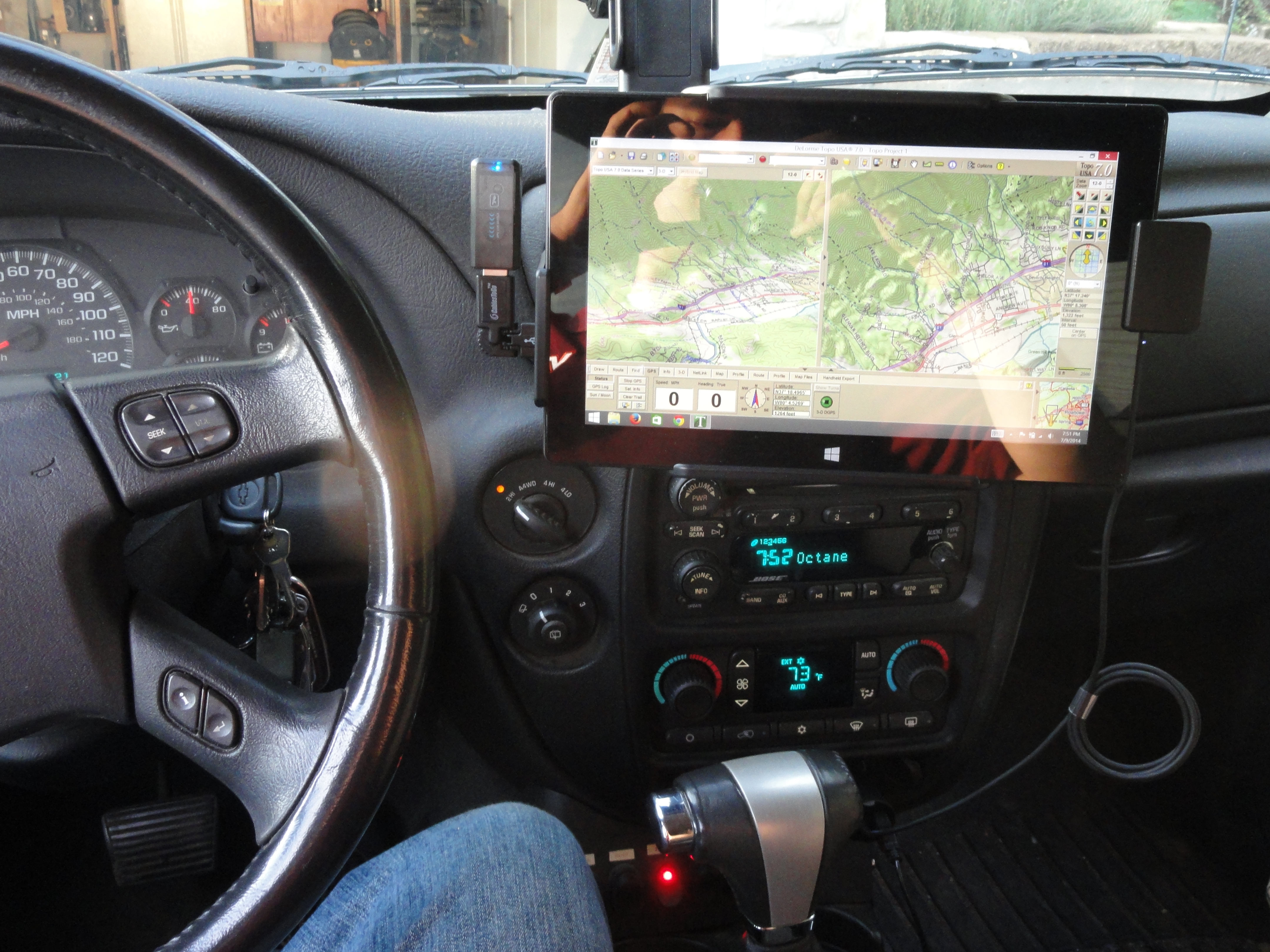

Ever since our trip out west, I've been on the look out for an even better navigation method. The laptop, while effective, takes up a lot of passenger space. It works well for just a driver, but when you add my wife, she's not super thrilled about having a permanent laptop hovering over her lap. I was also concerned about what would happen in the rare possibility of an airbag deployment.
Enter the Surface Pro.
It runs PC applications, just like a laptop, but it's touch screen, and small - plus I run it off of a cig lighter plug, so - no more AC adapter needed to run nav (and no more wiring mess!).
I mounted it over the central A/C vents, because it blocked nothing else being mounted there, plus I talked myself into the fact that it will allow the Surface to keep cool while in use (it can get a bit warm). I used a mount from https://www.proclipusa.com/ that fits the Surface Pro like a glove. All I needed was a little USB GPS unit, and I was golden (could have been better if the Surface had a GPS built in).
Still running Topo USA 7.0, but have been looking around for a better piece of software that doesn't require internet access for maps (which seems pretty rare nowadays).
The tablet is easily accessed by either the driver or the passenger, and is mounted on a rotate/swivel mount so I could technically mount it vertical if I wanted to.

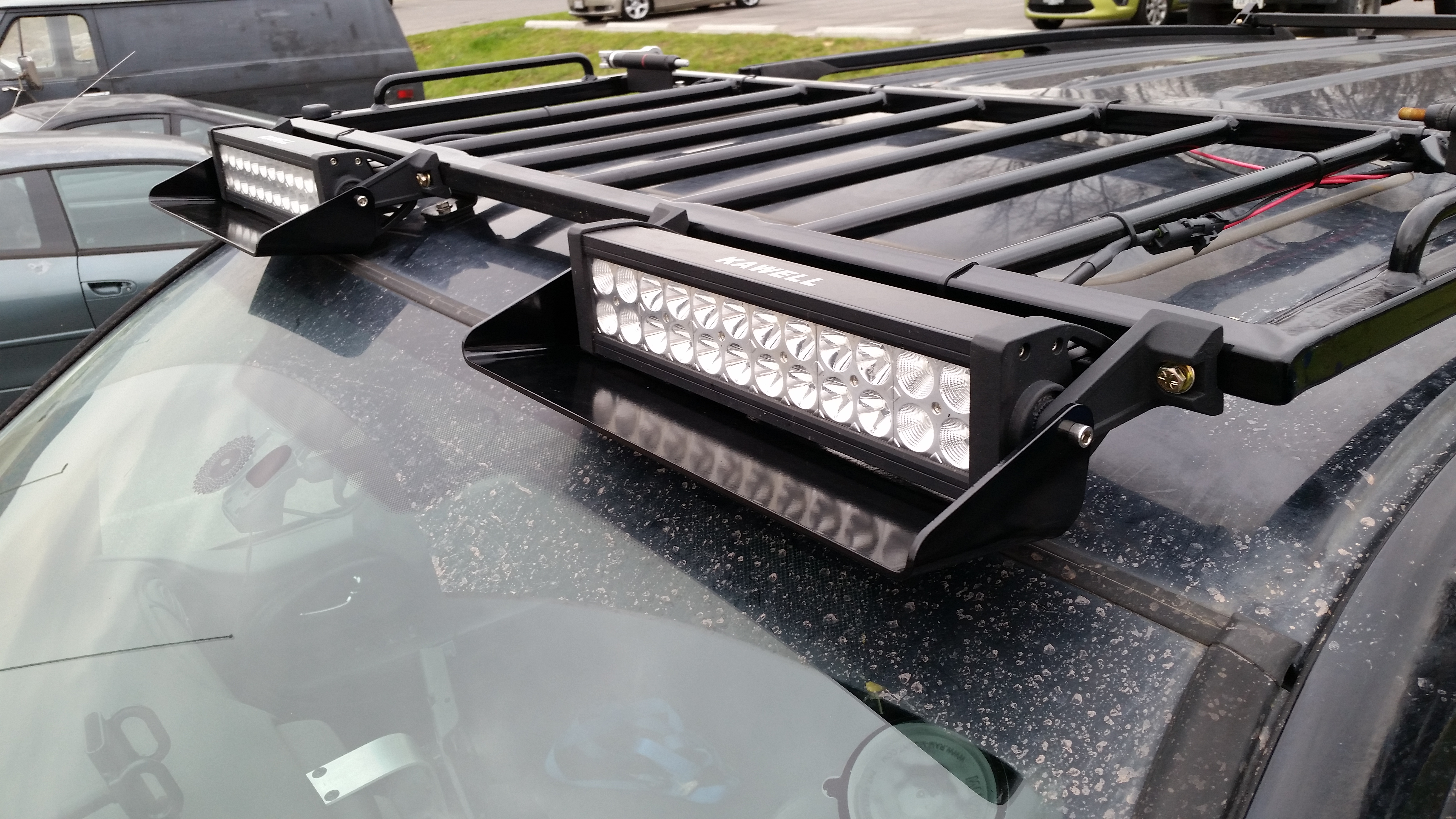

I made and installed a new front "half rack" that is lower profile on the truck. This will replace the old Baja Rack. Its low profile so that I can fit into my garage and not have to unbolt the rack every time I want to carry my bike or kayak. It's also got some nice new LED lightbars up top from Kawell.
I will try to get some beam pattern comparison shots sometime soon.

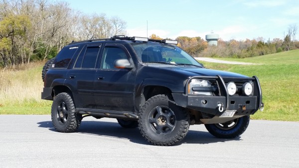

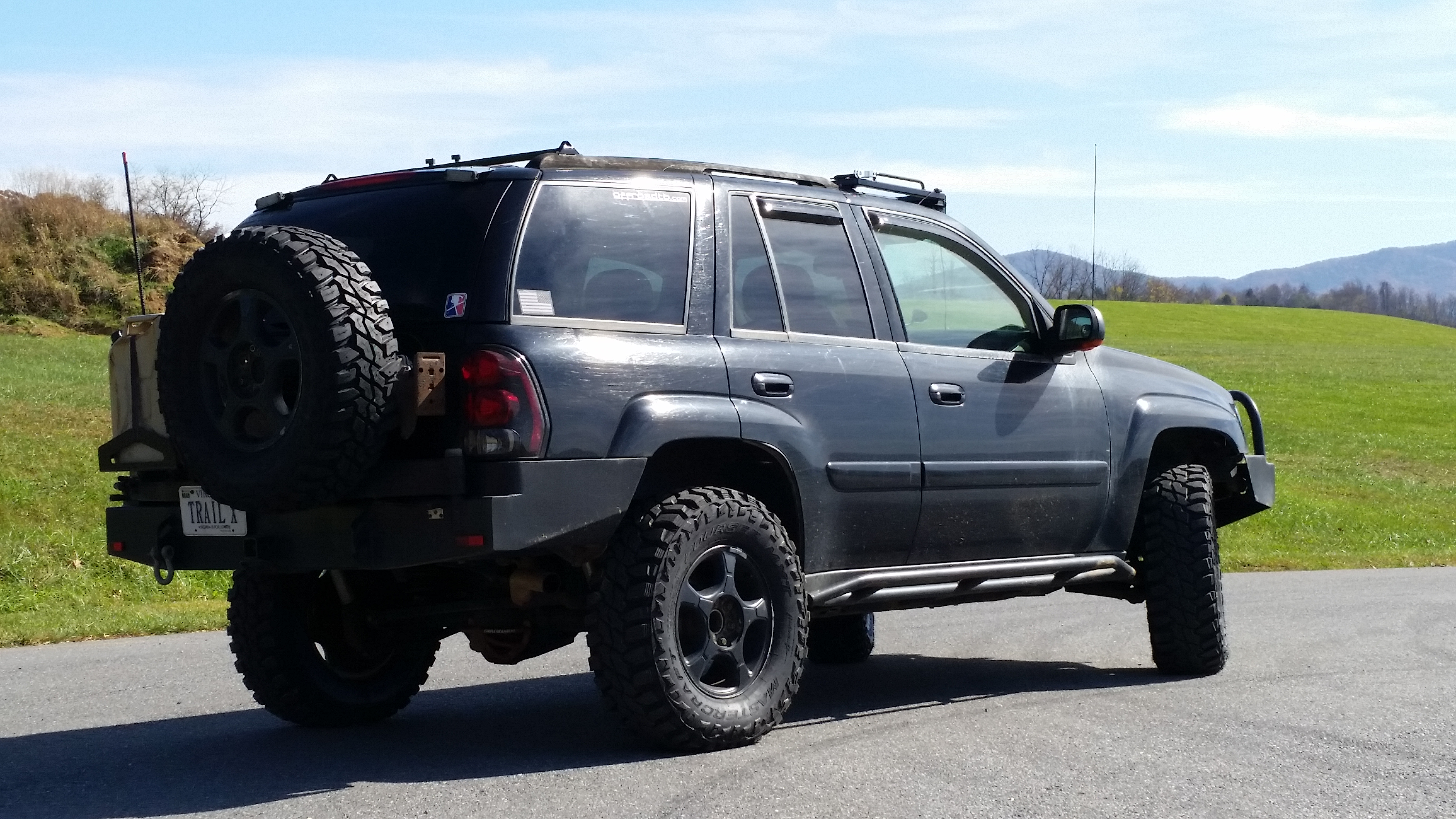

Upgraded to 33 inch tires. 285/70R17E Mastercraft MTX to be exact. I am so far very happy with how the load range E tires feel on the road. I will update this later once I've got some offroad miles on them.
I confirmed that they are infact made in USA. No rubbing lock to lock, and still no trimming has been required yet.
As I said in another thread (viewtopic.php?f=14&t=5507 this is the thread where I was trying to decide on these tires), the only negative that I've found so far is that the tires do not have the bead protector feature around the rim, but I'm not expecting that to be a huge issue.

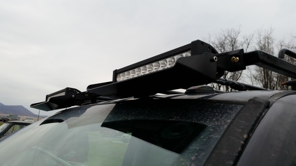

As a follow up to the prior roof rack and light bar post, I hadn't used the LED light bar much because frankly, I couldn't see a thing when I turned them on.
It was partially the fault of the Kawell LED lights, but partly my own faulty placement of the lights. The light bars really do produce a ton of light. They will be awesome on a dark road or trail, but they do put off a wide beam. Wide enough in fact to turn any piece of dust or dirt on the windshield into a glowing white dot, which made visibility quite difficult.
Luckily, due to the short length and the way they were mounted, I made up a couple of simple and adjustable visors out of 10 gauge steel that shield the windshield from the bright light. Visibility 100% improved, and makes the kawell lights very useful in the dark.
