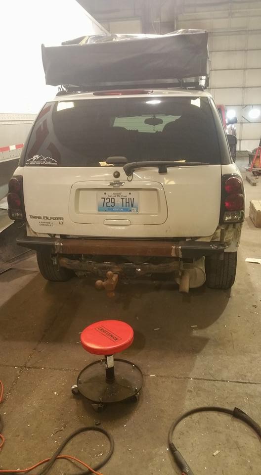

I searched around and got a rear swing for free. I built a substructure under the bumper cover and the swing went through a couple transformations before I settled.

Finally decided to do a rear bumper, dual swing arms.
