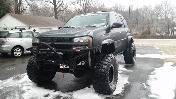

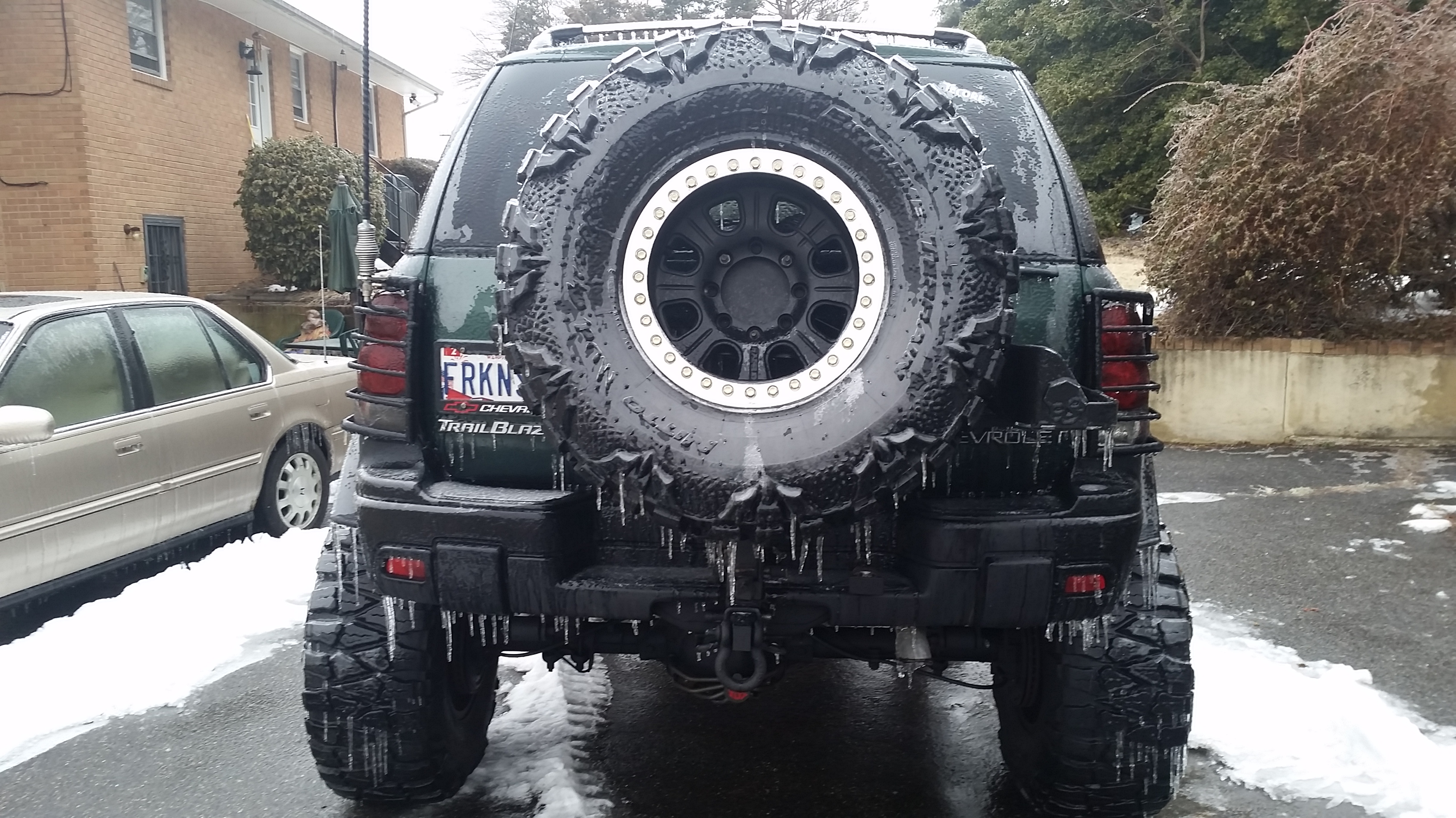

year make model: 2002 chevy trailblazer
drivetrain: 4.2 l i 6, replaced motor 5 years ago with new,used(30,000)miles /new beefed up trans ,reluctor ring for vss,transgo shift kit,corvette servo,over size trans pan, cooler ,temp sender gauge/231c tc case (manual)/tom woods drive shafts:
suspension mods:custom leaf spring lift sas/ford dana 60 front 4.88 gears/chevy 14 bolt full floater rear 4.88 gears/both detroit lockers (auto),purple cranium diff protectors/rancho shocks/PSC ps pump res and cooler/redneck ram assist 1.75/crossover steering/off road design offset draglink/lots and lots of fabricating!/37by13.5 nitto mud grapplers/17in raceline beed locks
ext mods:tube bumper with winch plate. Warn zeon winch and skid/welded reciever tire-gas can mount/flexi flares/tail light protectors/fire stick antenna/hood struts/neilageinc.com rock sliders,extended breather hose's(trans,tc/diffs)
umm...low range rock lights/oil-trans-tc-gas-pinion skids.
engine mods:
green air filter/relocated oil filter/res deleate(piped out back)/magnaflow muffler
interior mods:rear cargo shelf/various cargo nets for storing/flash light/fire ext/thule storage bags/ammo cases full of junk/tool box/cobra cb radio/on board air/cabin air filter.
recovery equip: hi lift jack/straps/tree strap/rope/shackles front and rear/plug kit(tire repair)
electrical mods: /tucked in the trailer light conn/front and back winch wiring with quick disc/sears platinum p4 battery/battery sw for winch selection/added rear cargo light/hi beam-quad light-fog light mod 2rear 100 watt backup lights with 3 way sw(on,off,backup)
Possible future mods:regear arb's
How it sits today without 3in body lift

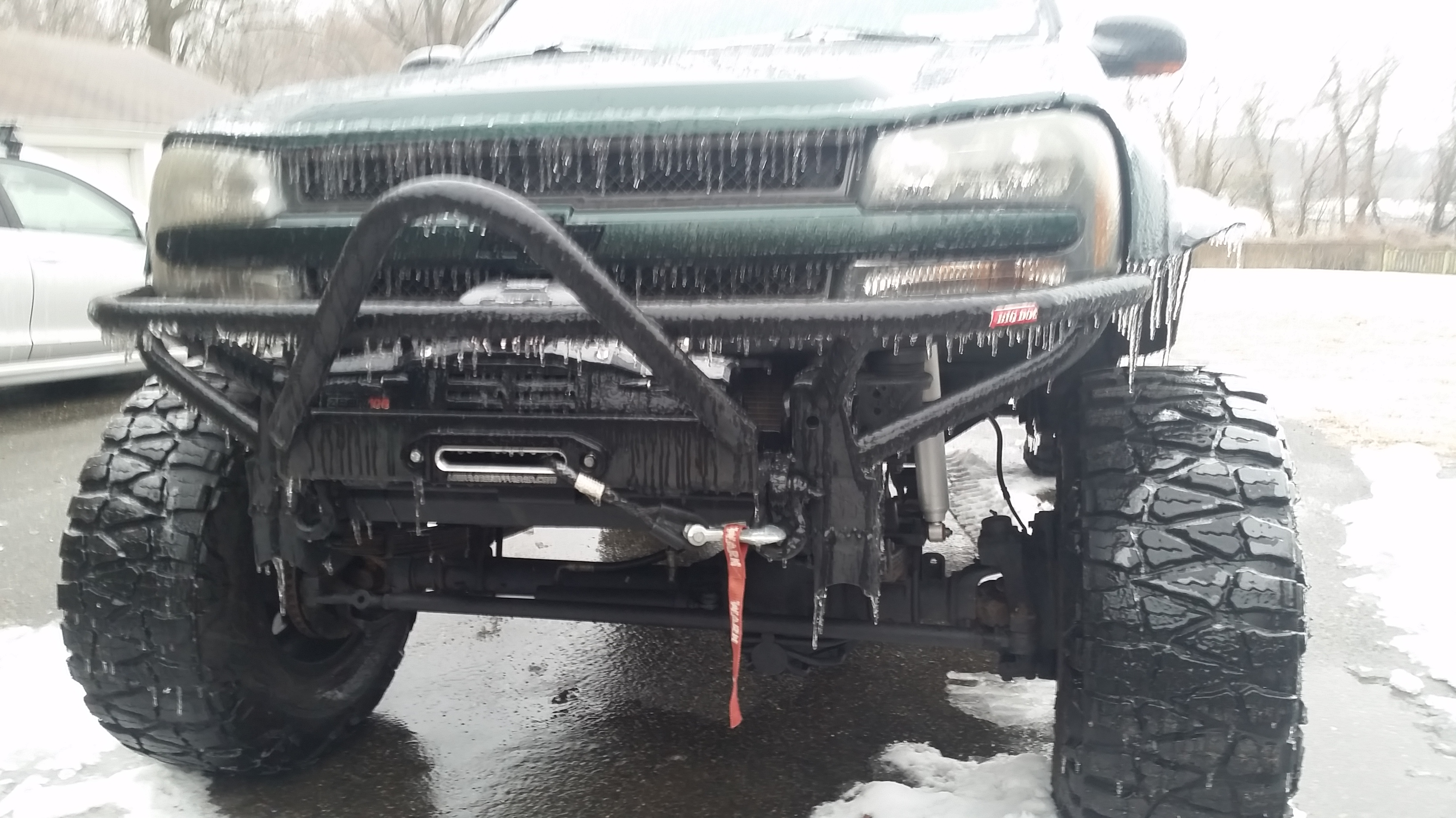

by dirty anton » Wed Dec 01, 2010 12:53 pm
bartons bumper!!!
with added lights
(13.78 KiB) Downloaded 1830 times
just put on
(11.61 KiB) Downloaded 1830 times

by dirty anton » Sat Dec 04, 2010 2:07 pm
added a stinger!! mike barton makes one heavy duty bumper!!!
(10.48 KiB) Downloaded 1767 times
