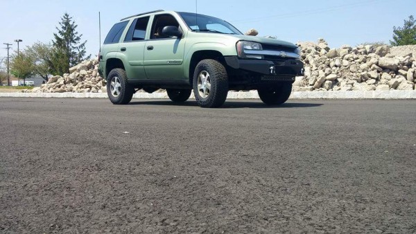

Dvanbramer88's 2002 Trailblazer LS Ballin on a Budget Build
by dvanbramer88 » Wed Sep 13, 2017 7:24 pm
2002 Chevrolet Trailblazer LS 4x4
Drivetrain Specs:
4.2L L6 Vortec 4200
-200,000 miles
Fully built 4L65E transmission
-Borg Warner High energy green clutches
-Borg Warner high energy band
-Upgraded Valves
-Transgo HD2 shift kit
-Corvette Servo
-Low stall GM92 Torque Converter (1400-1600 stall)
-B&M Trans Cooler 70268
3.42 Gears, open differentials
AWD sleeve in front Axle Disconnect
Suspension Modifications:
Front Suspension
-Liftmeister 3" Lift blocks
-Moog 81114 Springs
-Bilstien HD 24-103336 struts
-SuspensionMaxx Sway bar end links
Rear Suspension
-Skyjacker C25R springs
-Bilstien 5100 shocks BE5-6248-H5. 33-185552
-HippoSS panhard drop bracket
-Rear Sway Bar Deleted
-Spohn Performance adjustable panhard
265/75/R16 LTE Falken Wildpeak AT3W tires
Exterior Modifications:
CB antenna mount
Removed roof rack bars
Rear wiper delete
LED tag bulbs
LT black mesh grill
MDB Fabrication oil pan skid plate
MDB Fabrication Radiator skid plate
MDB fabrication Winch Bumper
Engine Modifications:
PCM performance tune
-Removed Torque Management
-Increased ignition timing
-Lowered threshold for PE
Magnaflow Stainless 14"x9" oval muffler
4" slant cut exhaust tip
Resonator Delete
Interior Modifications:
Removed Rear Headrests
Recovery Equipment:
3/4" Shackles
30' Static tow strap (x2)
20' 3/4" Kinetic recovery rope
8' Tree Saver Strap (Also used as a Bridal strap)
Jumper cables
5# Fire Extinguisher
D-handle Shovel
Smittybilt X2O 10,000# winch with synthetic rope (98510)
Electrical Modifications:
Viar 300P compressor
LED interior light conversion
Cobra 29 WX NW ST CB radio
Quad high beam modification
Future Modifications
Fabricated adjustable rear control arms
Rock sliders
Gears

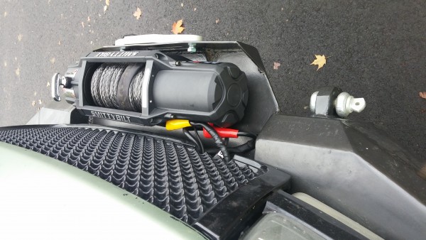

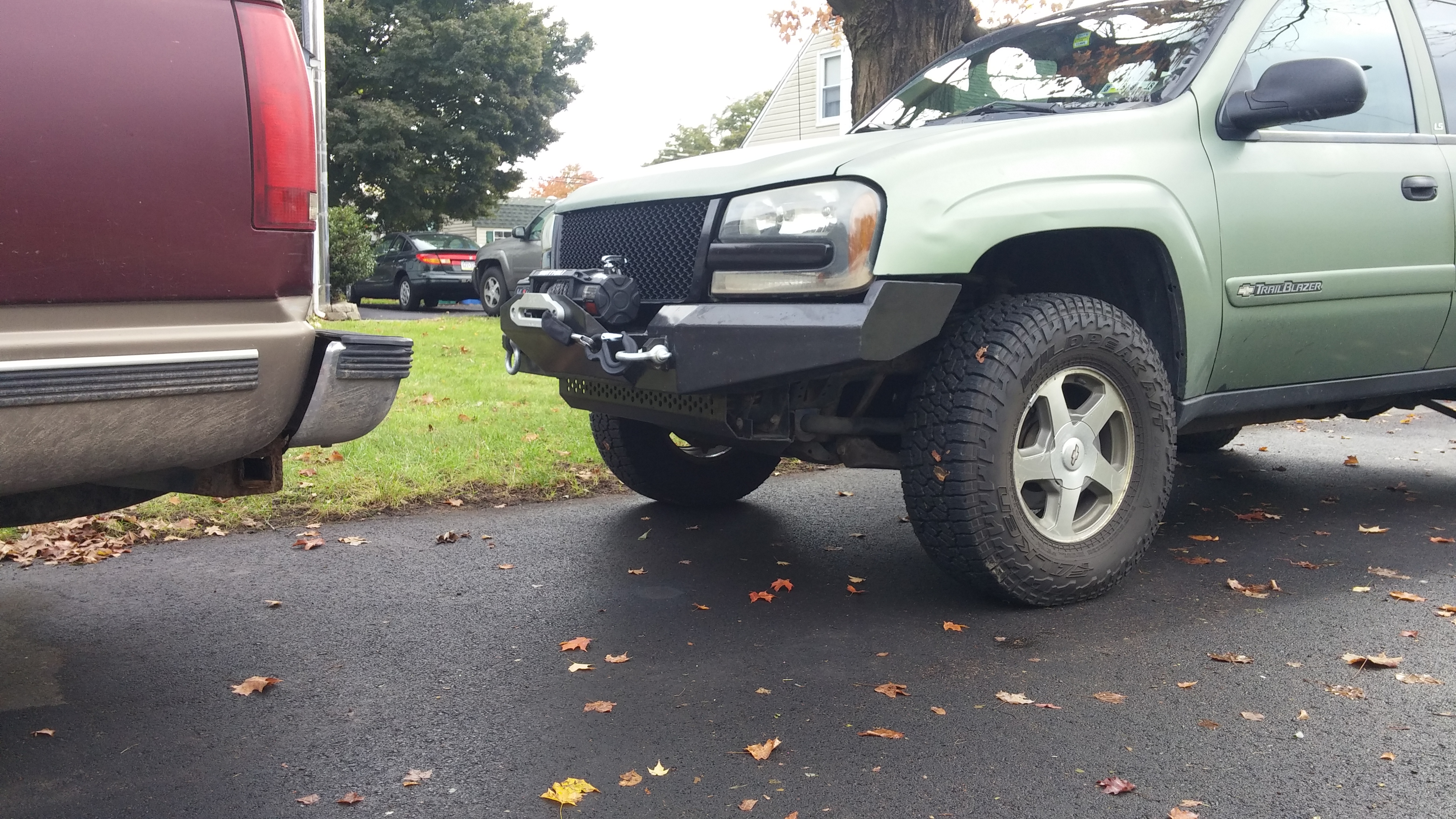

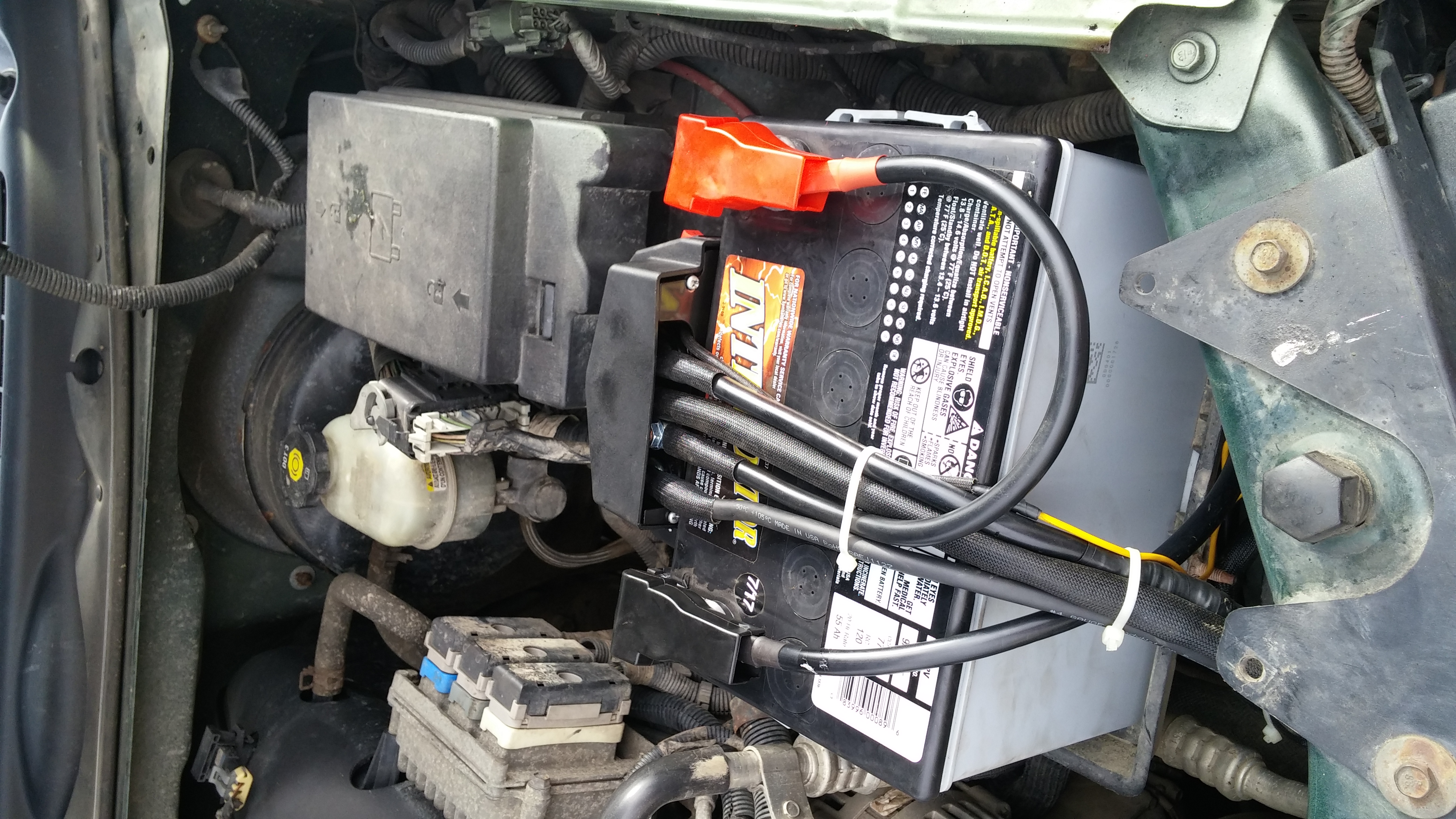

by dvanbramer88 » Sun Nov 05, 2017 4:50 pm
Winch pictures. Remote mounted the solenoid pack for a clean look.

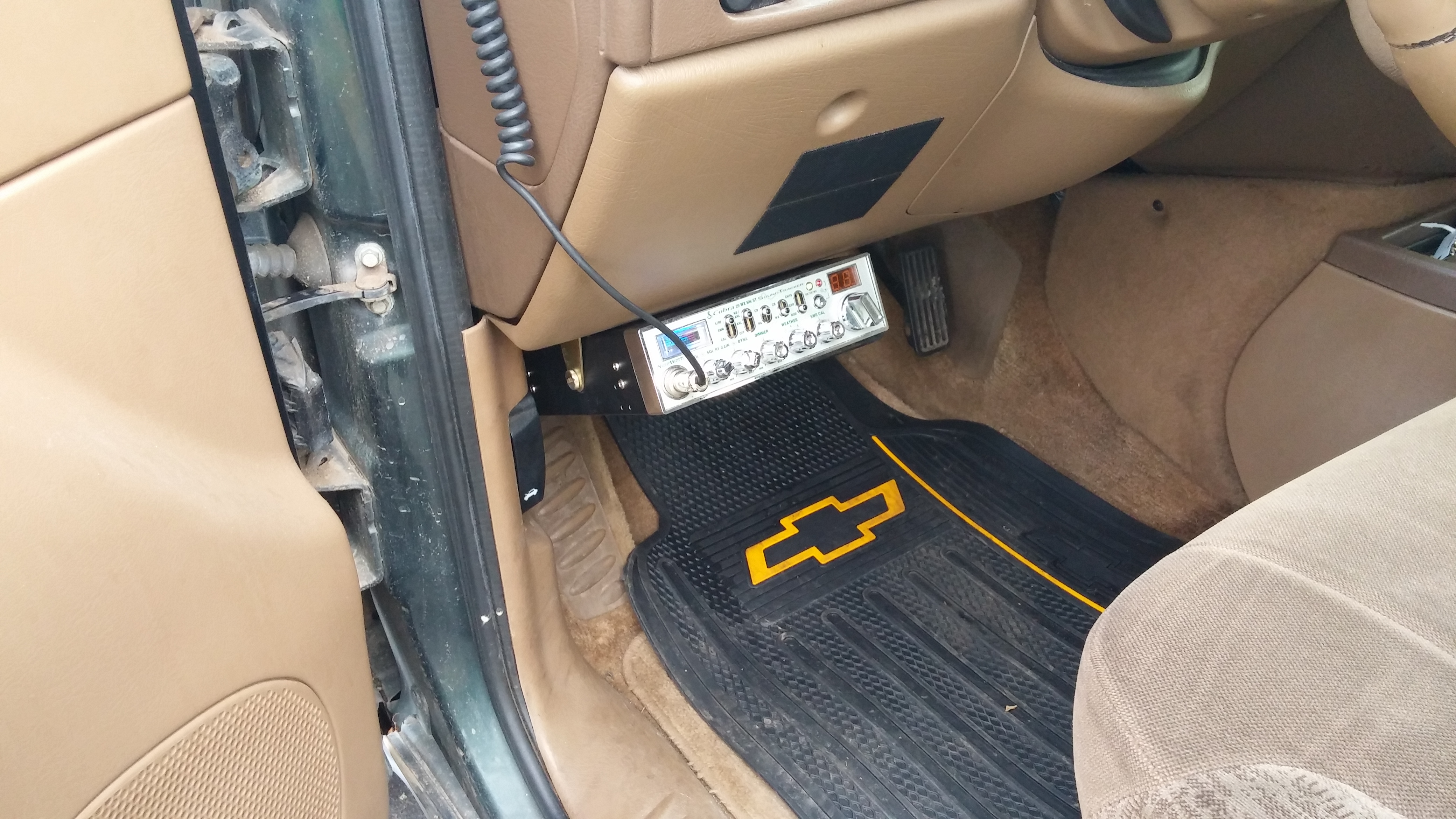

CB pictures.

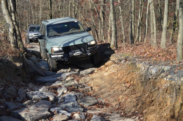

by dvanbramer88 » Sun Nov 12, 2017 4:14 pm
Rausch Creek 2017
