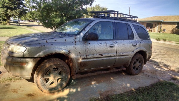

Where it all began: A shiny, unmolested Bravada, or so I thought...
In this pic, you can clearly see there is a discrepancy with the rear end. Also, the front diff is dry and there's no front prop shaft. :roll:
I started by attempting to get the awd working, rebuilt the entire front end, including new bearings and seals for the front diff, which I removed from below in three separate pieces. What can I say? I usually end up doing things the hard way. I also purchased a new propshaft and installed it.
No go. Nothing but a faint whirring noise from the front. Upon further investigation, I found an intermediate shaft with stripped splines and an AWD sleeve in the "disconnect" to match.
After replacing the "disconnect" with a new unit, and replacing the intermediate shaft, I had functional AWD! :woot:
It worked well in mud, but come first winter here in Lubbock, we literally had sheets of ice on the roadway. Since the rears have to spin a little before the fronts kick in, we had a few nervous scares on the crowned roadway with other vehicles. Because of this, I decided the AWD had to go.
Then I looked into what it would take to convert a Bravada to selectable 4wd, and quickly decided against it. :lol:

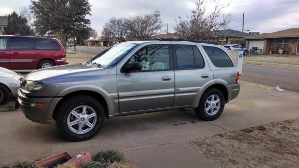

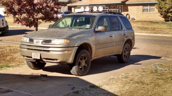

Instead of tackling that project, I added a set of four Hella 500s to the roof, installed my lift, and added the roof basket.
They provided quite a bit of light, but more is better right? At that point, I traded out the regular H3s for 100 watt H3s.
They provided ample light, but it was yellow, and, well, just look at them... :puker:
So, since I'm a redneck and I don't have a ton of money, I logged onto Amazon and got busy checking out LEDs and reviews. I settled on two wide beam 24 watt pods and two spot beam 24 watt pods. I mounted these kinda screwed off but bear with me. My two wide beam pods were mounted to the INSIDE of my light bar, and my two spots, I mounted on the OUTSIDE of my bar. With the wide beams pointed towards the barditches and my two spots basically pointed directly forward over each seat, I had wonderful spread that gave me ample vision at night from telephone poles to telephone poles. As you might imagine, this gave me a bit of a dark spot in the center. To rectify this, I installed a 7" spot beam pod.
Before:
After:
These were taken with my cell phone, so naturally, they aren't great, but you can see the vast difference between headlights only and the addition of the roof lights.

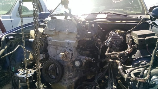

After weighing some options, we decided to replace the engine. I found a Ranier in the junkyard that had front-end damage, but it was clean inside and out, had "Scoggin Dickey Service Center" decals on the windows and a few custom goodies so I figured it was well taken care of. We got a plan together and one Saturday morning, my father and I hit the junkyard early. Ten hours later, the fruits of our labor were revealed.
Yes, that's the serpentine belt lifting that engine. Like I said, redneck. :mrgreen:

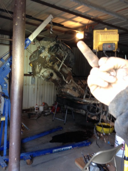

So began one of the longest months of my life working until dark after work on this d@#$ed truck!
Yeah, that pretty much sums up jerking engine and tranny from a GMT360.
