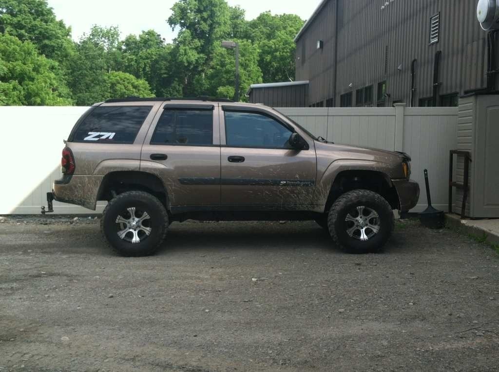

Bc-Chevy's build 2003 trailblazer ls 4wd
Drivetrain specs:
3.42 open rears
Suspension specs:
Marks three inch lift
Flipped control arms
88 springs front
Z71 rear springs
Blistein hd struts
Fox rear shocks

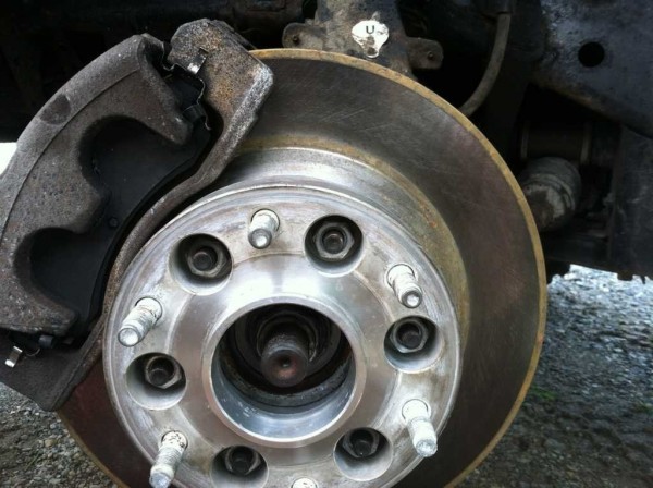

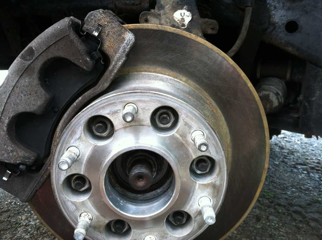

Marks wheel adapters

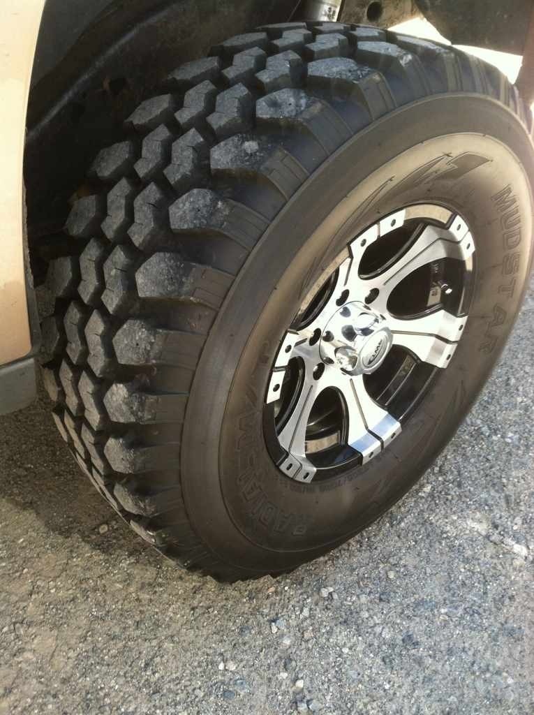

16x8 alum 4" backspace
Lt305/70r16 mud-star

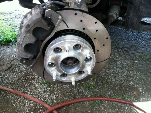

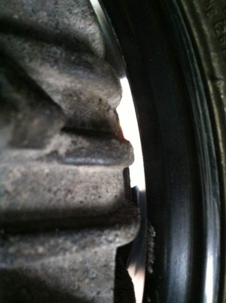

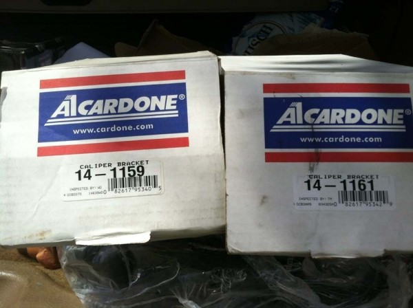

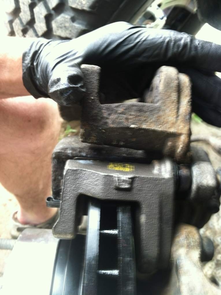

Ext front brake conversion(rotors and caliper bridges)...rim size does matter...
