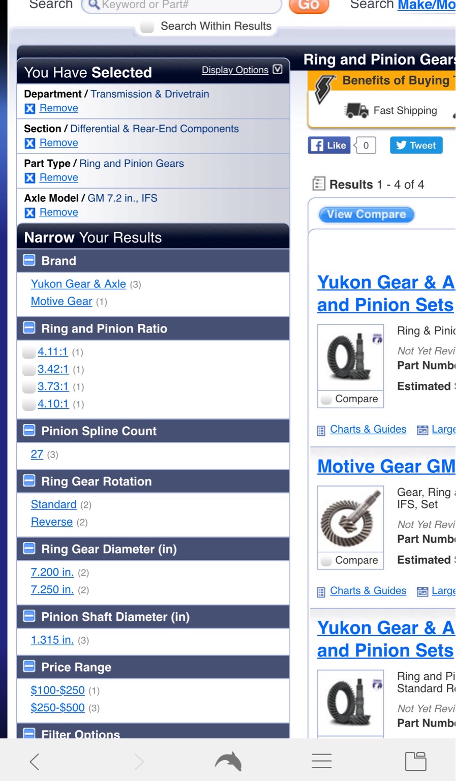

I completely missed this for some reason haha... I did just check it out briefly and saw they sell 3.90 rear and front diff gears. Found that pretty weird. Does that sound right?

I'll find the link for it. I actually searched the wrong site at first, but while searching found that they make 3.90 and 4.30 ring and pinon gears for the front and back diffs..
Do you think if would be beneficial to change the front hubs. I know for a fact that they've never been changed and I'm at 160k

by Rickalicka18 » Fri Feb 19, 2016 5:11 pm

i would check your data a site deals with this kind of stuff like summit racing. I would trust catparts.com, summit should have better prices.
beside our front diffs is 7.2" ring gear and the rear is either 8.0" or 8.6" Not 8.5" like every gm 1500

Interesting... So you're saying that the 3.90 and 4.30 gears are for a gm 1500?

by TBYODA » Fri Feb 19, 2016 7:15 pm
the gating factor is the front 7.2" ifs diff.

Those are for the rear, which doesn't surprise me since the same ring gear was used in alot of car's, and people race car's, so they may need silly in between ratio's.
I just meant factory ratios, a 3.90 or a 4.30 aren't ratio's you would see in a modern Chevy product going back my lifetime.
by Rickalicka18 » Fri Feb 19, 2016 9:00 pm
I know what you mean. They don't have those ratios for the front diff though

Rickalicka18 wrote:I know what you mean. They don't have those ratios for the front diff though
Precisely, because it was never a factory ratio, and because we only share a front diff with S10's, and no one cares about S10's lol.
