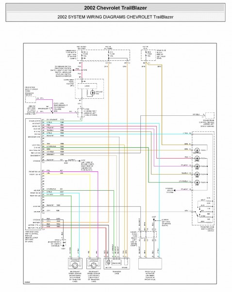

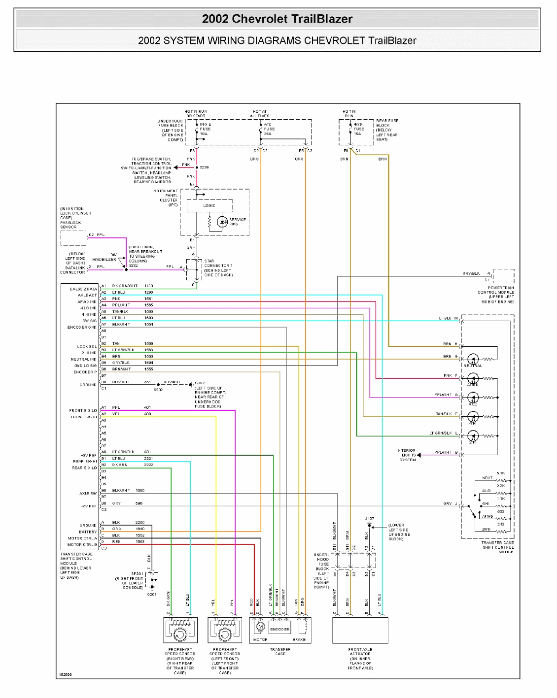

Lol, no, all you need is the transfer case with encoder motor, transfer case control module and pigtails, the wiring harness to the transfer case, and the selector switch from a 4wd trailblazer.
A little time, some wiring, and some patience will get you what you want in no time!
I also used this diagram to tell me what goes where. I know, I know, it looks daunting, and it certainly can be. My advice is to pay attention to the plug and pin designators between the diagram and your wire colors. I think some of the wire colors changed between years too.

And yes it IS as simple as bolting it in and wiring it up.
