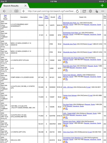

by TBYODA » Mon Oct 13, 2014 7:49 pm
tsmith1156 wrote:
Moots1288 wrote:And 4.10s are easy, you can find a rear and front with 4.10s
Sent from my SPH-L720 using Tapatalk
I have found the ring and pinion on jegs but I am having a hard time finding whole axles
Car-part.com
AXLE

by TBYODA » Mon Oct 13, 2014 7:55 pm
tsmith1156 wrote:
TBYODA wrote:
tsmith1156 wrote:[quote="Moots1288"]And 4.10s are easy, you can find a rear and front with 4.10s
Car-part.com
AXLE
It said invalid[/quote]
Try again I edit it

by tsmith1156 » Mon Oct 13, 2014 7:55 pm
I did find some on ebay
tsmith1156
Posts: 222
Location: Batavia, Ohio
by TBYODA » Mon Oct 13, 2014 7:58 pm
