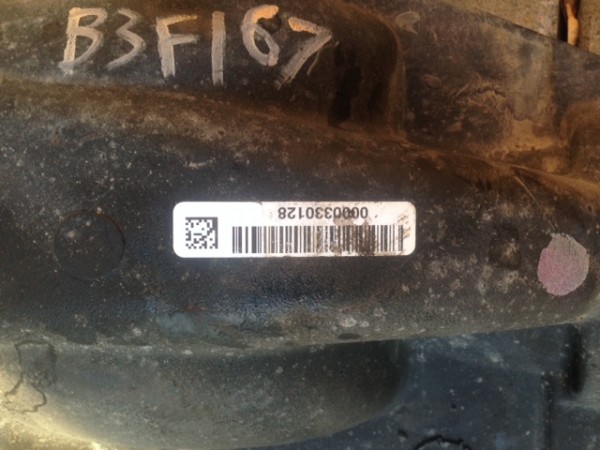

Would also be nice to get some side pictures of the carrier with some measurements from the drive shaft side to back cover, side to side. Maybe we could convince Erik or Kyle to craw under there TB and take some measurement. Because if this information is in fact true that Saab 4.2l had a 8.6 axle that open's up bunch of options because I have seen a lot of then. Razor what motor did the VIN say it had?

I thought my build thread mentioned the difference in measurements from my need for shortened driveshaft, but once it is warm I can measure whatever.

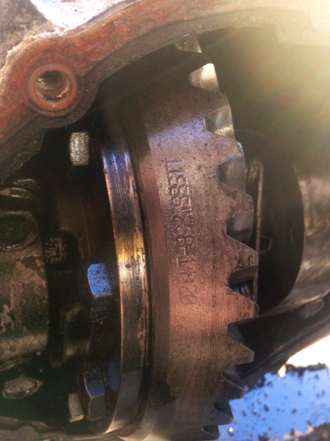

by JustliketheRazor » Tue Jan 21, 2014 4:01 pm
Some additional pictures....at work at the fire dept right now, major overtime :D so if you any requests for better pics I will get some when I get home in a couple days.

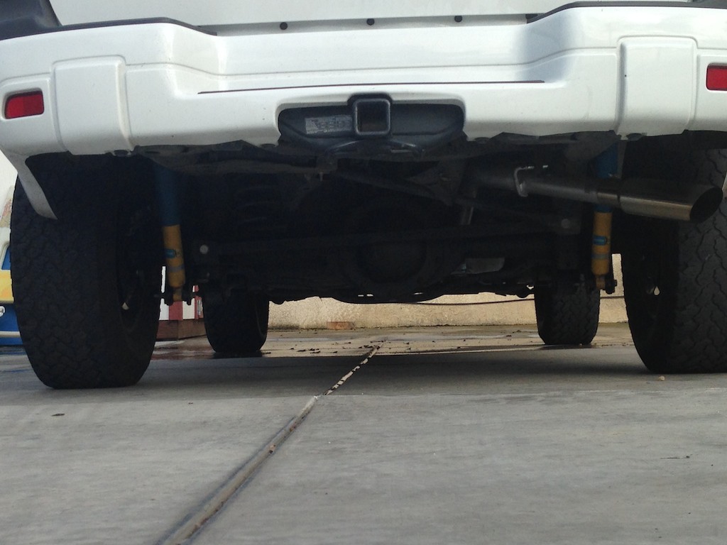

by JustliketheRazor » Fri Feb 14, 2014 1:08 am
Just an update...
Got the axle rebuilt, changed bearings, seals, brake plates, parking brake hardware, cleaned and inspected diff carrier, cleaned housing, sanded and painted axle, and swapped axles.
Was a perfect fit and runs flawlessly :D
I neglected the diff cover though, PML makes a cover for this differential on the GMT360. So I'll be ordering that next overtime paycheck :D
