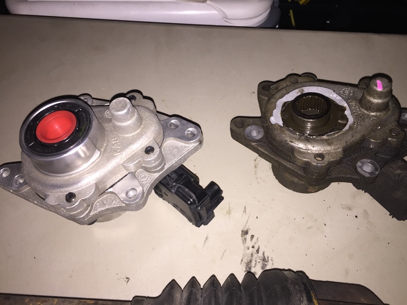

This happened to me tonight, I don't think my prybar has landed yet. I thought it was bad when one of the actuator bolts broke....My handgun money is going to a new disconnect assy.

I'm just going to throw this out there so people stop breaking $500 housings. To rebuild the splined disconnector with the least amount of risk, Leave the inner housing on the truck. You won't be able to replace the inner most bearing or inner oil seal, but that should be fine in most situations. WE just rebuilt Josh's disco with the help of MDB. Remove the module. Remove all the bolts from the housing and separate the halves. Leaving the inner housing on the truck and removing the CV and Outer housing as a whole. Put the outer housing in a bench vise by the stronger "bell shaped" section and use a large drift pin to remove the CV. Replace the outer and middle bearings and the outer oil seal. Re-grease like JD's thread shows and put the outer housing back on the truck. Re-install CV. Use a pry bar or large screw driver to put pressure on the inner most tri-pot of the CV, Strike with large hammer and the clip will pop in surprisingly easy.
fresh off the truck. The condition of the grease and the rust on the end of the CV indicates water got into the housing.
Notice inner housing on the truck. I just pulled the gear and washer off, degreased, re-greased inner housing and gear/washer and put them back.
cleaned up outer housing.
If anyone wants more details, just ask

The four wheel drive stopped working. The diagnoses flow chart pointed to disconector. We rebuilt it half to fix it and half maintenance. The outer bearing was dust and the middle was pretty bad and rusted too. It needed to be done. Also, the grease was hard and chunky.
The large aluminum "drum" piece that goes against the disconector on the CV. There are those small ridges on the 3 "sides" of it. You can get a flat blade to catch the ridge and tap with a hammer. I spent an hour beating the end of the CV and nothing was working. My neighbor suggested using a screw driver against that ridge and it popped right in second hit.
http://www.cardone.com/Imagesftp/60/601345-01.jpg
The middle image of the CV, see the ridges on the aluminum piece?
The 4 nubs are ground down. They still caught the thrust washer a little bit. We confirmed the four wheel drive to be functioning properly and to be reliable since then. I'll worry about it when it needs to be worried about. In the mean time, I'm keeping my eyes peeled for a TB in the junk yard and hoping to score a good housing/fork/gears for spares.
