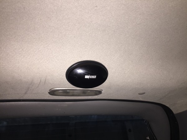

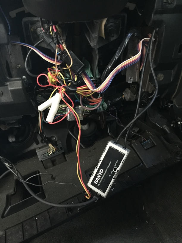

Tearing apart while PCM is in NC getting tuned. Here are some pics, the previous owner had an entertainment console as I see holes left in head panel.
Under Dash, I am guessing this FM modulator controls this wireless thing in back.
Wireless thing in back:

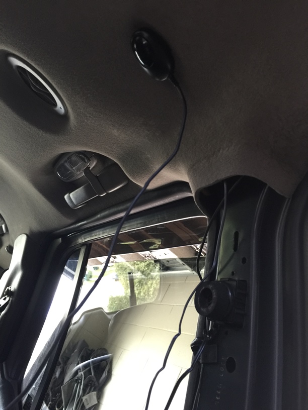

Also, I have this speaker and wireless thingy on driver pillar. It used to give a tone like power on but no connection. Is it a cell phone thing? I just realized I have not heard the speaker humm in a while. hhhmmmm
Any ideas are great!! Posting this just made me think about that speaker on pillar....

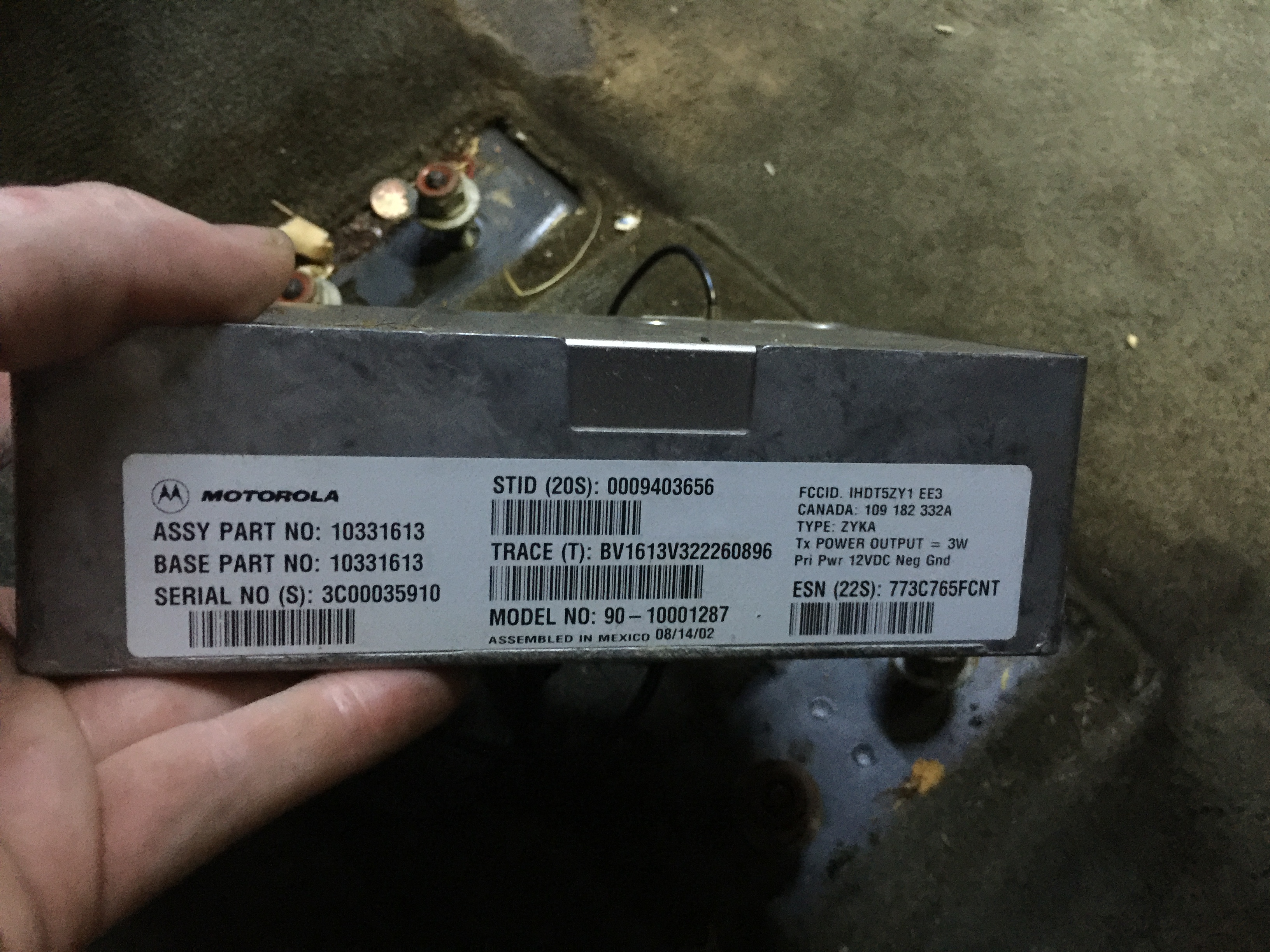

What the heck is this thing?
Under passenger rear seat.
2003 GMC Envoy XL SLT 4x4
bljis123
Posts: 111
Location: Jacksonville, FL
Vehicle: GMC Envoy XL
by mason10198 » Thu Dec 01, 2016 11:09 am
bljis123 wrote:What the heck is this thing?
Should be your Onstar box from GM, has all the GPS and other sensors in it.

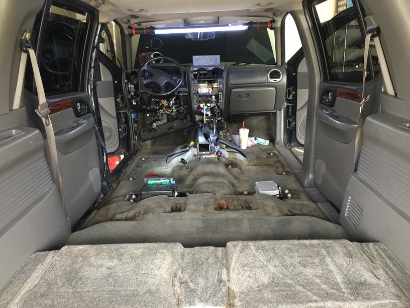

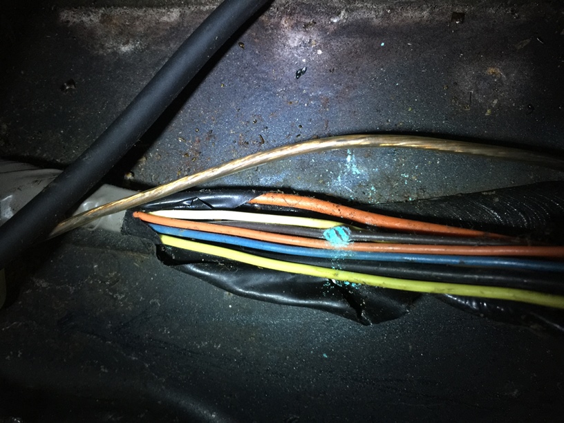

by bljis123 » Thu Dec 01, 2016 9:55 pm
Finally, I found it!!! Funny thing I tore the whole insides out just to find under kick panel trim on driver side. :facepalm:
Tore all out though unnecessary:
Corrossion on wire and metal area where it was grounding for awhile:
