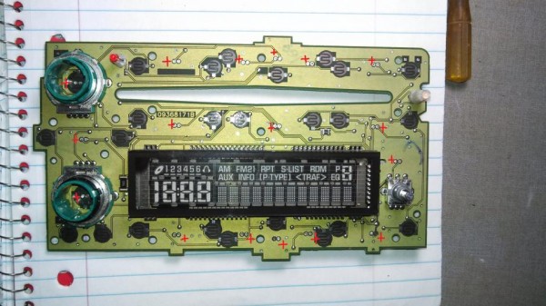

Can't find any diagram for the radio lights :( everything else is done

by Midnyteryder196 » Mon Feb 29, 2016 8:09 pm
pretty sure i have been the only one to do polarity of the 6 disk changer.. all info in my build thread on gmtnation.. i will include diagram that has been confirmed by another member.

by Lil Papa » Tue Mar 01, 2016 1:08 am
Thanks Midnyteryder196! Much in the clutch.. Thought I was going to have to follow the pins.. What a pain in the ass that would have been!

Can't get any lights to come on.. Have tried everything.. Any suggestions?

by Lil Papa » Sat Mar 12, 2016 5:28 pm
Done! After hours of troubleshooting I decided to just switch all the LEDs around. And it worked!.. On the Bose radios all the positives on that diagram above are backwards.. What a pain in the ass!!!
