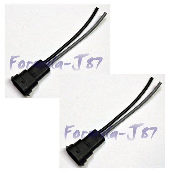

I thought I would share this on here. The factory fog lights can easily be modified to reuse the factory waterproof plugs for aftermarket lights. I started with a factory fog light bulb, clipped the actual bulb off of the connector, soldered the wire leads from my LED fog lights, and put some shrink tube on it. A dab of silicone around the end of the shrink tube and you've got a pretty watertight factory connection for your aftermarket lights!

Thats a hell of an idea! although they do make regular connectors too.. i just bought some for my new bumper lights on ebay.. 7.50 for the 2..
