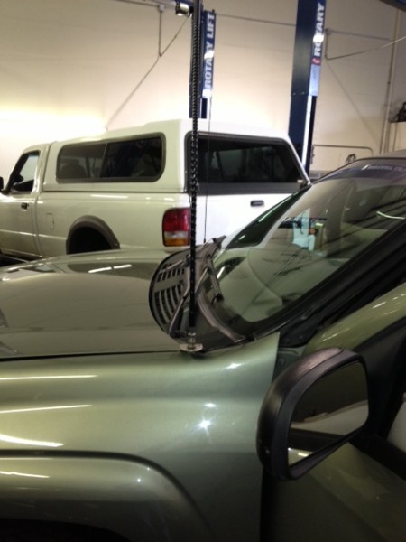

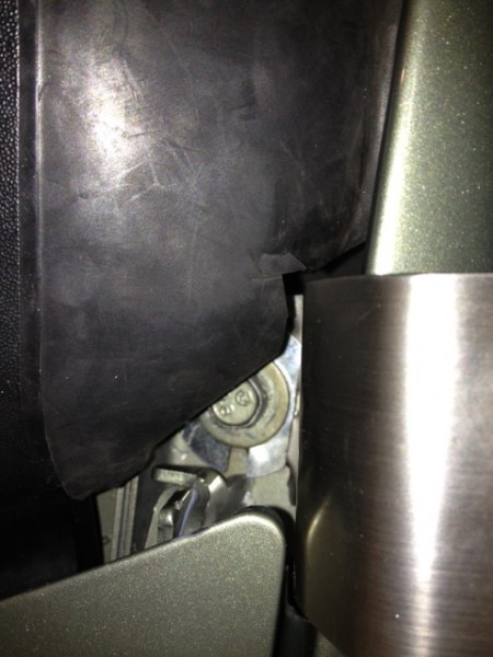

So here is a Fire Stick I mounted today. Running the coax thru the firewall turned out to be tuff but it is well sealed. I do notice a little hum above 30 mph so I am thinking it is wind noise from the stick? Anyway, sorry the pics arent the best but I am happy with the outcome so far.

Put a spring on that or you will end up with a divot in the fender underneath. Ask me how I know.

OK, so spring first then tune?

by fishsticks » Sun Dec 30, 2012 12:52 am
Yep. I used a "medium" spring. It deflects a little at highway speeds but is fine other than that.

Fishsticks, I went with the HD spring and it also deflects a little but seems to be working.

I had to use a heavy duty spring with my 4 foot firestik on the rear.
