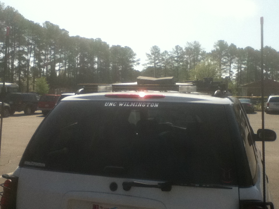

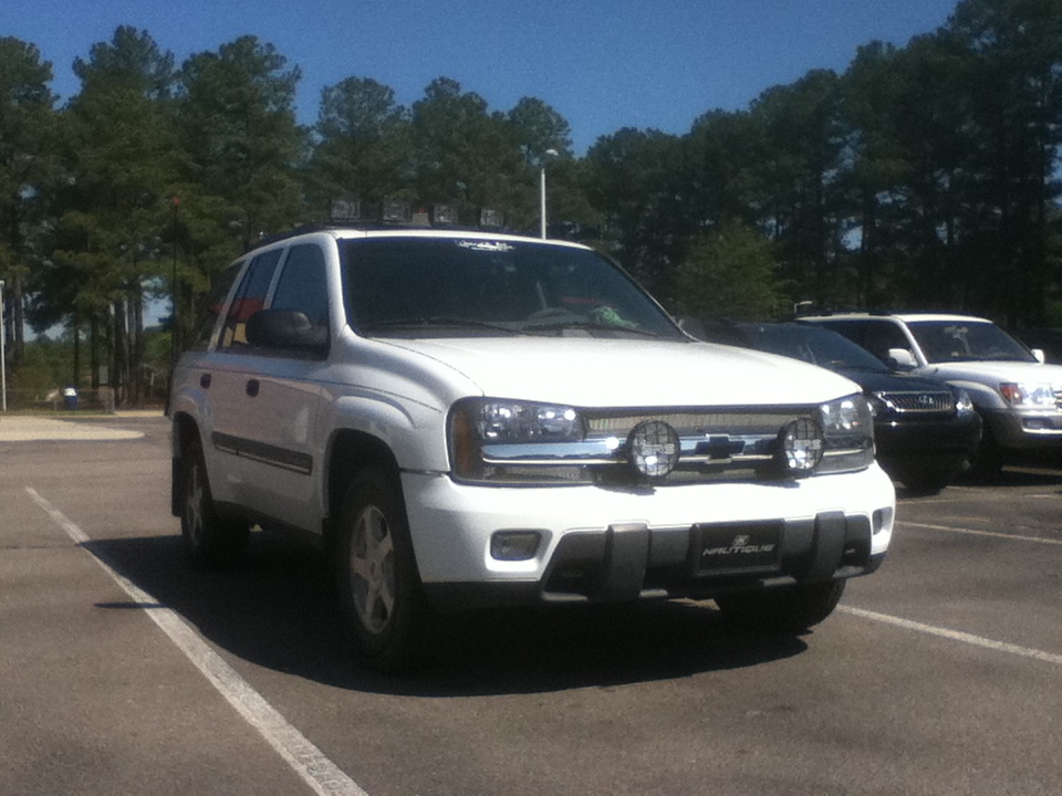

by TSAdventurez » Mon Mar 26, 2012 1:03 pm
Here are my current setups front and rear might help you get some ideas. I dont currently have any lights on the sides.what are yall's setups for side lighting?

by galacticfuzz » Tue Mar 27, 2012 12:02 pm
Curious, did you mount the lights to the stock bumper or did you do it a different way?

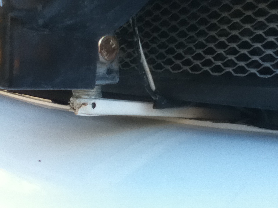

by TSAdventurez » Tue Mar 27, 2012 12:55 pm
They are mounted on square tubing attached to the bumper cover bolts. that passes through between the bumper and grill

by galacticfuzz » Tue Mar 27, 2012 4:25 pm
That's clever... I just finished making a bracket and bar system using those same bolts. Simple yet effective on your part. Once my lights come in tomorrow and I have them on the bar and it's all finished up I'll take some pics and post them.

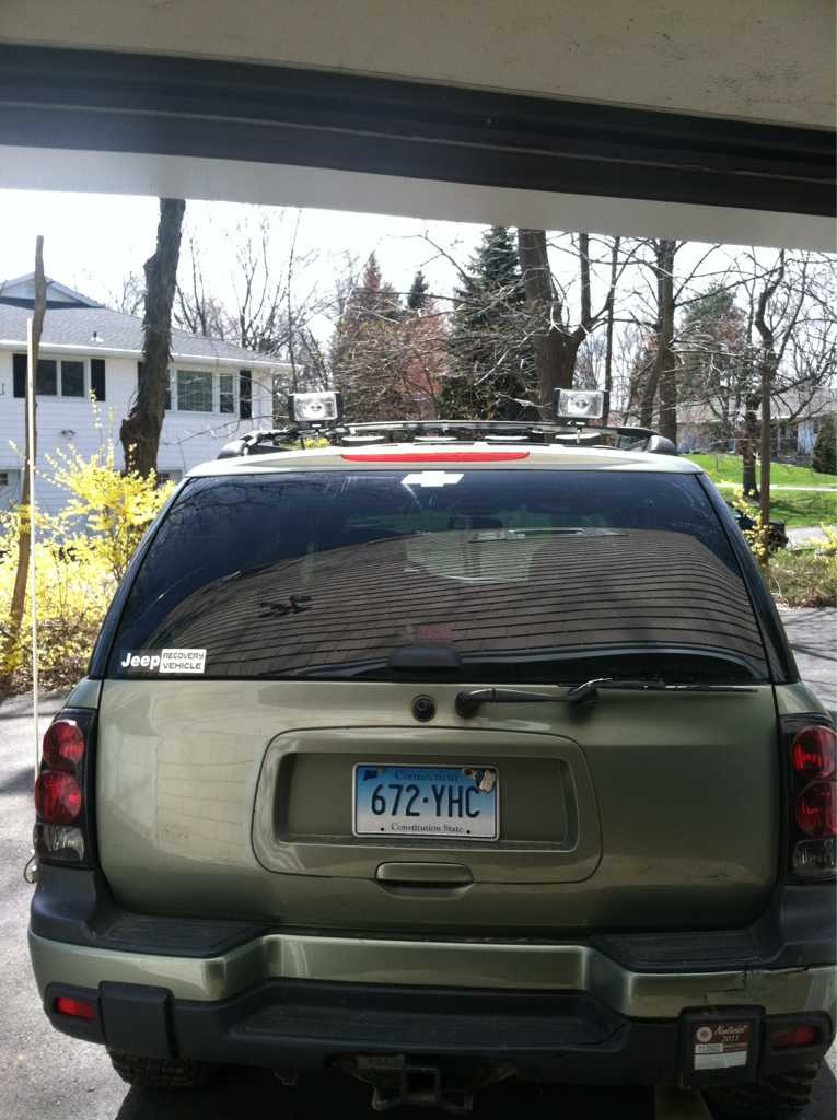

by steveroche » Tue Mar 27, 2012 4:36 pm
Mounted my lights up on the roof. Just went straight through the stock crossbar until I get a roof rack and I attach it to there. The light pattern is really bright. It's like having my brights on but for the back of the truck. It's just hooked right up to a toggle switch at the front of the truck next to all my other switches. Simple yet affective.
