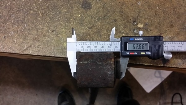

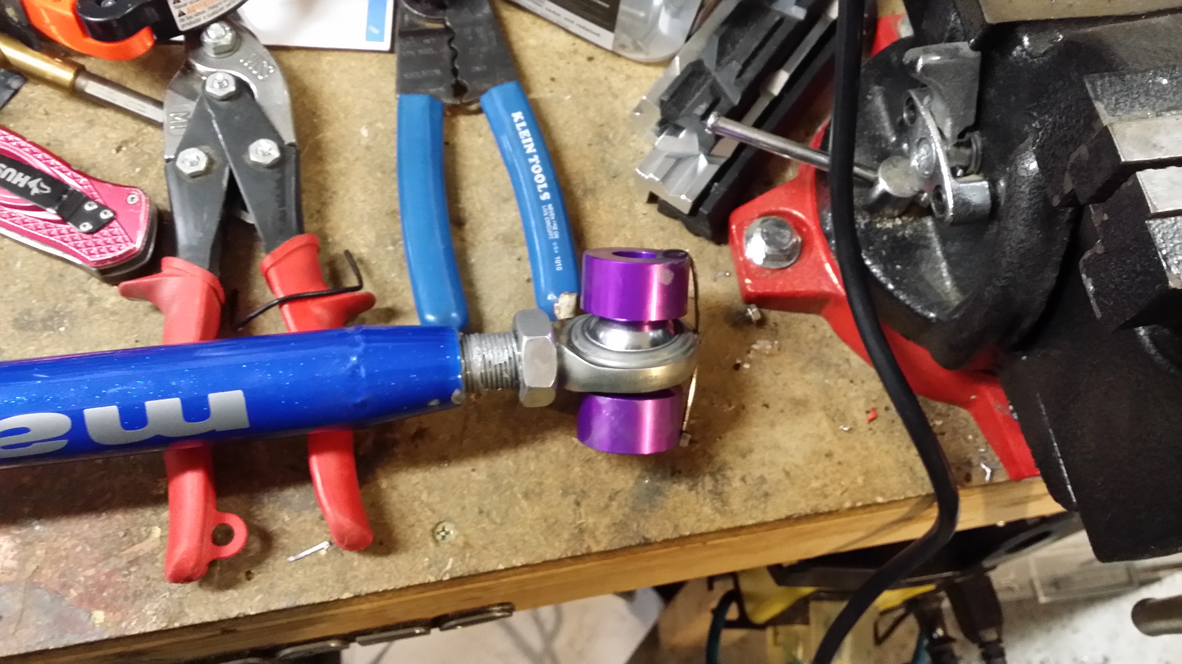

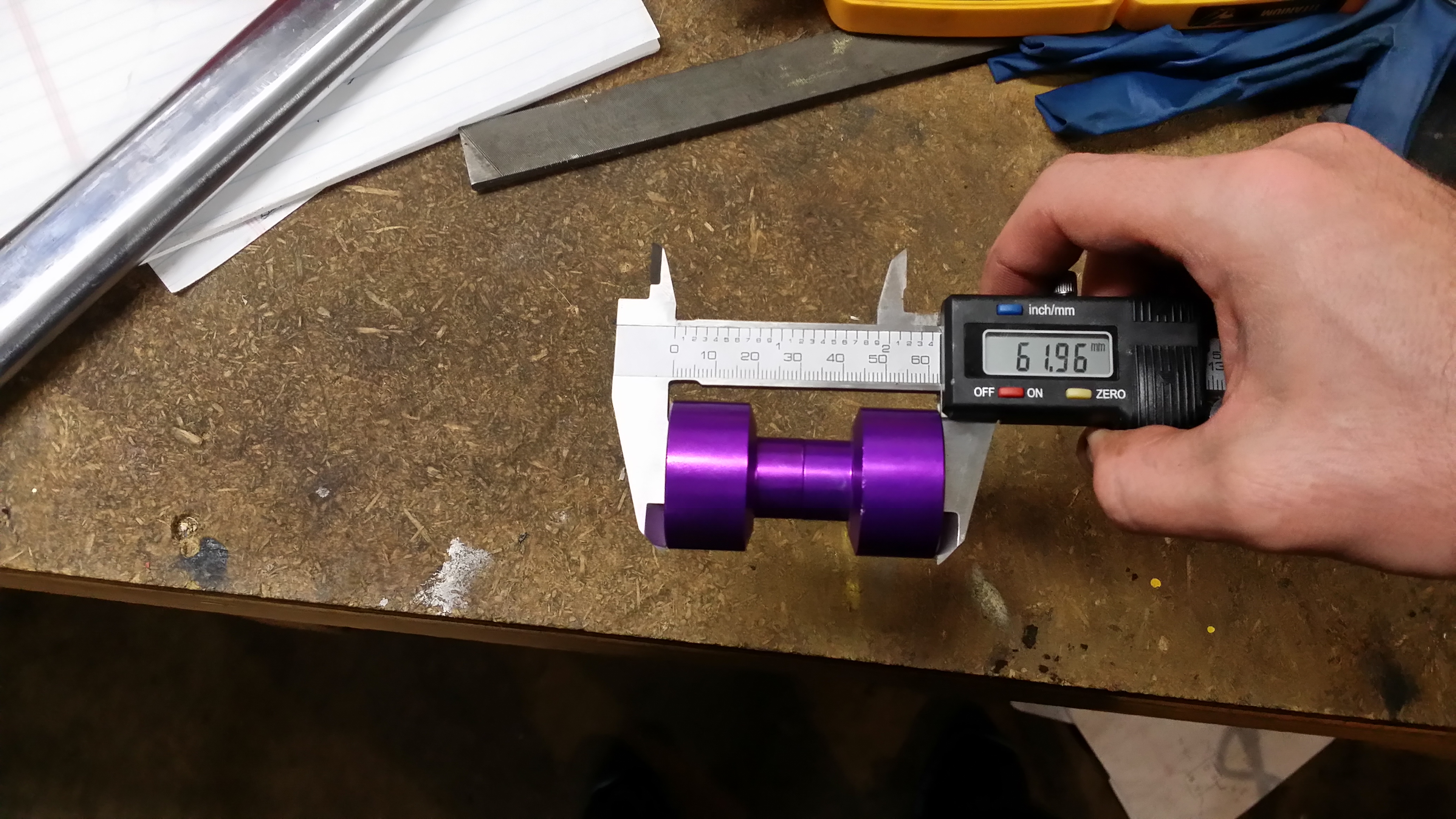

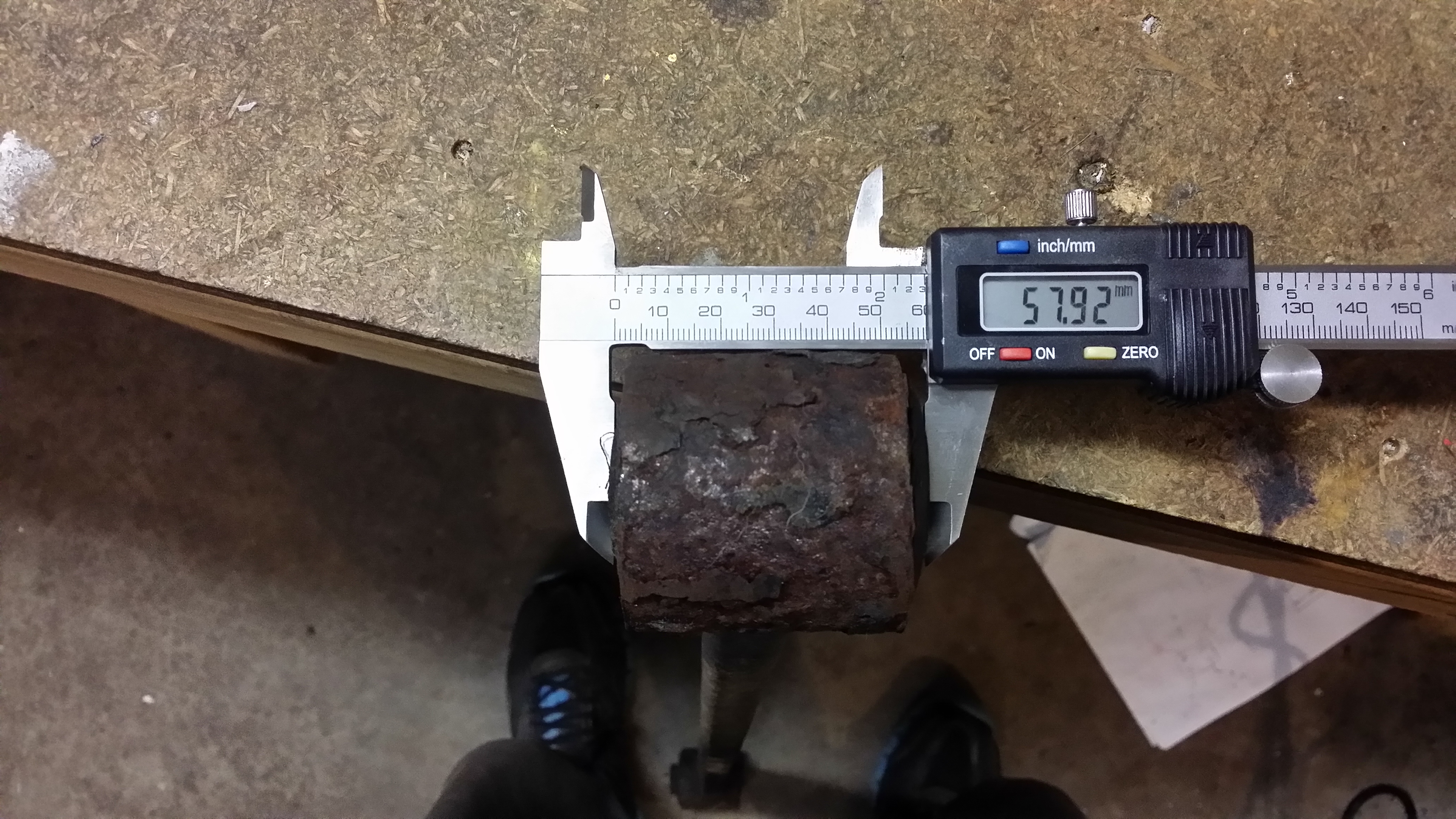

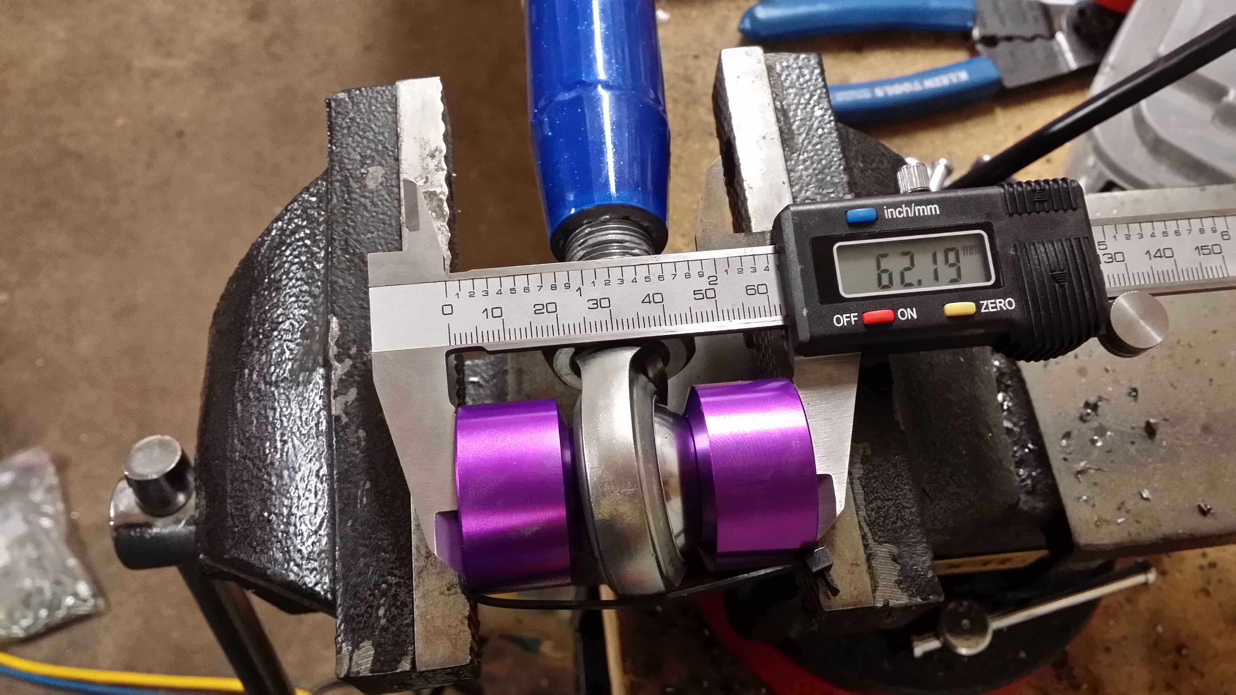

Now that I have started to work on my build, there are some concerns with the Massive pan hard bar that I purchased a few months back for my '02 Trailblazer. First, the neoprene boots that everyone else received with their purchase, said to be standard now, was not standard with my purchase. Second, both sets of the included aluminum bushings are at a minimum of 4 mm too big for my passenger side mount/bracket. It will work fine for the driver's side as that bracket is bigger and so is the original sleeve bushing that is in the OEM pan hard bar. Finally, there is no compressing these solid aluminum bushings any further than they will butt together. See pics below
No neoprene boots.
Measured at the ends of the sleeve bushing mounted in the passenger's side of the OEM pan hard bar.
Driver's side of OEM pan hard bar.
Loose Massive bushings, compressed with hand strength.
The other Massive bushings, still zip tied in place but compressed by my vice with as much torque as I could crank down on it.
