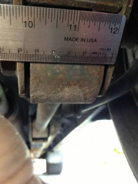

by Sugar16 » Wed Aug 14, 2013 7:17 am
Measured mine this morning before work
Sugar16
Posts: 113
Location: OH, Canton
by Cable810 » Wed Aug 14, 2013 11:08 am
.07mm Difference between 04 and 05 interesting. Wondering if there is a difference between them all? I could be wrong but its just a hunch. Seeing that I have an 04 XUV rear axle I'd safely guess I'd be at 58.08 according to what Sugar posted. Now we need to measure the Pre 04' control arms.

by TBYODA » Wed Aug 14, 2013 4:19 pm
Here is off my 08 on the axle, did not have a vernier handy to measure but looks very close to the others above.
