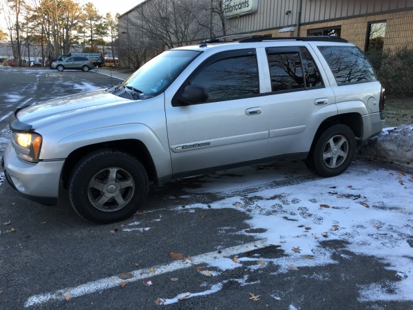

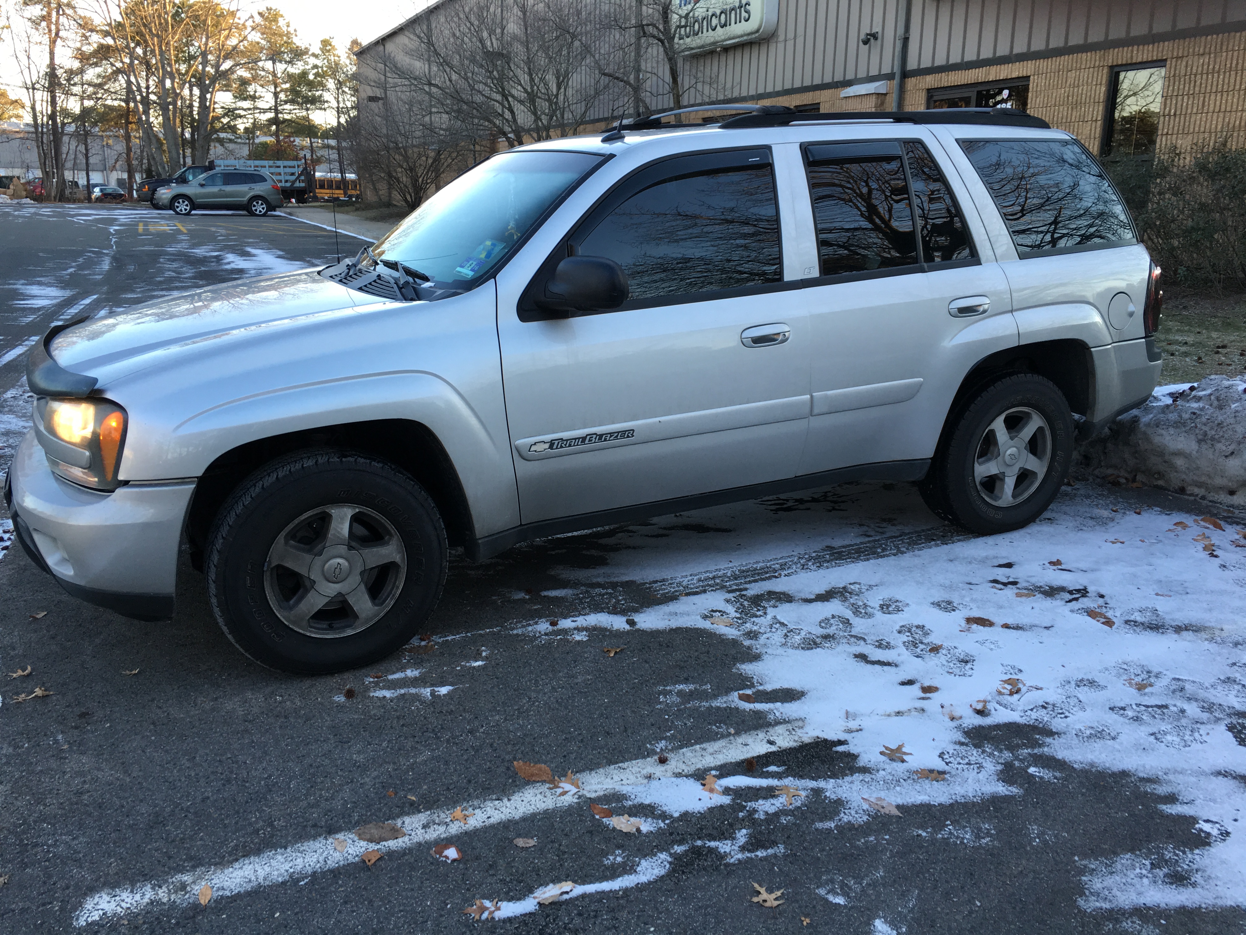

by ice79 » Tue Feb 23, 2016 11:42 am
2004 TB 4x4 this is before LIFT... its raining today so wont be done today
