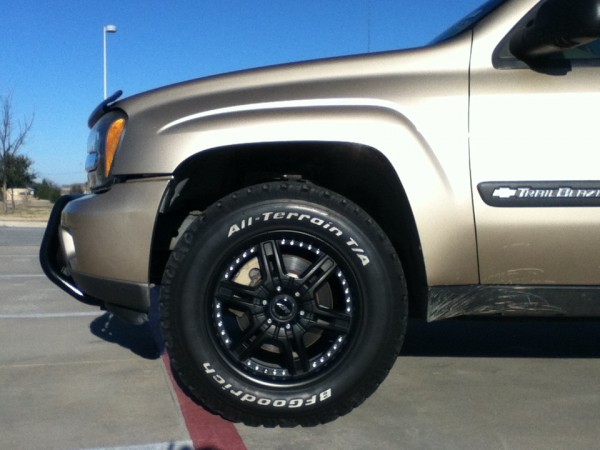

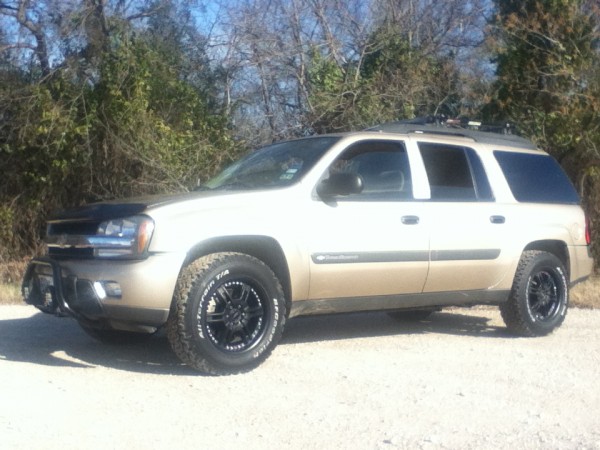

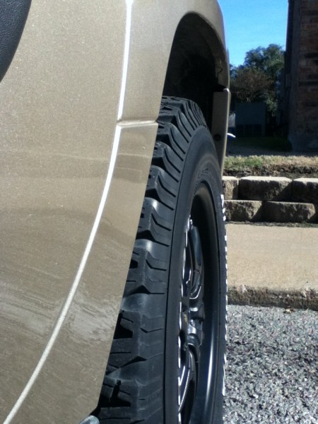

by kcb58h » Sun Feb 01, 2015 10:15 pm
Goldilocks
2004 TB LS EXT 2wd
Modifications made in 2010:
2" R/C leveling kit
265/65/18 BFG A/T KOs on A/R Marin wheels - NO SPACERS
KYBs f/r
Stock '83 springs f/r
Only modification to bodywork was removing 6" or so of front wheel well liner.
Spacerless
2" R/C lift spacer * stock '83 spring * 31.6" tire * no wheel spacer
Gold "Brick"

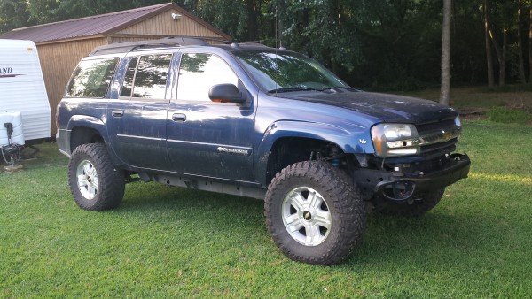

by escapepilot » Tue Jun 02, 2015 2:25 pm
Mark's 3" Suspension and 3" Body lift
Toyo 35x12.50x18
Silverado Wheels
and a little bit of trimming!

escapepilot, what gears does your EXT have?

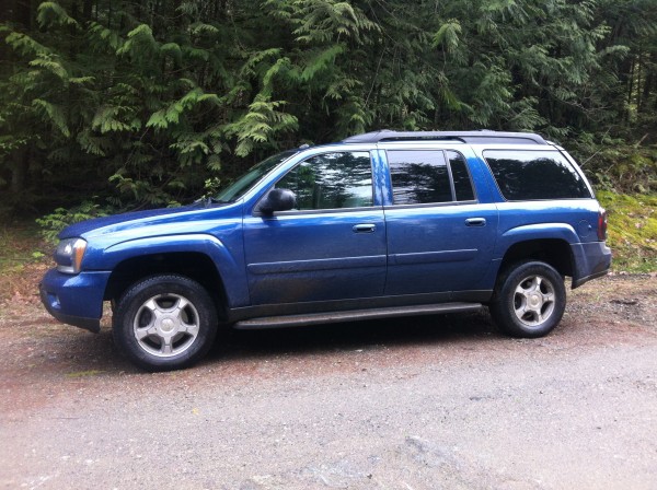

My '05 EXT
Mark's 2.5" lift/level
Z71 Tahoe rear springs
BDS 55619 rear shocks
Stock front coils & shocks
Hankook 245/65/17 HT tires on stock rims, to be upsized soon
Front airdam delete
3rd row seat delete
The day after the lift

Right now, it's still the 3.73s. It's not too bad w/ those, since I'm in flat land near the coast, but definitely getting 4.56s.

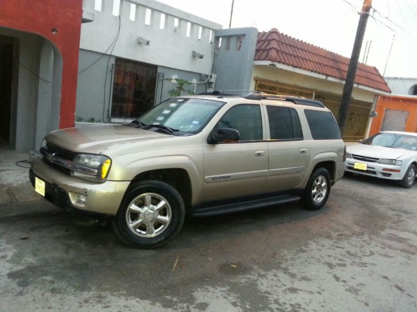

by roshirim » Thu Jul 09, 2015 6:38 pm
Im just starting.
I have 3" lift just in the front
4*4 TB ext 2004, 4.2 RIMS 17
my 2004 TB EXT 4*4 4.2 3'' lift in front
