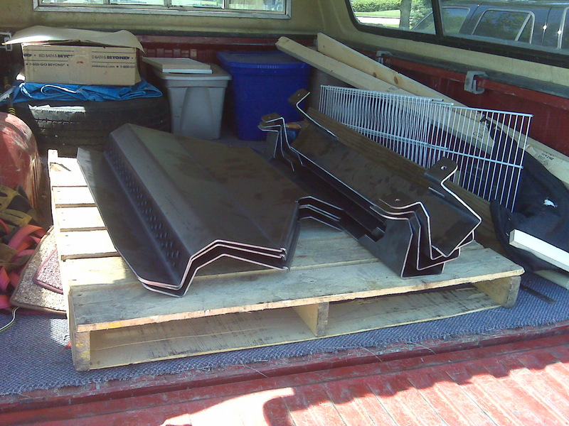

Maybe I am just ignorant on the topic, but it appears that the skid pictures are of them already on the car. I wanted to know to know what they looked like beforehand still in kit form. I know the thread said it is "extremely self-explanatory", but I can't see anything done on them. Not trying to feed the trolls, I am just curious before I spend my money on them. I figured this was the place to ask questions, tell me if I am wrong.

by dvanbramer88 » Mon Jun 10, 2013 6:55 pm
I'm assuming you get the 2 pieces shown and you weld them together, You may or may not have to drill mounting holes.
MDB would have the real answer.
Posts: 2282
by bartonmd » Mon Jun 10, 2013 9:07 pm
dvanbramer88 wrote:I'm assuming you get the 2 pieces shown and you weld them together, You may or may not have to drill mounting holes.
Correct. You take the (2) pieces, mount them separately on your TB, tack them together, pull it down, and weld it up. No holes to drill. All the holes are already in it.
