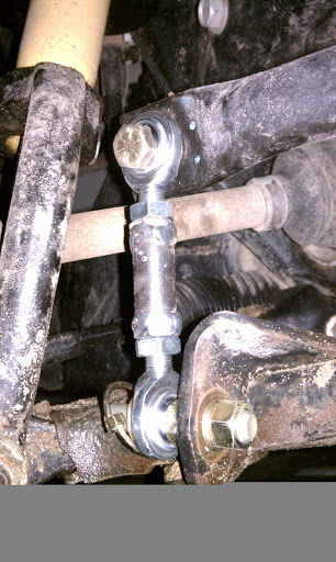

Quick disco experiment using regular rod ends (heims), and hardened pins through the non-threaded part of grade 8 bolts...
At the moment, these are beginning testing, and are still vaporware. This is NOT the kind of thing that I would sell to anybody before I (or Kyle) tested them!
If they can survive my wife... They can survive ANYTHING!
Time will tell.
ETA: you'll have to excuse the welding. Didn't bother switching from .035 to smaller wire for just these couple welds.

by bartonmd » Tue Jan 11, 2011 10:44 pm
Thanks, guys!
The tops will be like the bottoms, as far as disconnecting both top and bottom to completely take them out while off road...
Off for a test drive...

by bartonmd » Tue Jan 11, 2011 11:33 pm
Drove around for a bit, got both fronts (one at a time) up on the (pretty high) curbs at the nearby school, found some dry pavement and swerved back and forth, then put one front up on and off of this big rock by my driveway a few times...
No pops, and everything's still together...
Being that they're heims, though, it does sound like the stock ones sound when they're going bad... Just a little noisy, but you're not going to get around that with this kind of joint, really...

by bartonmd » Tue Jan 11, 2011 11:43 pm
Have another set of heims in the garage for just that!
Kyle actually fronted for them, so they're all actually his; but him being local, it was just easier for him to buy them than it was for me to buy them and then sell them to him...
Fronts are around 3/8" longer than stock (and can go up to ~1.5" longer... Longer than that if I cut the DOM longer)... Rears will be probably at least an inch longer than stock... We'll need to look at it closer...

by Trail X » Wed Jan 12, 2011 11:17 am
I assume the noise is due to the slight difference in diameter between the joint ID and the bolt OD? No real way to get around that unless you can find a poly bushing of some sort to go between the parts.
How do you disconnect the top mount? Or does it not have a pin?
Posts: 9902
by bartonmd » Wed Jan 12, 2011 11:43 am
JamesDowning wrote:I assume the noise is due to the slight difference in diameter between the joint ID and the bolt OD? No real way to get around that unless you can find a poly bushing of some sort to go between the parts.
Yep... Just wanted to state it... Was easier to hear because I was driving on snow (low speed, no tire noise, lots of little bumps)... If the fit was any tighter, they wouldn't slide on and off... A little burr from the cut had to be taken off for them to slide on.
Post #5
The top will be like the bottom. What you see there as the bolt head will be a pin.

by Trail X » Wed Jan 12, 2011 11:48 am
Gotcha!
As for disconnects - I know the idea is not to have to use a tool. But do you think a 3rd nut, instead of a pin, would be able to get rid of the noise? That way it's just a single bolt that needs to be removed in order to disco? Just a thought.
Posts: 9902
by Gordinho80 » Wed Jan 12, 2011 11:57 am
Very nice, Mike. Should these come about, I might decide to reconnect my sway bar.
As far as the noise, I like JD's idea of using a 3rd nut. As long as you have the ability to use a wrench to hold the through bolt in place, nut wouldn't be that big a deal to remove.

by bartonmd » Wed Jan 12, 2011 12:02 pm
I had originally thought of that, but then... They would be exactly as "quick disconnect" as the stock ones that only taking (2) nuts off...
Posts: 4471
by Gordinho80 » Wed Jan 12, 2011 12:03 pm
Problem with the stocks is the fact that you have to use an allen key to prevent the through bolt from spinning. Having a hex head on the other side would help.

by Trail X » Wed Jan 12, 2011 12:06 pm
bartonmd wrote:I had originally thought of that, but then... They would be exactly as "quick disconnect" as the stock ones that only taking (2) nuts off...
My end links had to be cut off - so I'm not familliar with this quick disconnect method of the stock links.
Anyways - I see your point. Is there any way to make the stud hold to the mount, and not require a second wrench to hold it? Then it's just a single wrench that's required.
