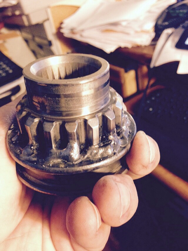

or weld the sleeve the fork sits on onto the gears.

by TBYODA » Tue Dec 02, 2014 11:35 pm
v7guy wrote:or weld the sleeve the fork sits on onto the gears.
Yea like this.
