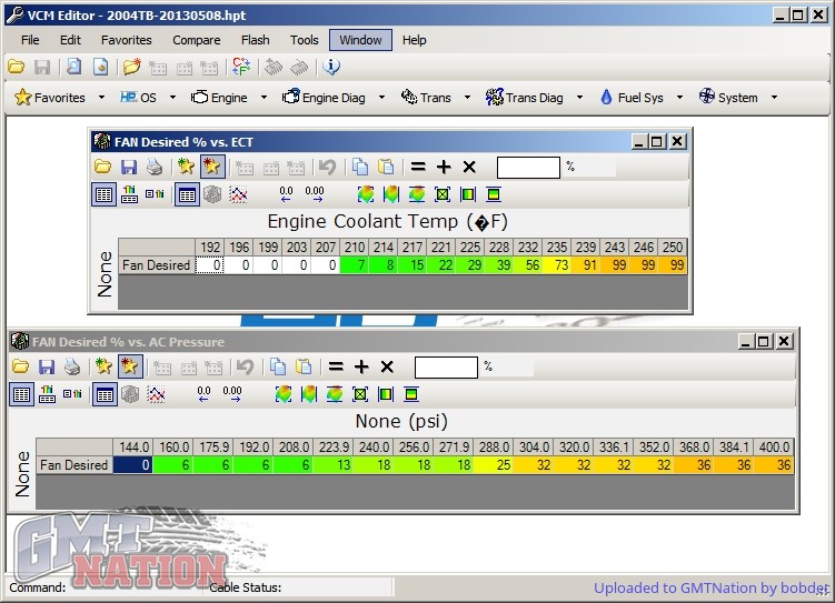

by bartonmd » Fri Aug 04, 2017 2:45 pm
No, it comes on linearly, and later than you'd think. You didn't happen to have a SES light, did you?
Have you at all recently cleaned your radiator and condenser?

by zerovandez » Sat Aug 05, 2017 2:43 am
Cool thanks, guys. I will take the cheaper route first. What program is that?
