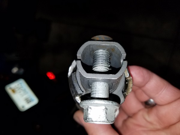

by larryk » Wed Jun 21, 2017 7:09 pm
Just confirmed, for the record, there are no splines on the steering column or rack in the engine compartment. Its a double D design, so there is no way to adjust the steering wheel by a spline.
