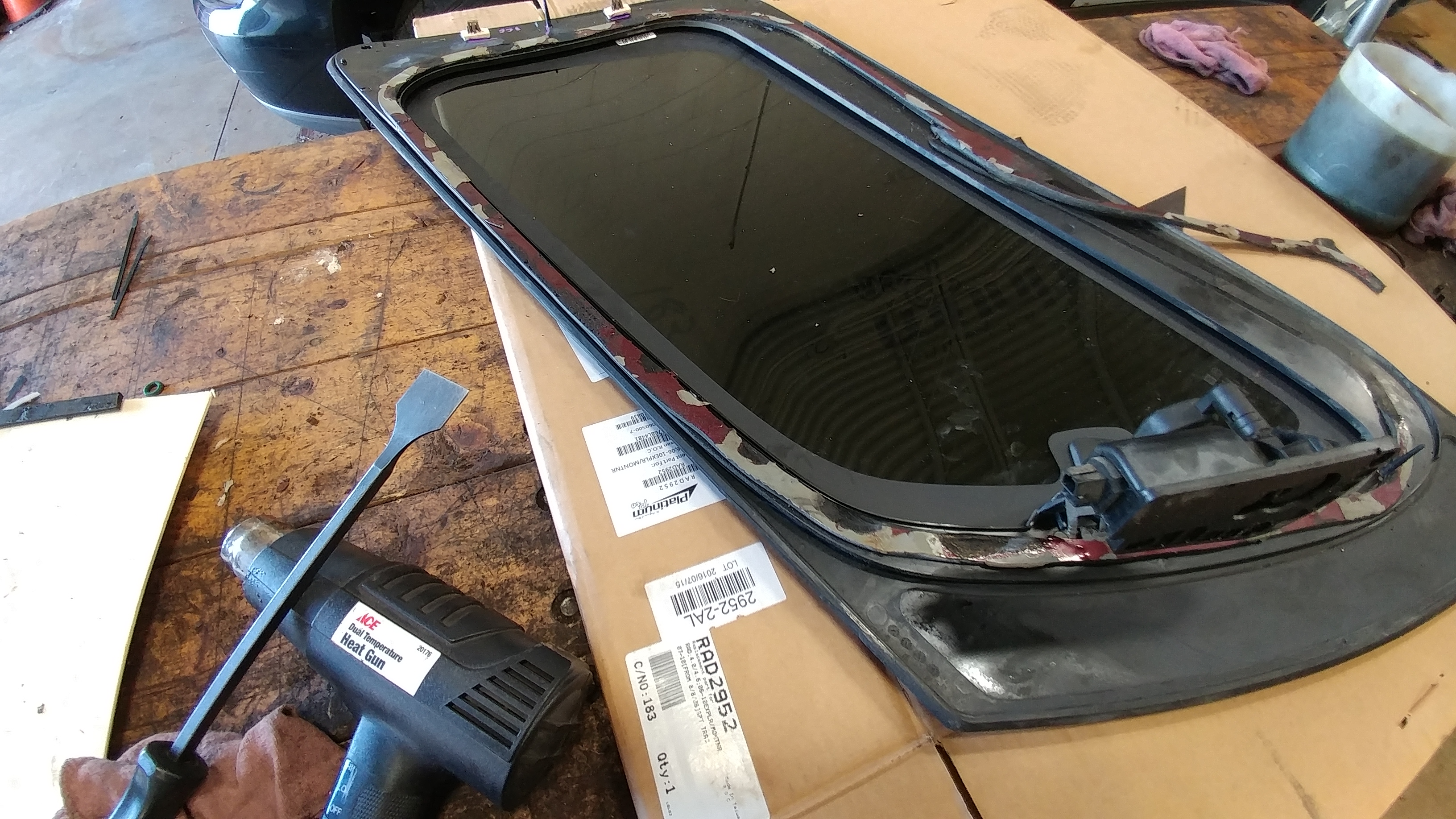

Has anyone ever changed out this window? I have searched online but have not seen anything.
Someone broke my window last night and i dont want to pay 400 bucks to have it changed out. I got a whole part from the junk yard for 50 bucks. I see the motor is anchored but i do not see how the back part is anchored. I am removing panels now and might figure it out... but just seeing if someone already had a write up.
If not i guess i will make one if all goes well.
Thanks in advance. MIke

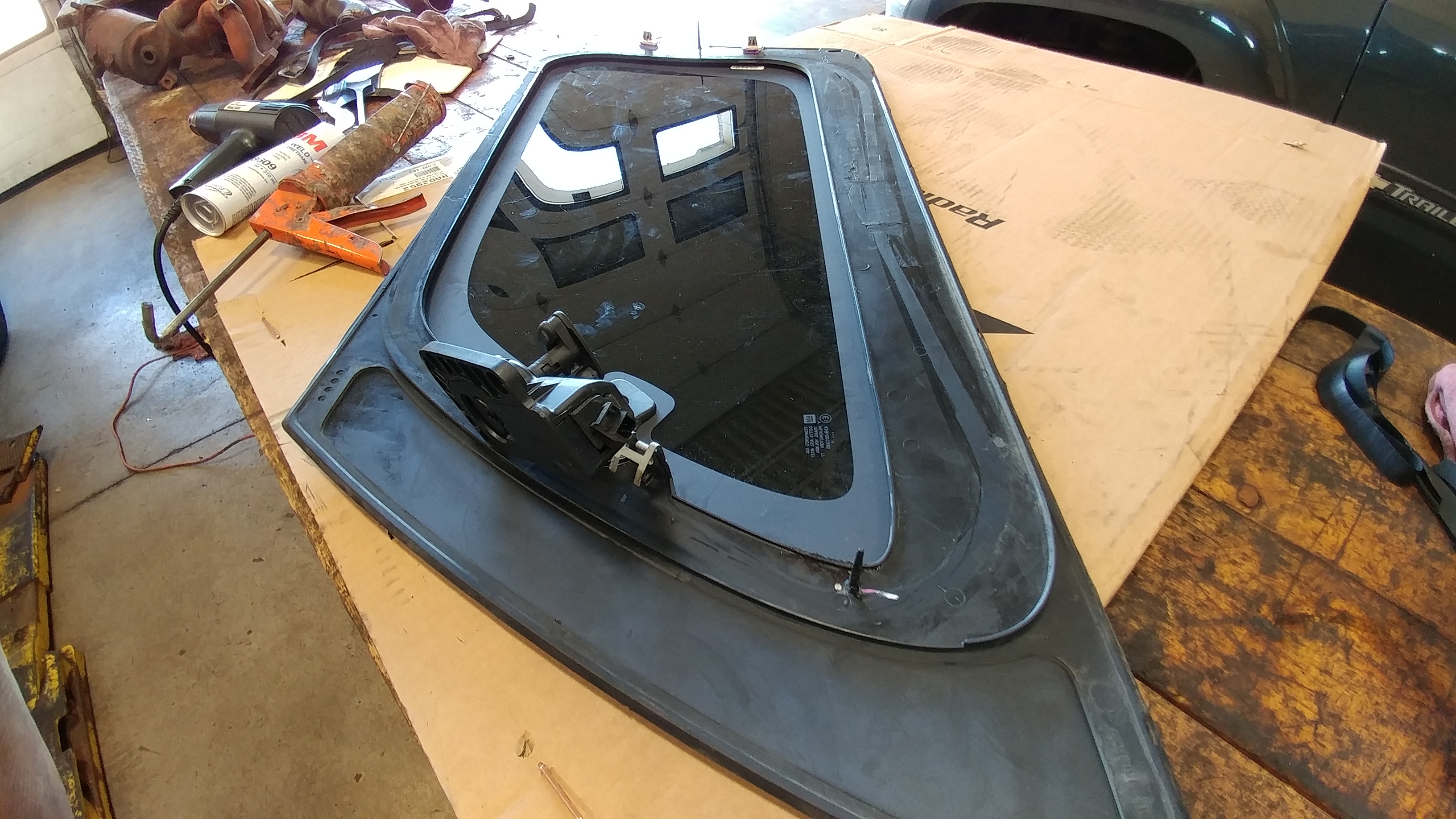

by Berettaspeed » Wed Jun 21, 2017 3:10 am
I could not find much info in the time crunch i had. I seen a few pics online of rear quarter vent window. but it didnt make much sense to me, so i pretty much waited for the used part to arrive and just winged it from there. i watched glass removal techniques from youtube on other stuff. I took my gasket scraper and a heat gun to remove the old glue from the used good assembly. i practiced on the old part that was in pieces. i dont know how the salvage yard guys removed it so well. im amazed. haha i just broke it as i went and took more care in not scratching the paint and what not. i heated the glue a tab but heated the scraper more. it worked great with slow even pressure. i could even tell when the heat was fading and had to re-heat.
i used 3M window weld glue cartridge. expensive but i hear its great for the job. i applied standard gasket sealer to the few deep metal gouges i made from removing the broken part. let it sit for an hour.
i left a small amount of old glue on both the truck and used window to help stick better.
there are line up pins and snap clips to hold this window in. so i did not use masking tape to hold it in place like a windshield.
the window motor i just copied the other side and it works fine with minor adjustment for the glass and how snug to seal closed, which also helps sets the glue.
i will find out if it held up tomorrow and a water test in a few days.
i did remove a few simple interior panels. the panels by the belts, and just the side a bit to see. took about 2.5-3.0 hours altogether.
includes learning and texting and practicing heat usage on the old broken part to make sure warping and how much heat was safe. i over heated an old scrap part to see limits. 20 seconds of high heat in one spot got it upset lol
any questions i can do my best to answer. my mind jumps around and i may leave out a few things.
hope this helps.

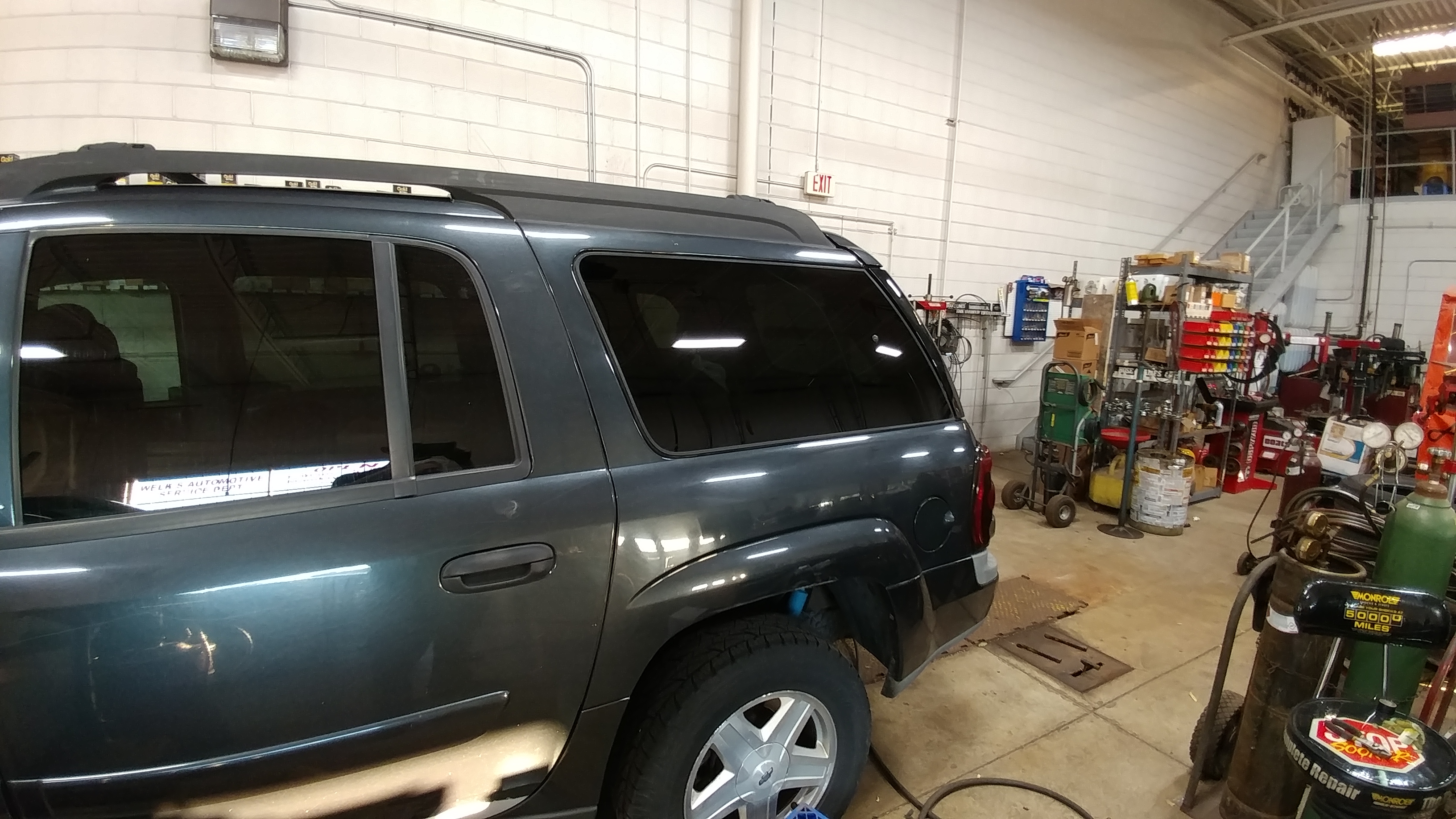

by Berettaspeed » Wed Jun 21, 2017 3:26 am
maybe took 4 hours. i had to hunt through a few videos and stare at mine for a bit.
hour to hunt and learn, an hour to remove from truck and then another hour to remove glue and prep surface. and an hour to applying glue and install and clean up. or something like that.
on a scale of 1-10.... i give it a 5/10. time consuming but not horrible. just had to learn, then it seemed fine once i just went at it and no turning back. doubt was not invited. :)
