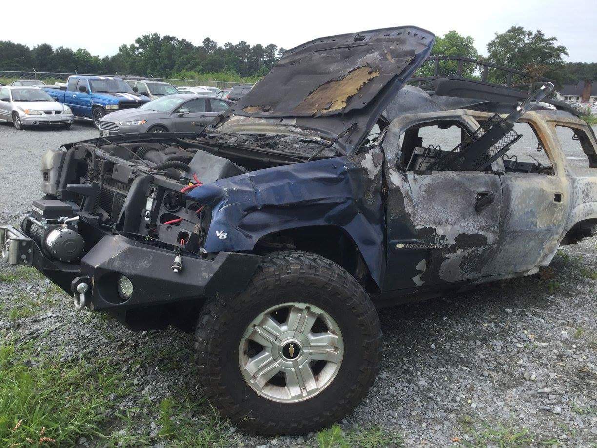

by escapepilot » Thu Sep 14, 2017 9:54 am
jdmser wrote:...I've been looking for a salvage 5.3 ext for a while now. That's probably the way I'll go.
Like this??? (some parts have been sold already)
