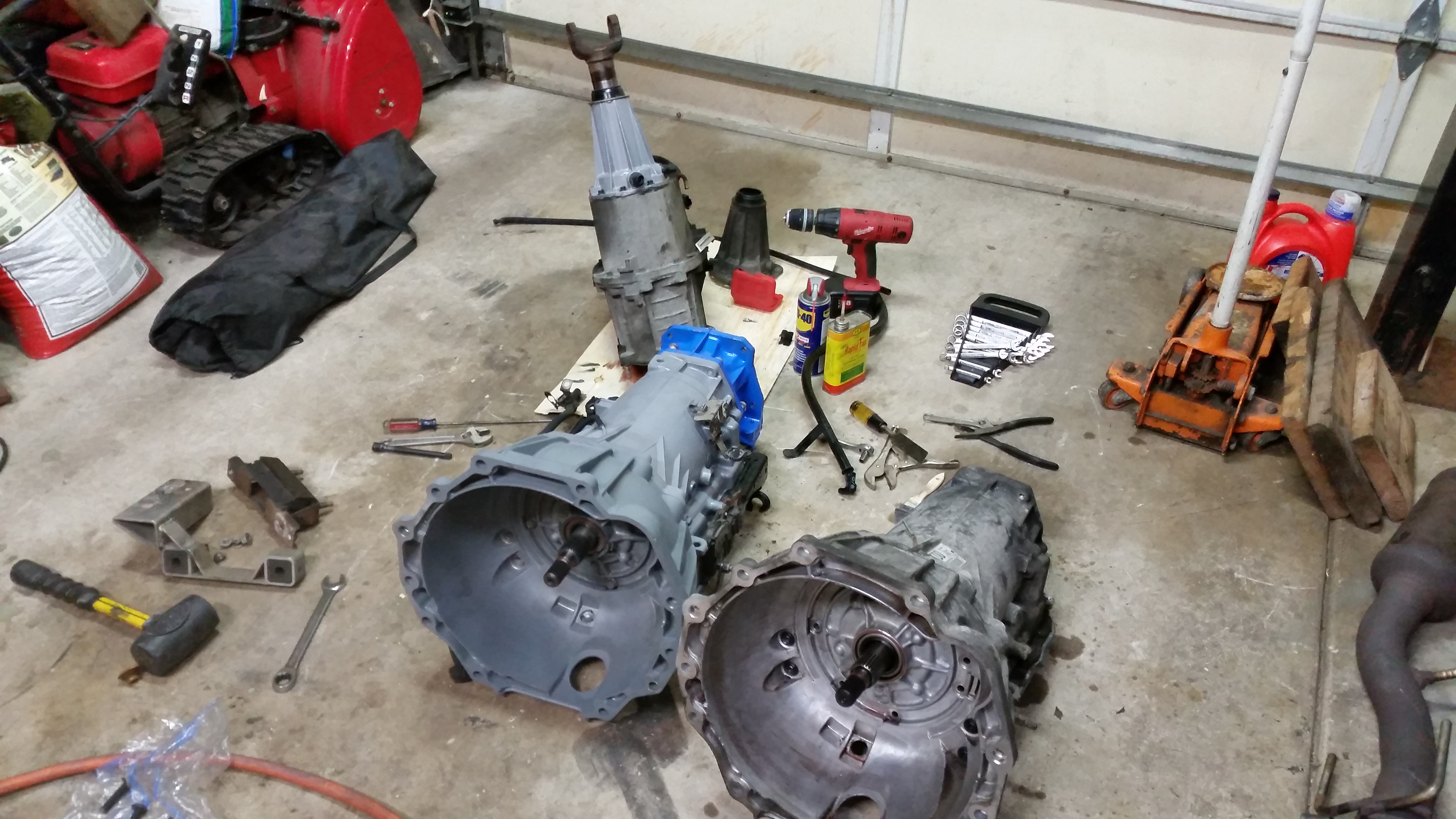

by larryk » Fri Jun 17, 2016 11:46 pm
This would be what I did tonight. Old on the right, new on the left in front of transfer case.

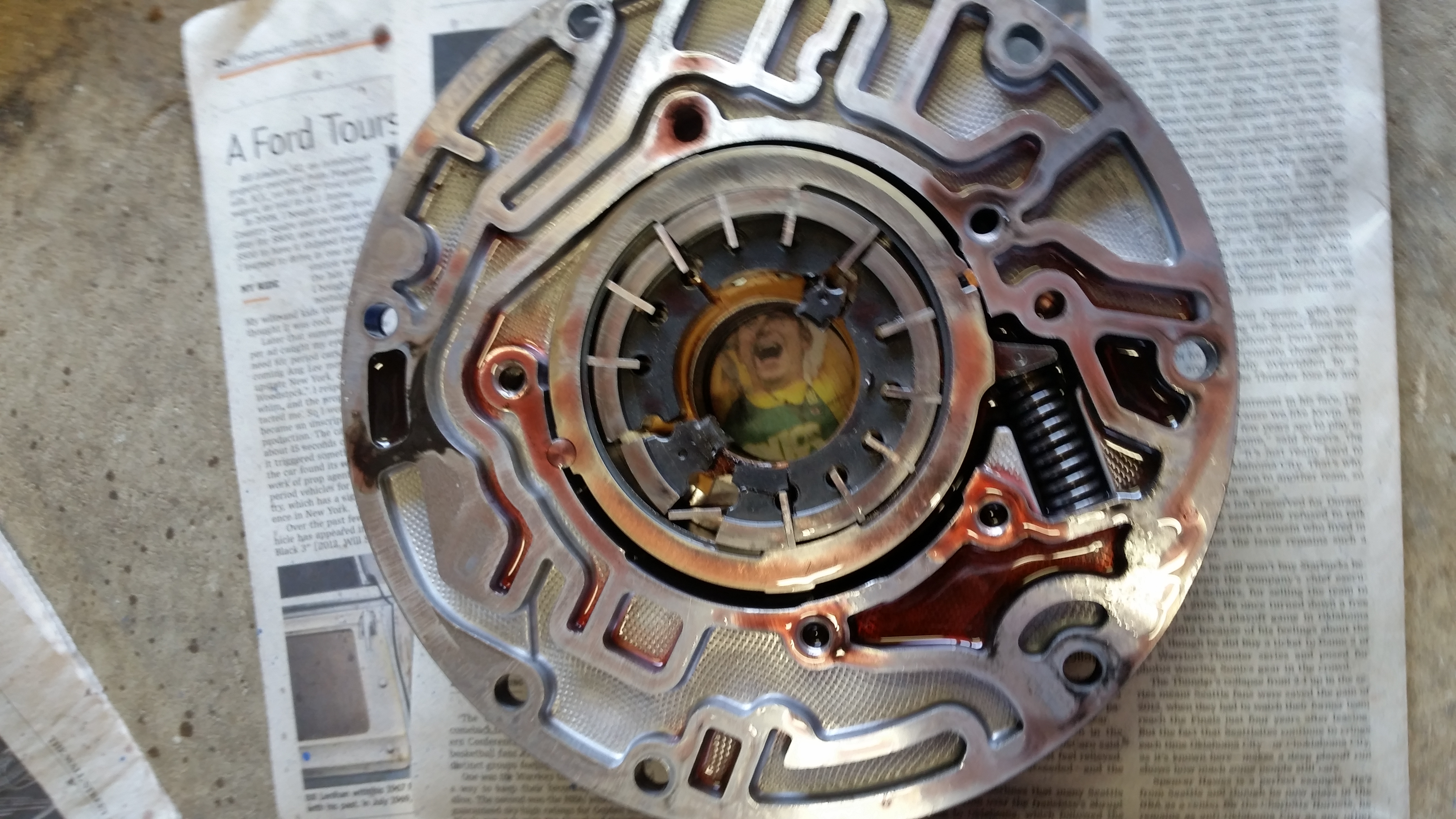

Autopsy happening tomorrow. I don't see any obvious carnage....other than what looks like the "dimples"on the inner face of the converter machined down. Look pretty shiny, but see no marks on pump bolts or any shavings....so maybe that was factory?
Lots done...Lots more to go

Welll.....as assumed, the pump took a crap. As I noted in my OP, there was absolutely NO signs this was coming....just died. As you can see from the pic, the pump rotor was in about 7 pieces I could identify. Upon my first look....counted only 12 of the 13(!) vanes, so I had to dig some more. It was actually lodged in the pump inlet, between the pump itself and that rubber grommet that holds the filter in. I couldn't account for a small part of the rotor itself, so Im not sure where it went. I put new lines on and flushed the cooler, so there is no chance of it being lodged in the lines somewhere. *May* be in the converter.....who knows as I replaced that as well.
