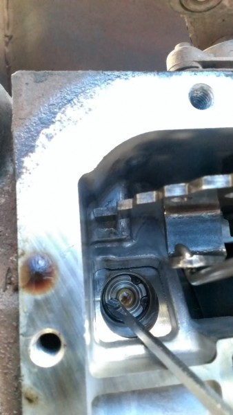

In the process of installing the transgo kit and have hit a snag. I need to do the springs for the pressure regulator bit can't find.what I'm looking for based on the write up I've been following. Here's what I'm talking about...
It's a 2008 4.2l 4wd
The last picture is what I'm looking for, first picture is what I'm seeing...
Looks like it's under that plug...but idk if/how to remove it without breaking it...

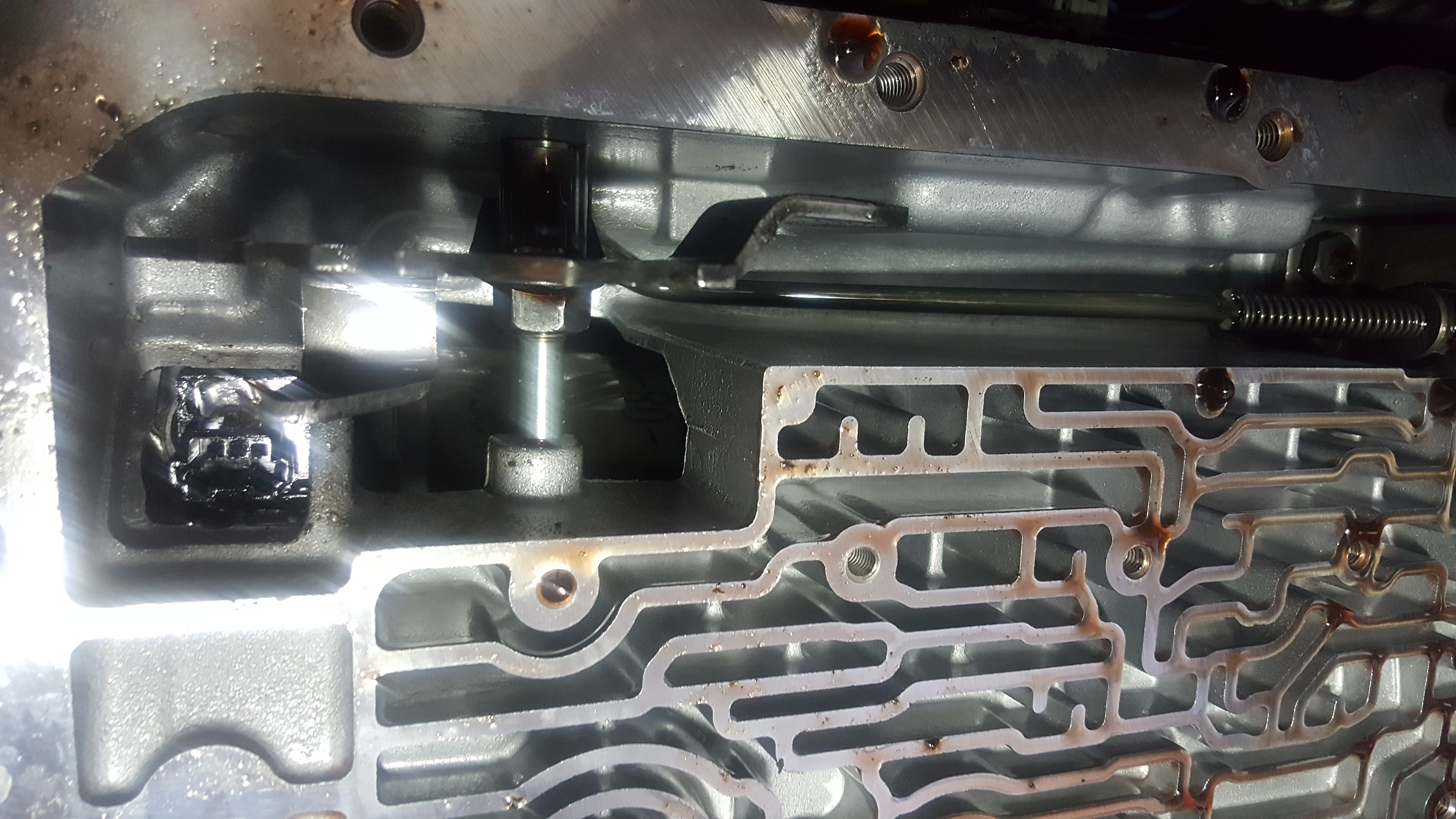

What I should see..

by v7guy » Sun Apr 10, 2016 11:16 pm
The later 4L60E transmissions have a speed sensor of some sort there, only way to get to the boost valve on those transmissions is to pull the trans, pull off the pump and replace it with the pump outta the vehicle and trans. To the best of my knowledge there is no way to remove the electrical connection.
by Jrgunn5150 » Mon Apr 11, 2016 6:01 pm
Correct, no boost valve in 08.
