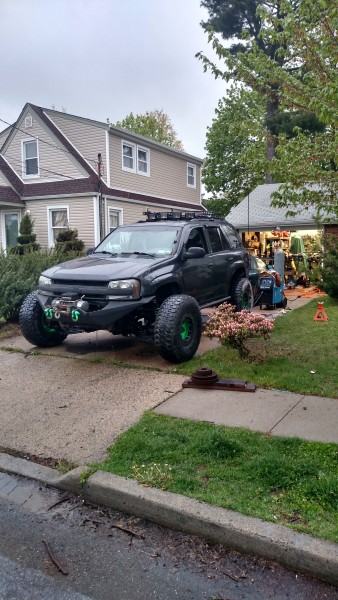

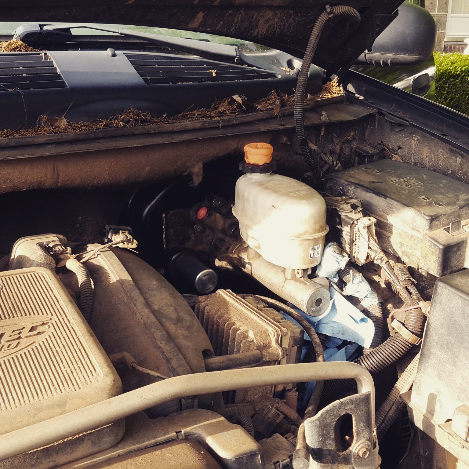

Took it for a quick test drive the other day. Gonna have to trim the bumper since the tires hit it while turning, was also having trouble getting good pedal feel on the brakes, it would stop, but the pedal was mush. Ended up swapping to a hydroboost setup off the 2500hd Silverado to match the rear axle/calipers/etc. Was going to do a write up for it, but I think it involves too much fab to be a viable option for most people.
Test driving it has been pretty fun. It's pretty peppy with 5.13s, gonna be hard to be gentle for the gear break in.
Still got to build some fenders, wire up the compressor for the locker, install some new headlights, fix the remote start, etc etc etc the list, it's never ending.

Thanks man, Moots was giving me a hand the other day and commented "you know, it really doesn't look that crazy". From the comments I get elsewhere I think him and I are just used to it. Hell, the 37s don't even look that big to me anymore.

Glad to see you went hydroboost, after all! Brakes feel good now? Using your stock pump?
Posts: 4471
by v7guy » Tue May 24, 2016 11:50 pm
Yup, brakes feel better than they ever did stock. Using the stock power steering pump, unaltered, and it appears everything works really really well.
Hydroboost ends needed brazed onto trailblazer lines, the return line for the hydroboost was tied into the return line on the power steering, the brake pedal needed modified and one stud on the hydroboost mounting plate had to be moved to match the firewall since there isn't a place on the firewall to drill... thank you GM for making our firewall oddly shaped. Other than that it was fairly plug and play.
