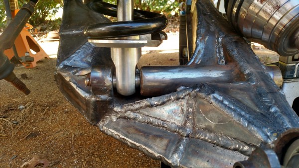

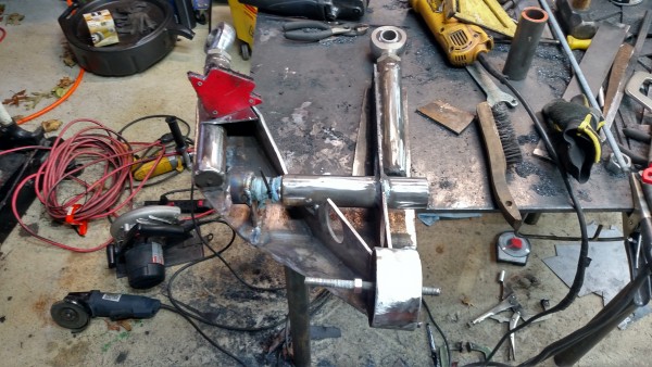

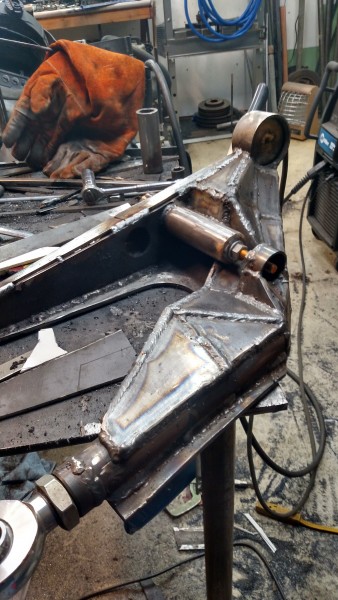

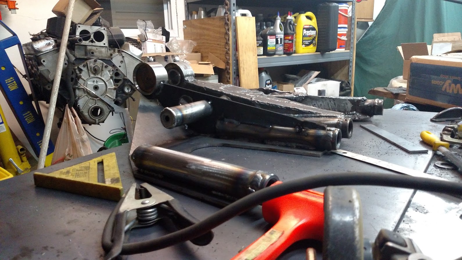

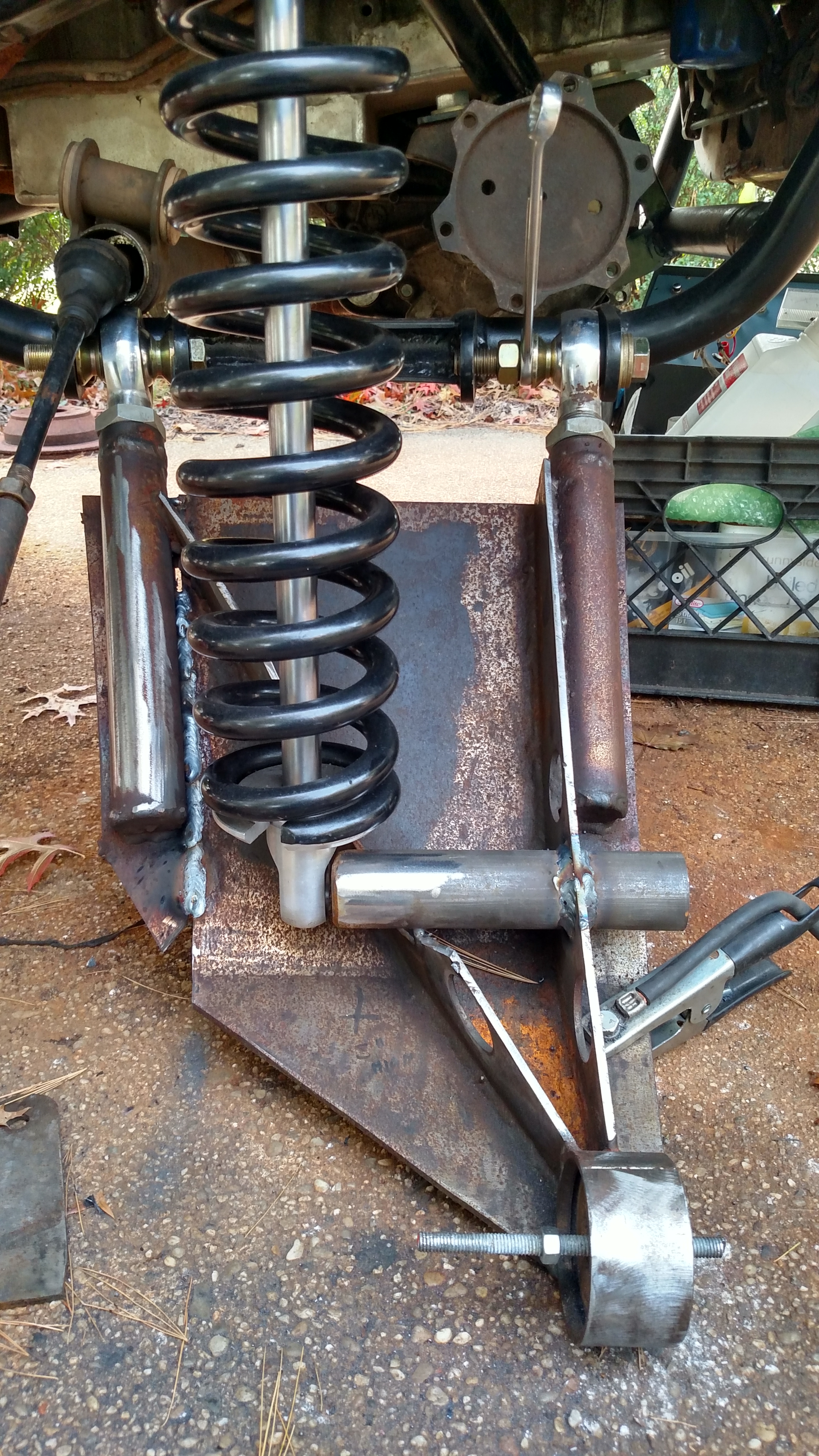

I've been through a few issues with packaging when getting down to the .25 inch here and there. Found some time to work on the lower A arms. Shock mounts inside the arm, all the complicated shapes are to accommodate the lower spring mount.

by Trail X » Tue Nov 03, 2015 4:03 pm
You don't do things the simple way do you Jason? Looks pretty sweet.

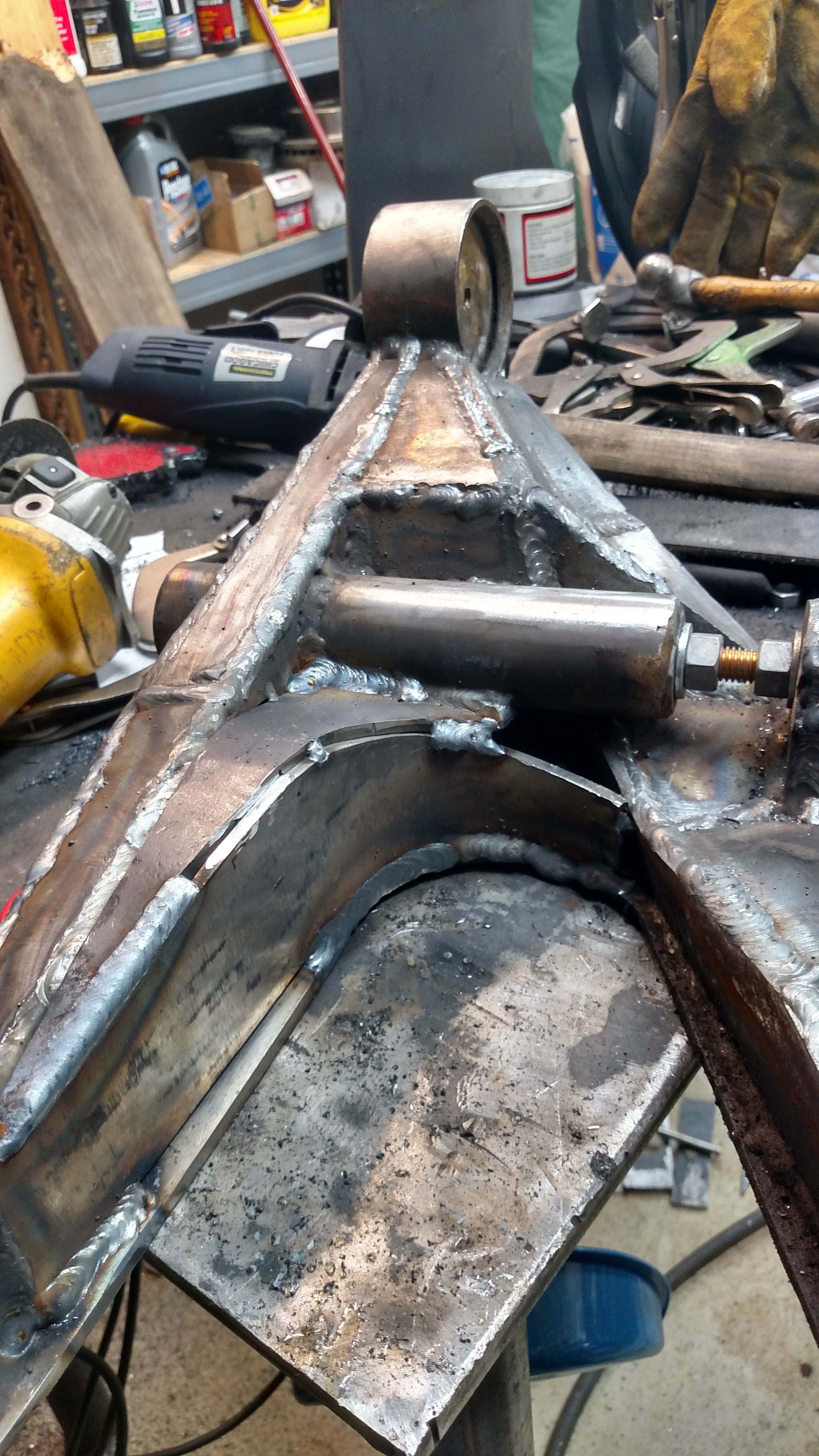

However, why is the section (nearest the shock mount) with the most bending stress the skinniest (height wise)?
Posts: 9935

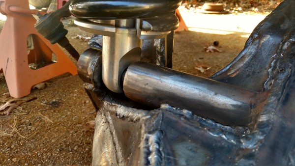

by v7guy » Tue Nov 03, 2015 5:19 pm
Unfortunately it's a symptom of burying the shock in the arm, there needs to be room for the spring perch as the suspension cycles. I'm still adding a bit of metal on the curved part of the A arm, should have it finished up this evening. I originally intended on mounting the shock on top of the arm, but I would've been losing room I needed for the shock.
Basically the never ending issue of shoving 15 lbs of shit in a 5lbs bag

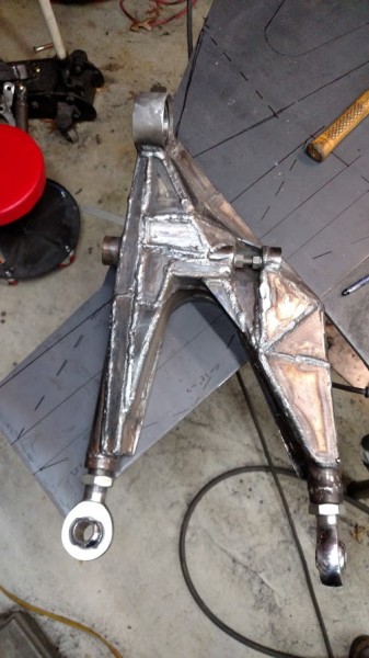

by Trail X » Sun Nov 08, 2015 11:31 am
Have you thought about doing a bending calculation of your arm in that area just to make sure your arm is strong enough to handle whatever you throw at it? It would be difficult to calculate the second moment of area, but you could probably get close enough. What's the yield strength of your materials?
Posts: 9935
by v7guy » Sun Nov 08, 2015 9:06 pm
It's just plain ole 1018, 1/4" bottom plate and 3/16" for all the other pieces. I'm not aware of any calculators that can figure it out... And I'm kinda dumb, so there's that too lol
I believe that area is about an inch tall at the slimmest point, but it's not even necessarily a rectangle beam.
Fairly concerned about it?
by HARDTRAILZ » Sun Nov 08, 2015 9:29 pm
Simply...
Atta Boy!
by bartonmd » Mon Nov 09, 2015 10:04 am
Is there a way to put a piece of 1/4" material, on its edge, from one high spot to the next going up to the height of the top of the tube that holds the shock bolt? Even better, to box in to the height of that cross tube, either to the front or rear of that shock? It looks like it in those pictures, but who knows what'll happen at the different angles.
by v7guy » Mon Nov 09, 2015 11:08 am
If you're talking about the long tube side, I could box it in a bit better. The short tube side I could do a little bit. But with the coil spring mount there's only so much room as the suspension cycles... There is room to add more, but I don't think I can make it a straight boxed in section, it gets about 7" down and 10"up with a content CV, so the spring collar gets at some pretty steep angles.
I'm headed back out in a minute, I'll check.
by v7guy » Mon Nov 09, 2015 1:55 pm
It looks like there's room to box it in on the inside (towards the subframe) and on the long tube side I could probably do the same going out. Is it worth the hassle?
I assume the point is to increase the cross section.

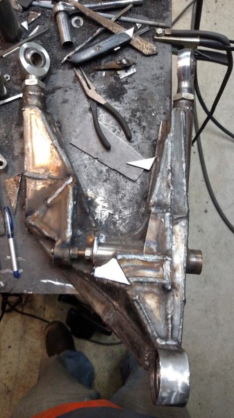

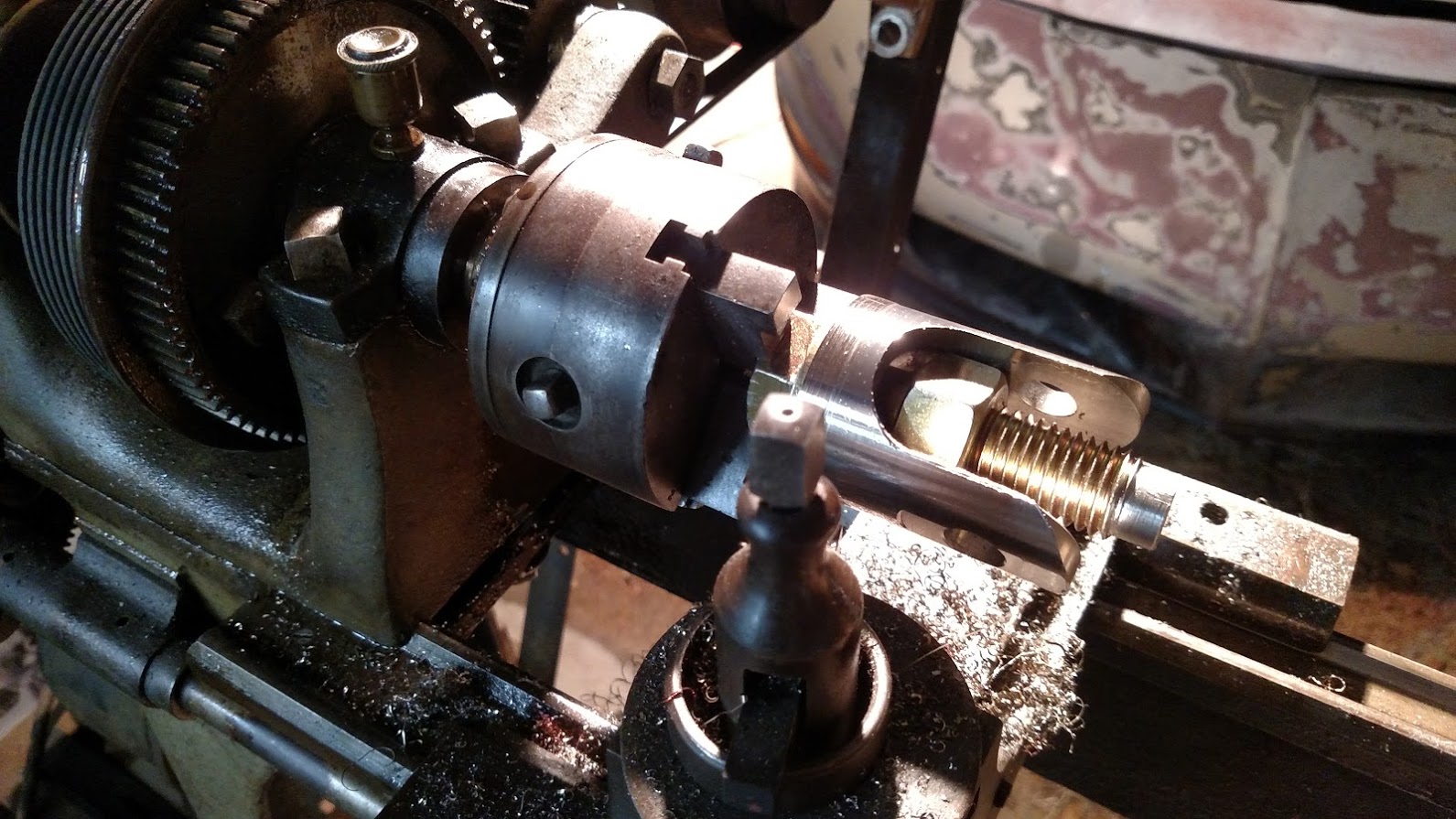

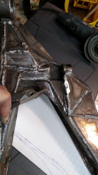

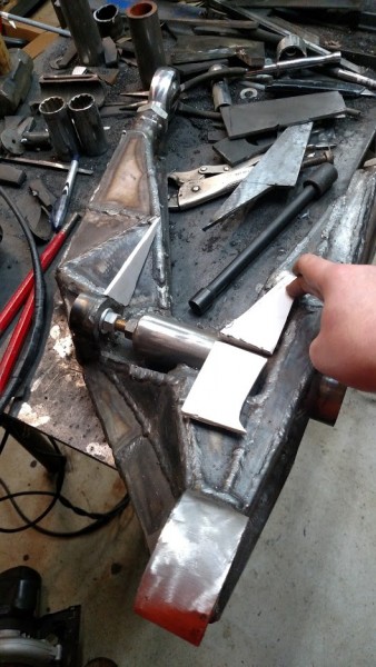

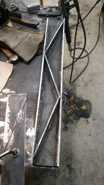

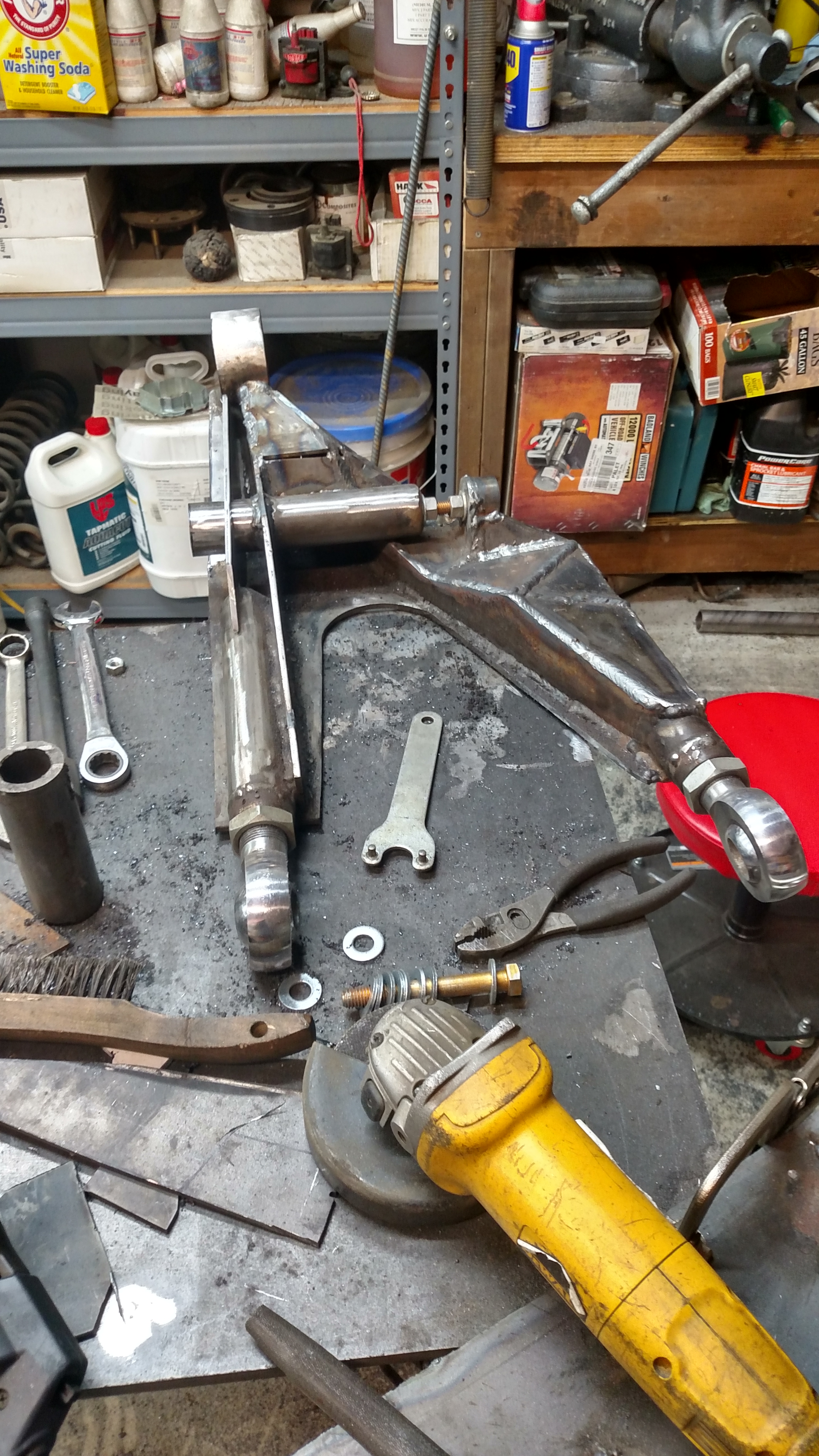

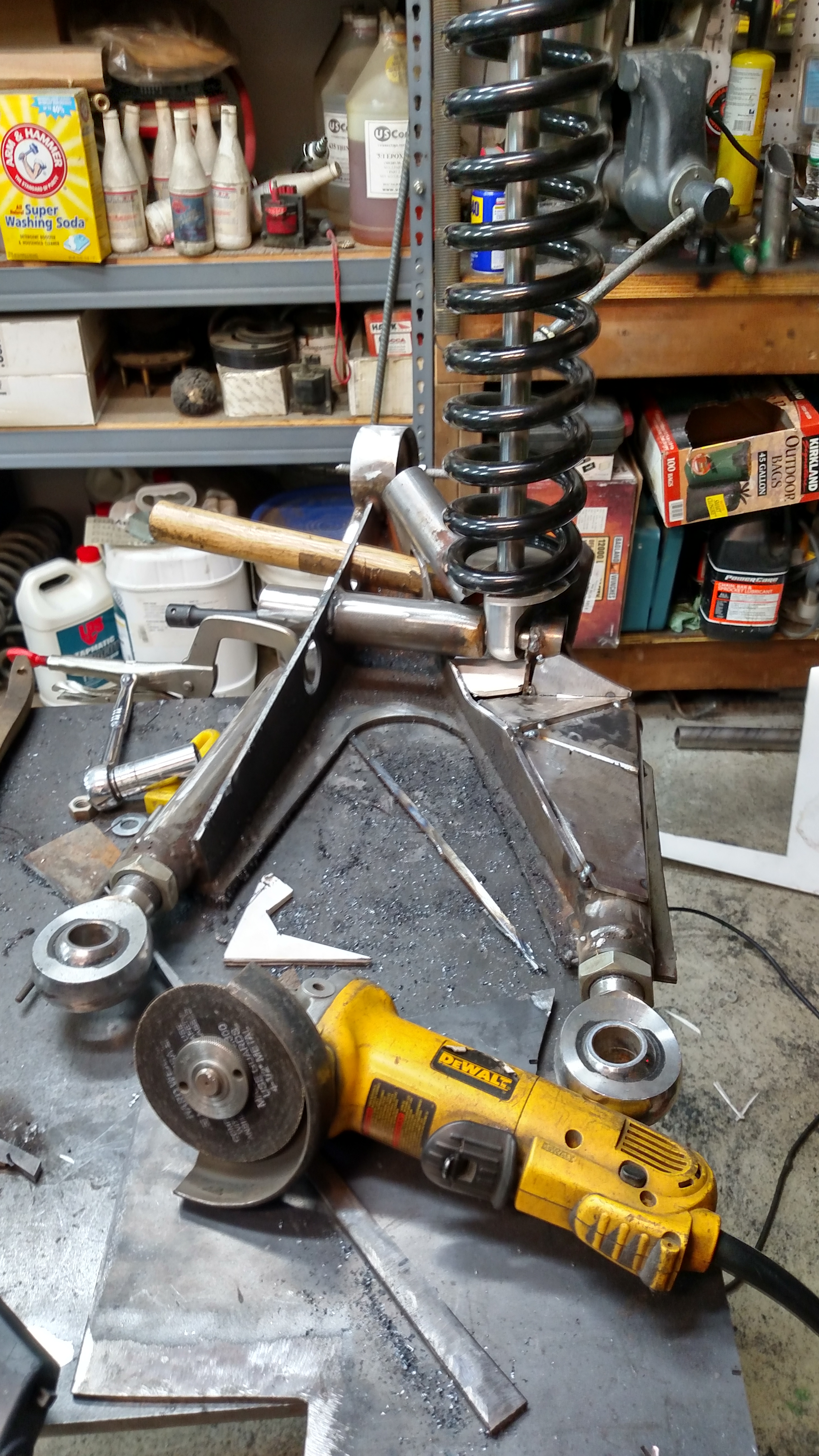

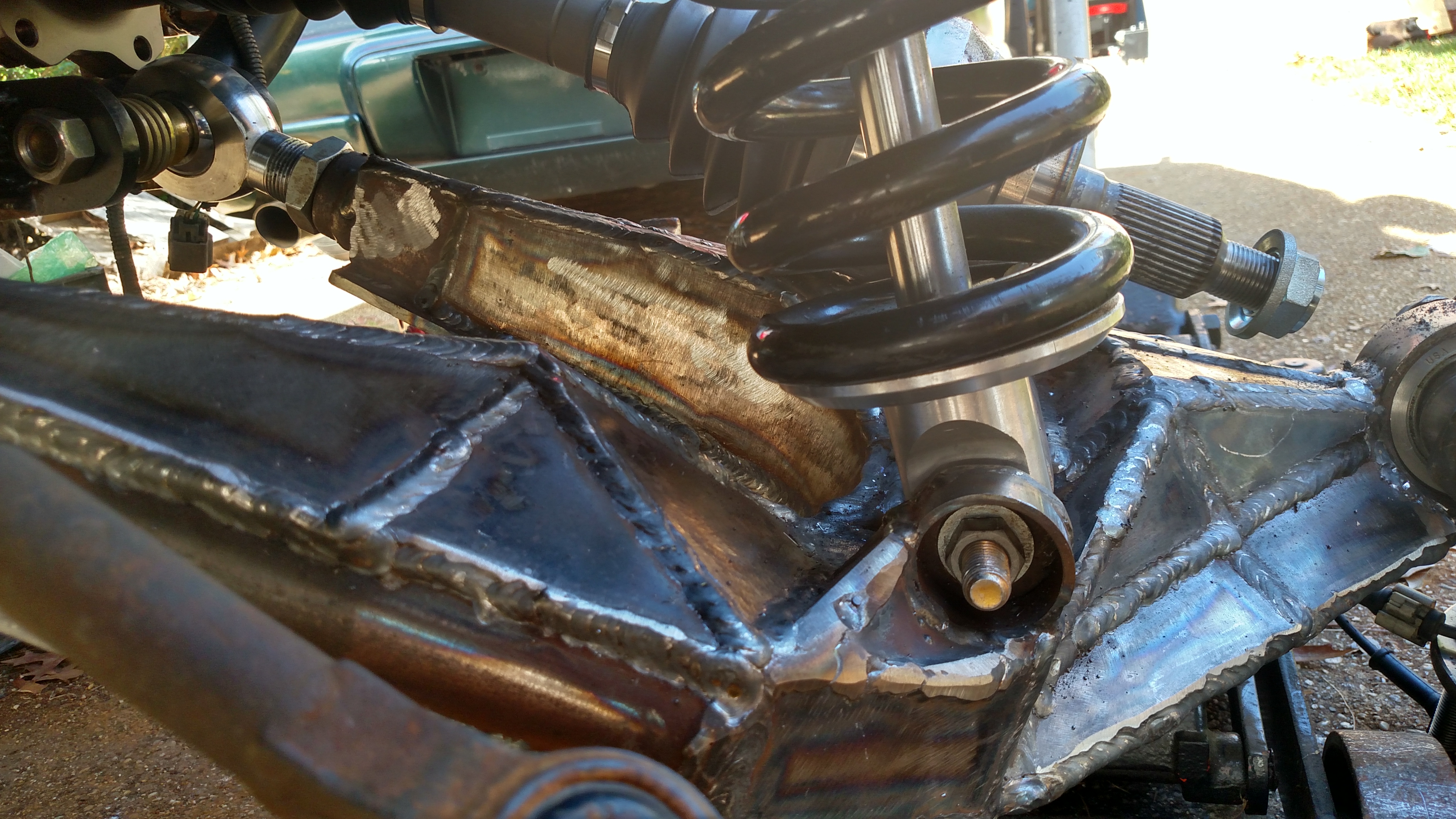

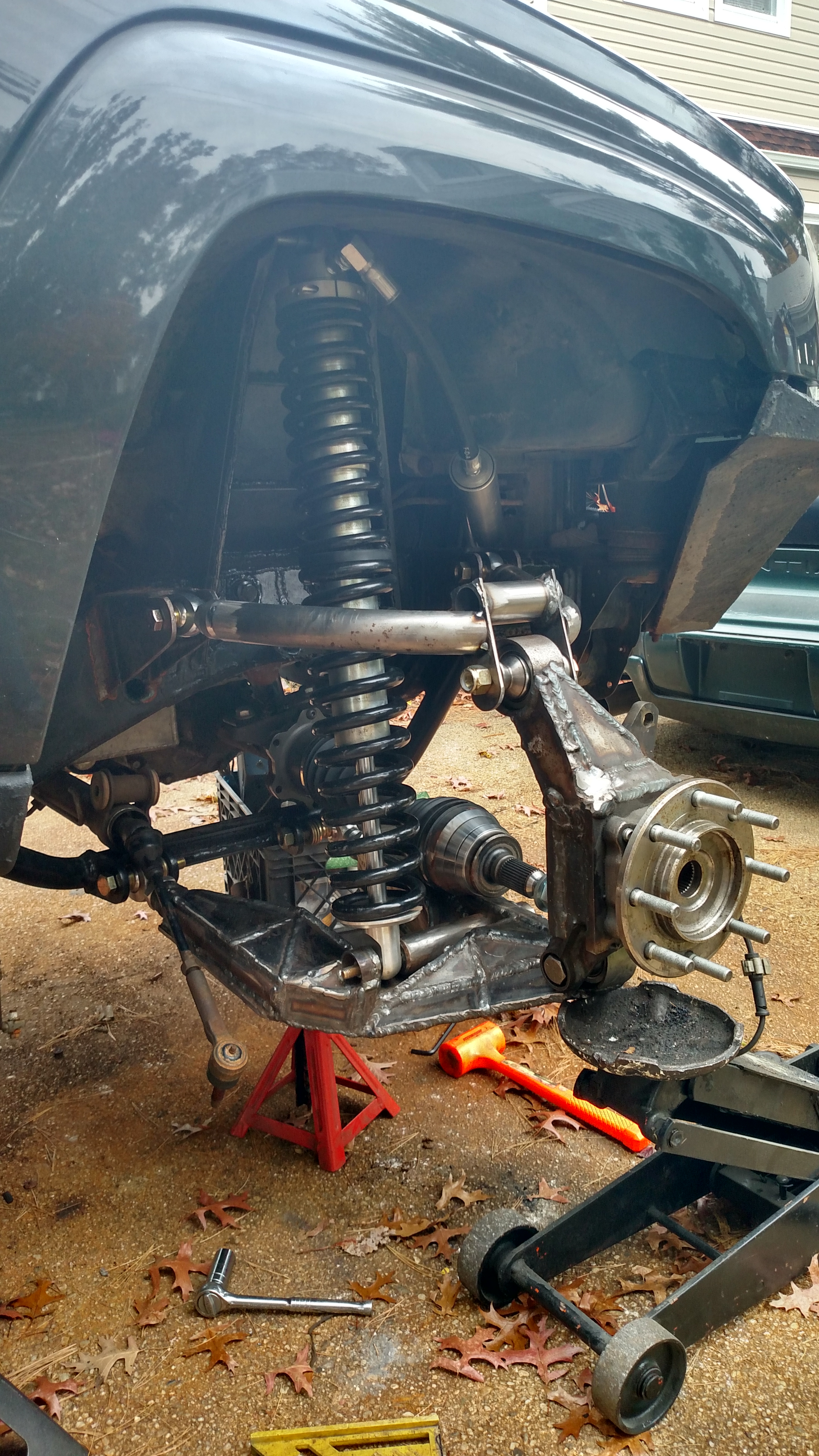

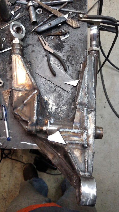

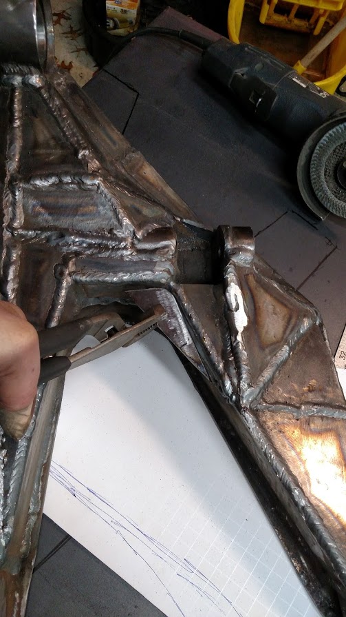

by v7guy » Fri Nov 20, 2015 5:56 am

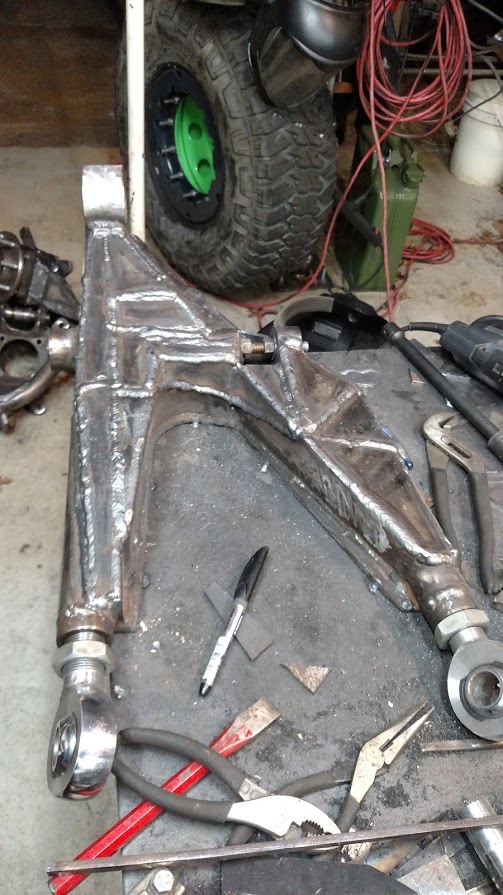

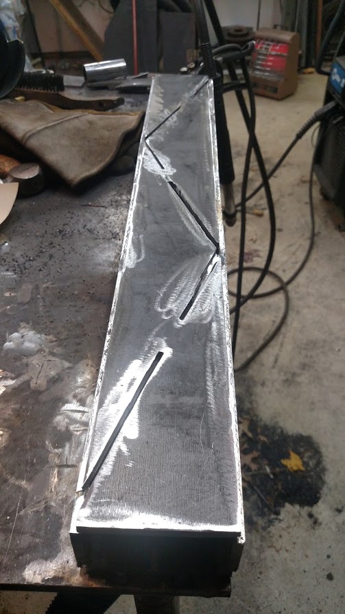

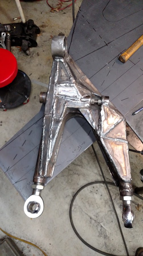

With some helpful input from Mr Barton and Mr Downing I added 5 lbs of steel to the A arm. Built a rear crossmember for the subframe and turned down a clevis I bought for another application so it'll fit in our rack. Then started on the other lower A arm. Given the ridiculous width I've got some thoughts in mind for fender flares that will take being rubbed on everything, cause after all, they probably will be. It'll probably look like shit like everything else. But it should work.
