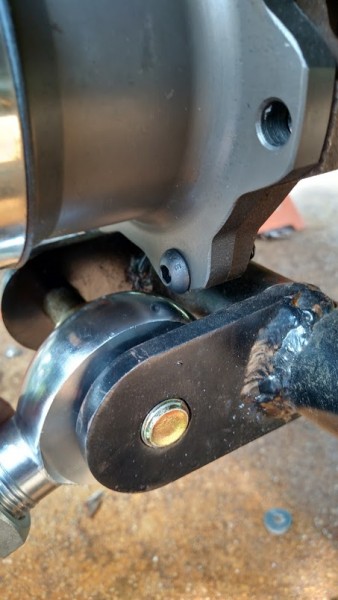

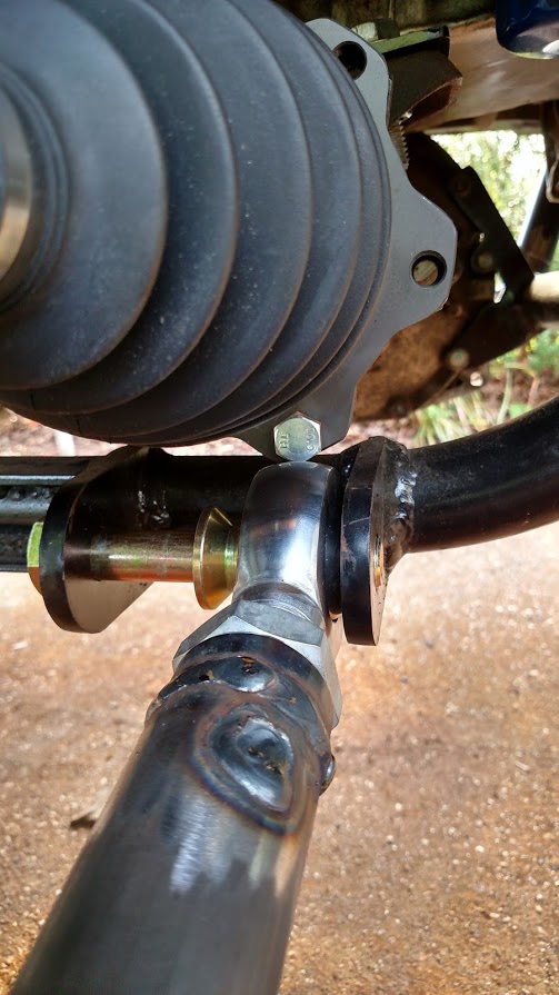

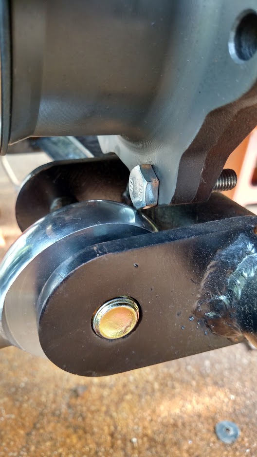

While getting ready to start building the A arms I fit up everything yet again and ran into an issue with a bolt clearance on the CV. In my attempt to keep everything tight I forgot to account for the bolt head height. found some 10.9 button head bolts that should do the job though. But basically I waited for a week or so to get these in to make sure I wasn't going to have to cut the mounts off and redo them.
I also rechecked the shock yet again after finding the bolt head issue. So far so good.
This is probably the first big issue I've ran across while building this thing, hopefully it's the only one.

by Trail X » Thu Jun 11, 2015 11:12 am
Don't worry, it'll self clearance.
Posts: 9935
by Moots1288 » Thu Jun 11, 2015 6:41 pm
That shaft looks a little short...
Story of your life?
by HARDTRAILZ » Fri Jun 12, 2015 8:51 am
Moots has jokes ;)
by Trail X » Fri Jun 12, 2015 9:57 am
Are you threading the plate here? or are you just mocking it up with a short bolt?
Posts: 9935
by Moots1288 » Fri Jun 12, 2015 12:29 pm
He was checking clearances and I believe that bolt is in what would be its final resting place. That's why he had to go with a button head bolt.
by Trail X » Fri Jun 12, 2015 1:02 pm
I meant the big bolt.
Posts: 9935
by v7guy » Fri Jun 12, 2015 1:38 pm
Moots1288 wrote:That shaft looks a little short...
Story of your life?
It really is the story of my life, such a shame.
Trail X wrote:Are you threading the plate here? or are you just mocking it up with a short bolt?
It's just a shorter 3/4" bolt I had laying around that I jammed in there. It'll get a longer bolt and a nut when it's bolted in.
I generally shy away from threaded holes since it's awful easy to get em buggered up and then it's a disaster to fix/replace.

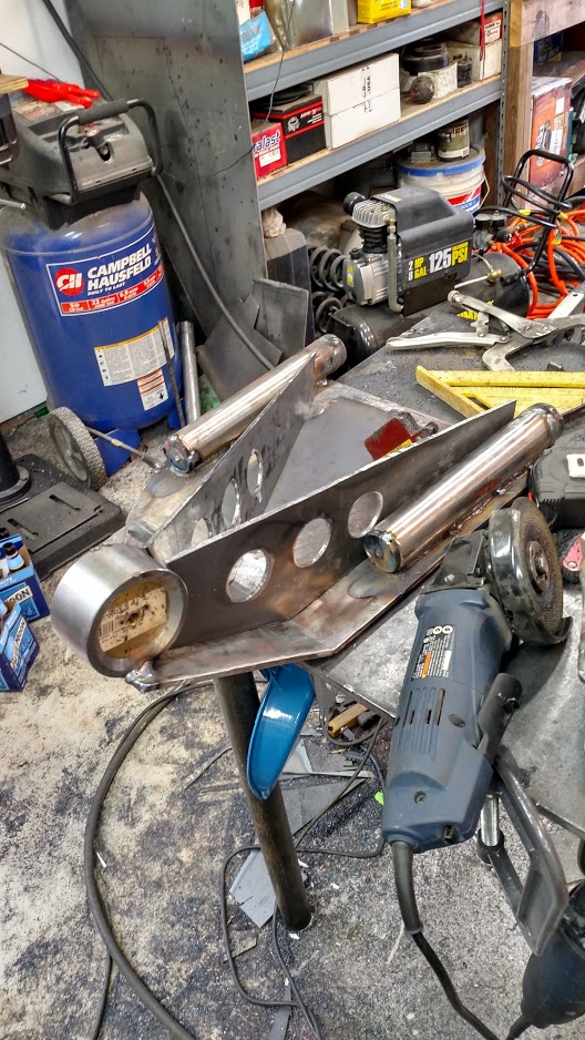

by v7guy » Fri Jun 19, 2015 9:12 am

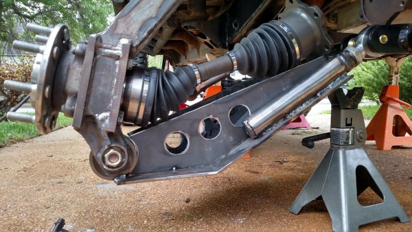

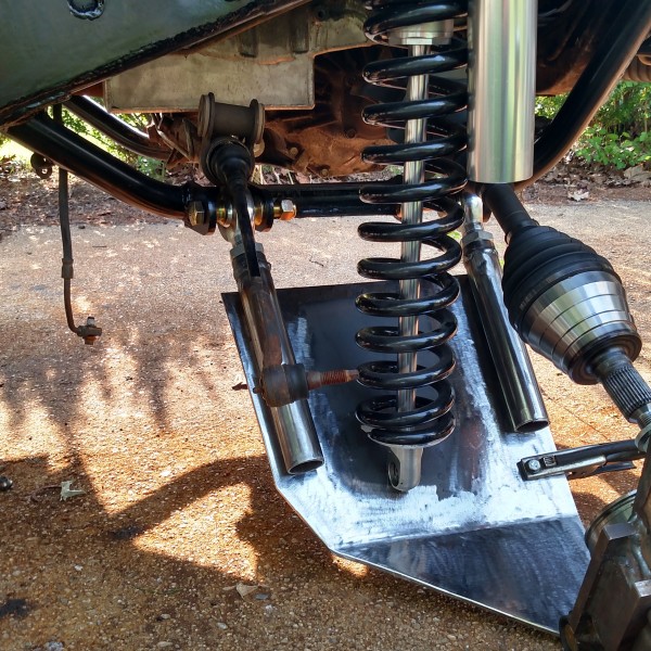

Got some time to test fit the ole A arm, gonna need to clearance the bracing a bit, but nothing crazy.

by Trail X » Mon Jun 22, 2015 8:08 am
Does that lower picture represent the geometry at full droop? Where will the strut mount?
Posts: 9935
by bartonmd » Mon Jun 22, 2015 8:58 am
FWIW, just me, I'd like more of a "box" structure on the LCA. Unless what's shown is getting more metal on it, it doesn't look torsionally very strong.
by Trail X » Mon Jun 22, 2015 10:47 am
That's why I was asking about the location of the strut. Right now, as pictured, there really isn't any torsional loading. Depending on where that strut mount goes, that could all change.
Posts: 9935
by bartonmd » Mon Jun 22, 2015 11:23 am
That's a big part of it, but there will also be torsional loading when the control arm hits a rock.

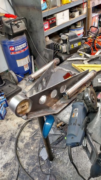

by v7guy » Mon Jun 22, 2015 2:13 pm
It's only about half done, I still gotta put a top plate on it, put in a shock mount and box in all the sides. I was just checking clearances there.
by bartonmd » Mon Jun 22, 2015 2:32 pm
OK, cool!
by v7guy » Mon Jun 22, 2015 9:50 pm
I plan on bringing the shock mount up from the bottom plate through the top plate so the whole A arm has to come apart to rip it out. The A arm is probably overkill, and excessively heavy, but I figure it's better than the alternative.
