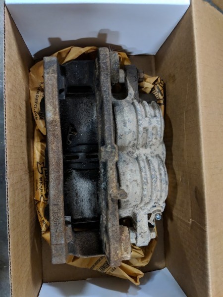

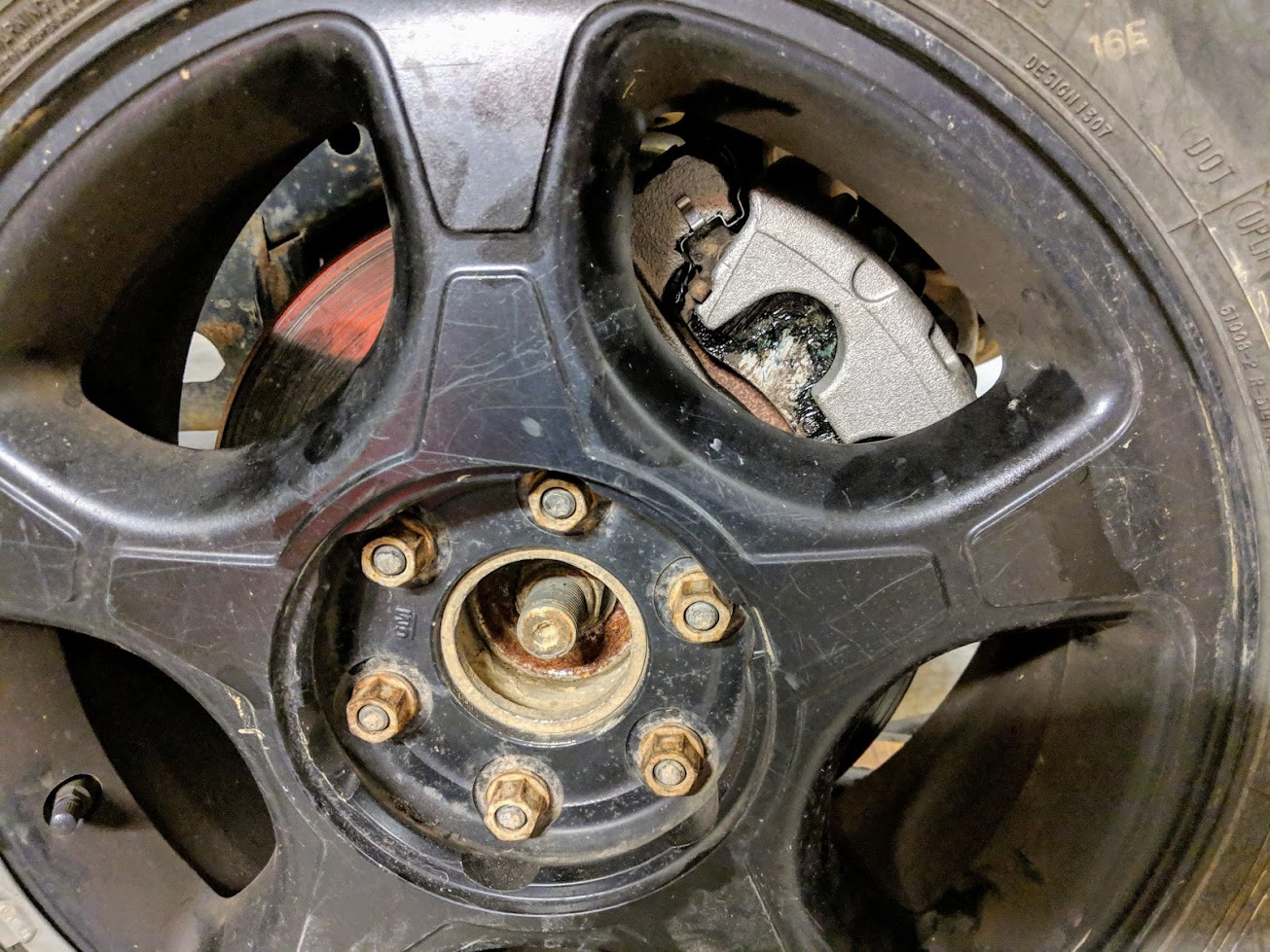

I've been having some bad steering wheel vibrations on the interstate lately. It sounds similar to some of the things I've heard guys complain about before, but I never saw a resolution.
The vibrations occurred mainly on the highway, but only for the first mile or so. The vibrations would then settle out. Never had any pull one way or another. Tires all seemed fine, proper inflation, no flat spots.
I started realizing the brakes on the passenger side were getting very hot after driving. Sure enough, if I lifted the passenger tire off the ground, I could barely spin the tire by hand.
Turns out I had a frozen caliper piston, and as the rotor heated up it would warp and then once it reached steady state, the warp would become uniform across the rotor, which would eliminate the vibration. It was really odd.
Anyways, I got that all settled out. Caught it before the rotor and pads were ruined. Amazing how cheap calipers are.
Also, does anyone know why vacuum bleeders don't seem to work on our brakes?

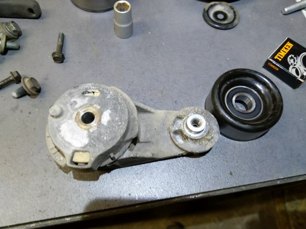

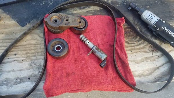

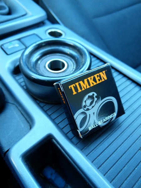

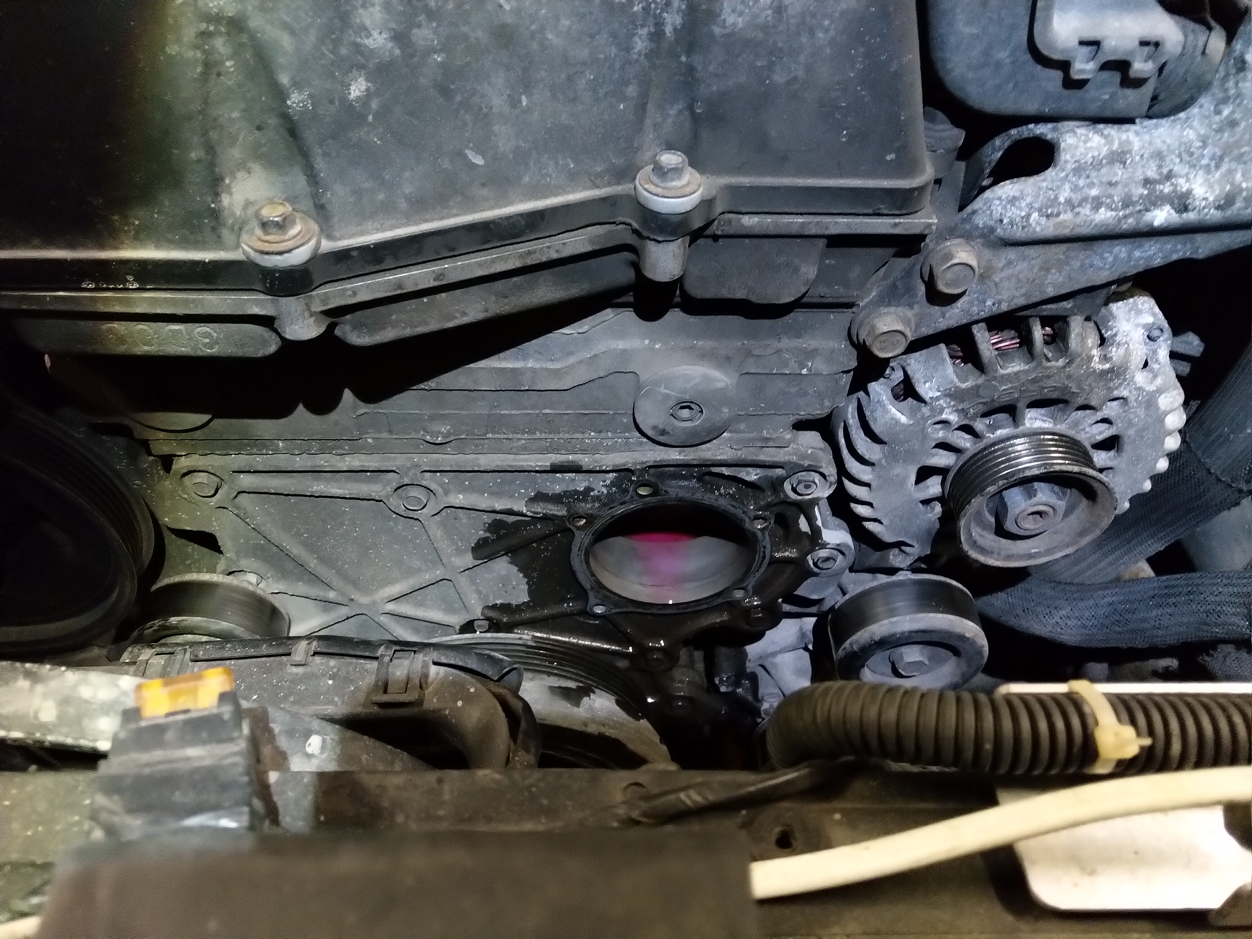

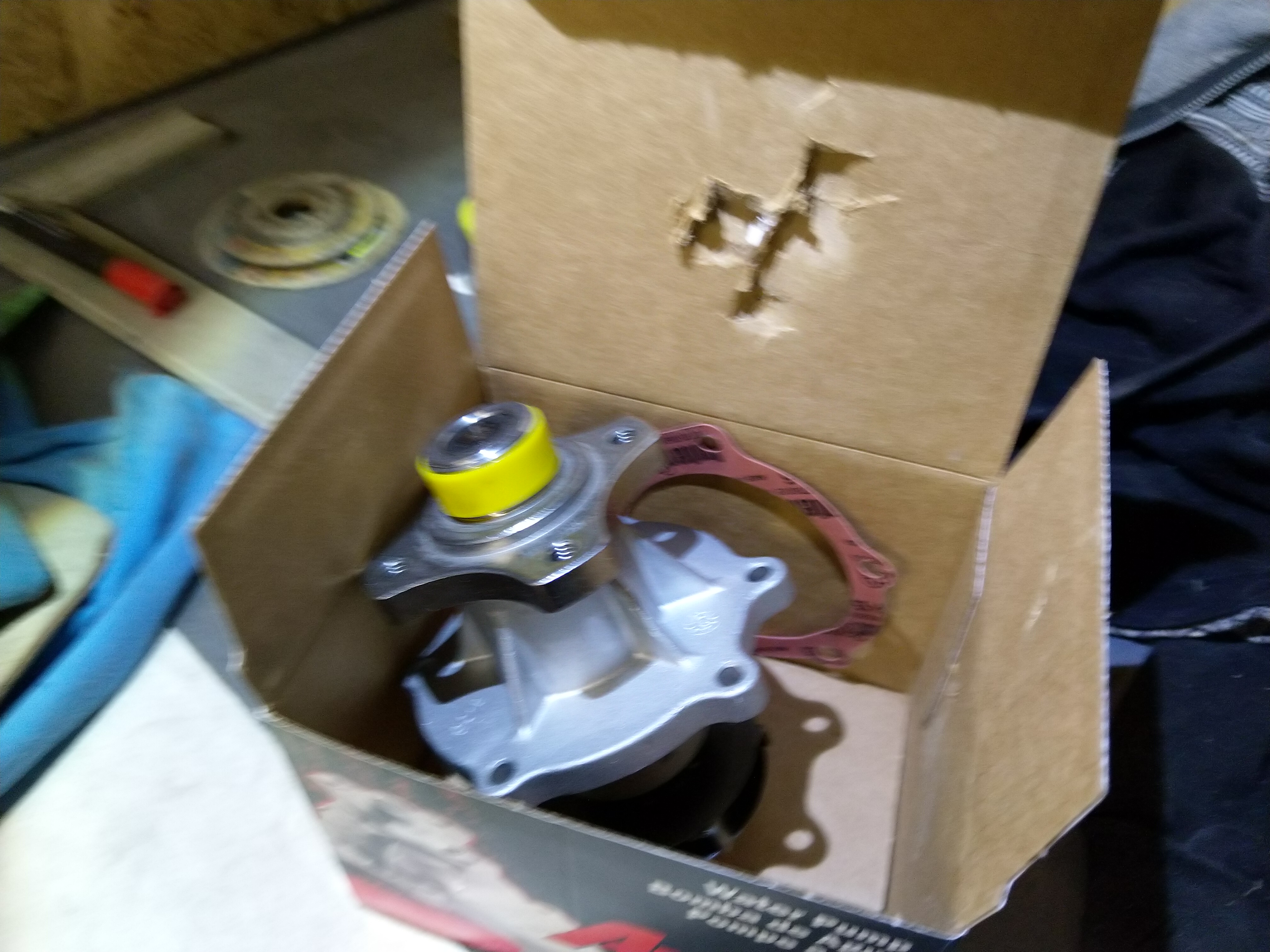

Been a productive couple of days for me and the rig. Yesterday was disassembly and inspection of suspension, clean regrease disco, and replace front brakes.
Today was serp belt, tensioner, idler pully, and VVT. Todays maintenance went by surprisingly fast even though it was the first time doing all of it except for the belt. Start to finish, got those 4 things done today in about 1.5 hour. Oh and that 12v ratchet was a godsend for working on belt accessories.

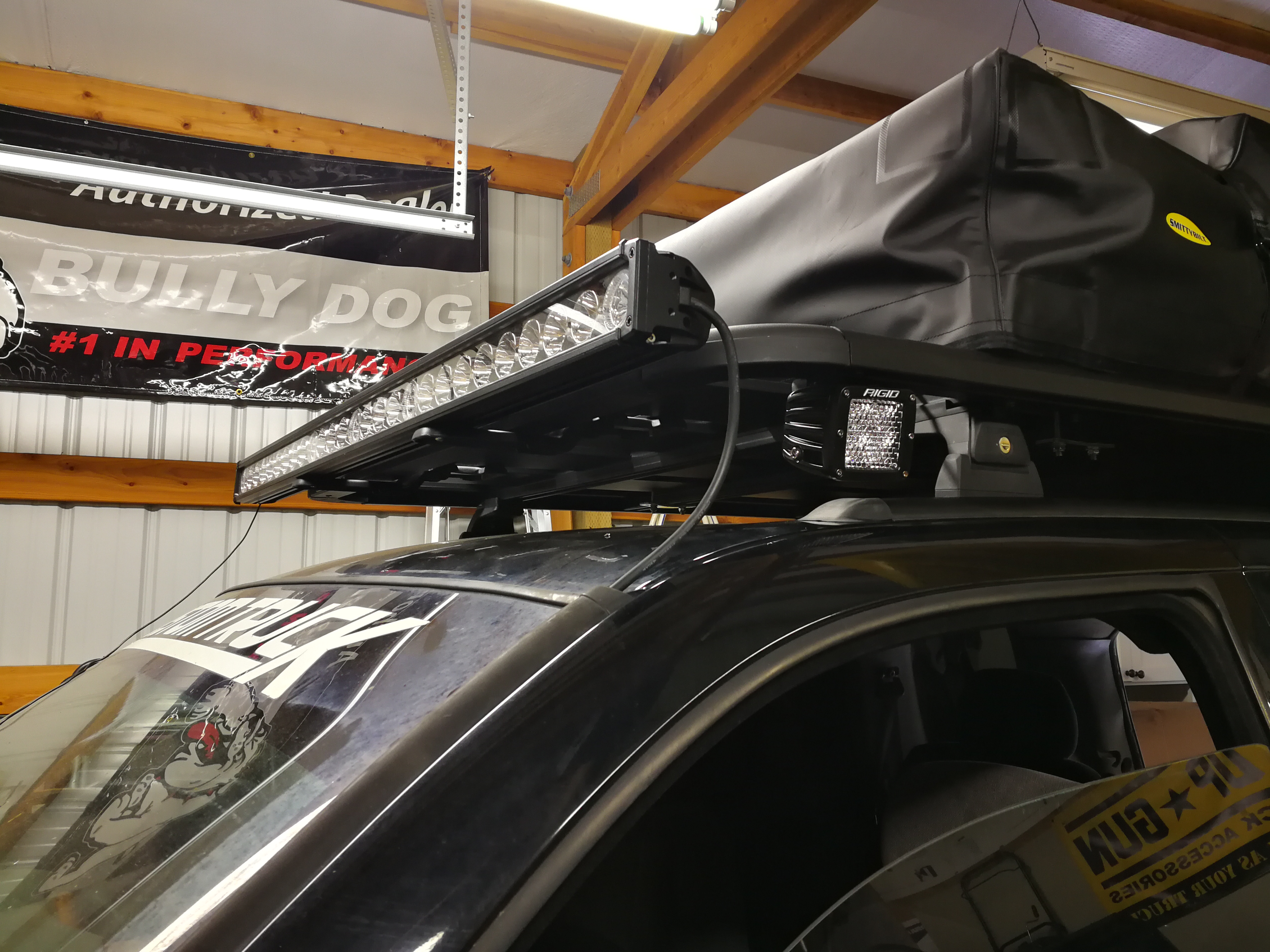

I bought (2) 2" square led light pods to add as alley lights over the front doors, and then a 14" bar to illuminate behind the truck when the tailgate is closed. Cheap Harbor Freight lights. I was hoping the alley lights would fit under the RTT, but no such luck. I really don't want to drill through the roof. If I have enough room to slide the tent aft a couple inches, I should be able to use the front mounting bolt of the factory roof rack. If not, I may have to fab up small extension plates.
Which rear springs are you using? I'm still on my first set of Z71s, but have given thought to going skyjacker. I carry a shit ton of weight in the back and figured progressive were the the way to go, but I'm curious if the skyjackers would be more comfy.

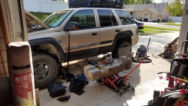

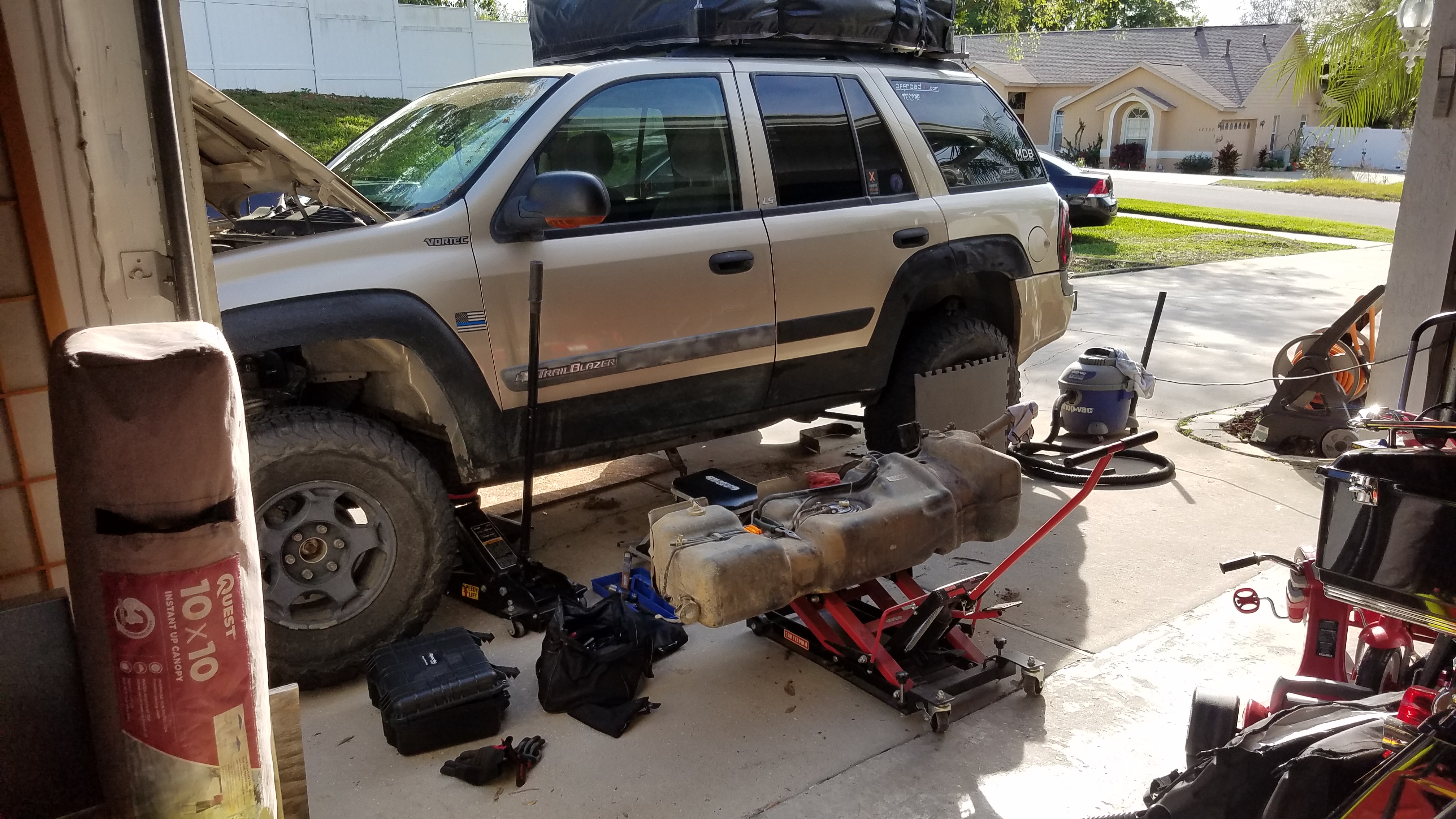

Well, I started to replace my fuel pump, but managed to break 3 of the fuel line retainer clips. Now I gotta wait for the new ones to come in from rockauto. **EDIT** Advance auto had a bunch of em in stock.
Protip for fuel pumps:
1) replace them before they fail so you get to run the fuel as low as possible. Heavy tanks are a pain in the ass.
2) Order replacement fuel line retainer clips when you order your fuel pump because you are almost certain to break a couple.
3) motorcycle jacks are perfect for lowering fuel tanks.
4) dont skimp on quality for fuel pump. Failed fuel pump is a game ender. Spend the money for a high quality. I trust ACDelco.
5) Buy/borrow the spanner wrench for the lock ring. The May03LT way of taking off the lock ring with a hammer and punch is great for getting the ring off. not so much getting it on.

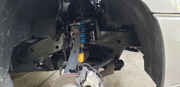

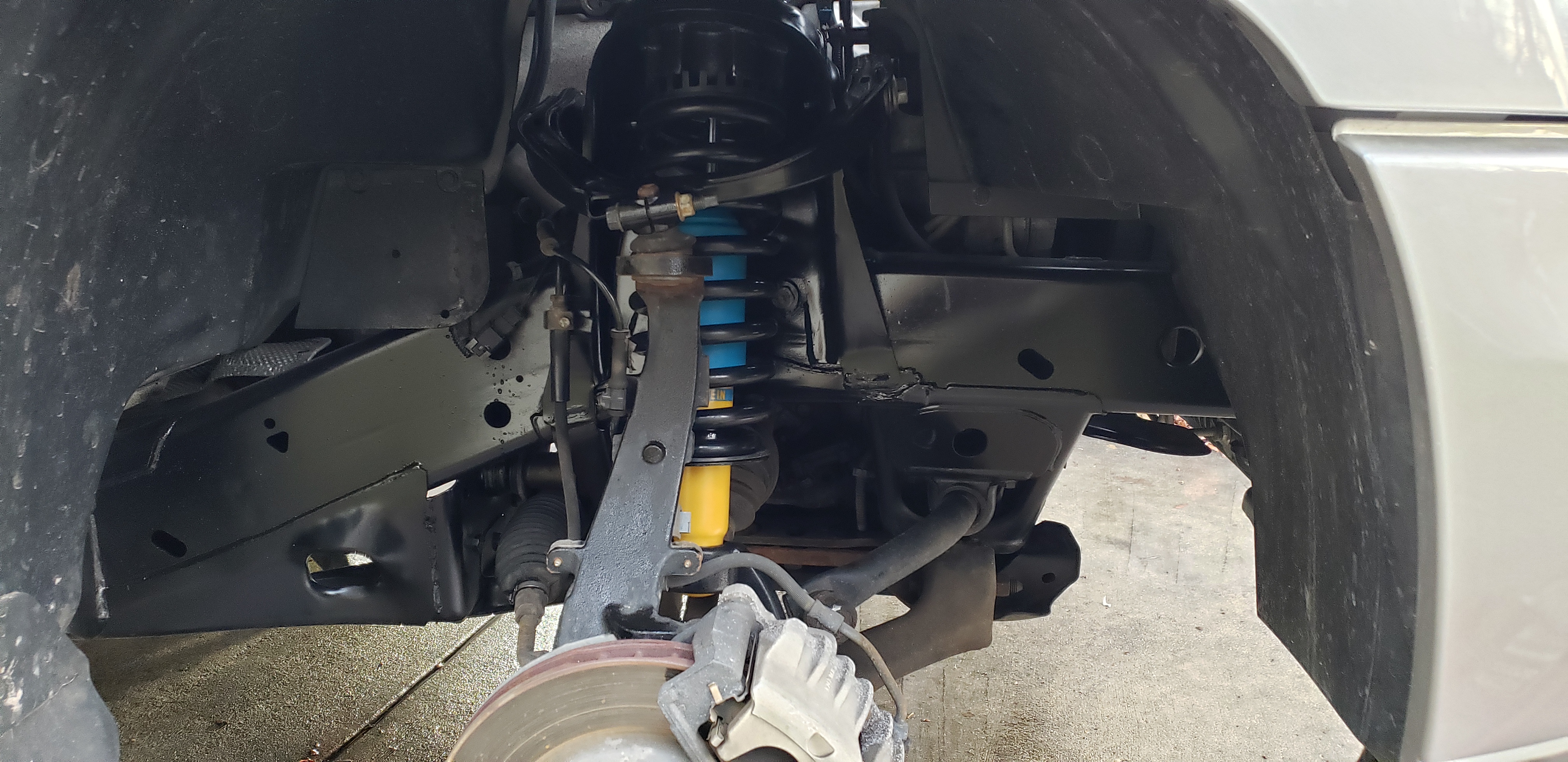

I installed a MarkMC 3" front lift.

Jeesh, looks like you polished up your frame, too. The only time mine looks that shiney is when a xmsn line bursts and sprays fluid all over.
Posts: 3015
Location: FL, Central
by Flyingfischer5 » Fri Mar 15, 2019 9:38 pm
Is that thing new? I don't think they were even that clean on the lots. HAHA

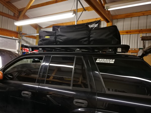

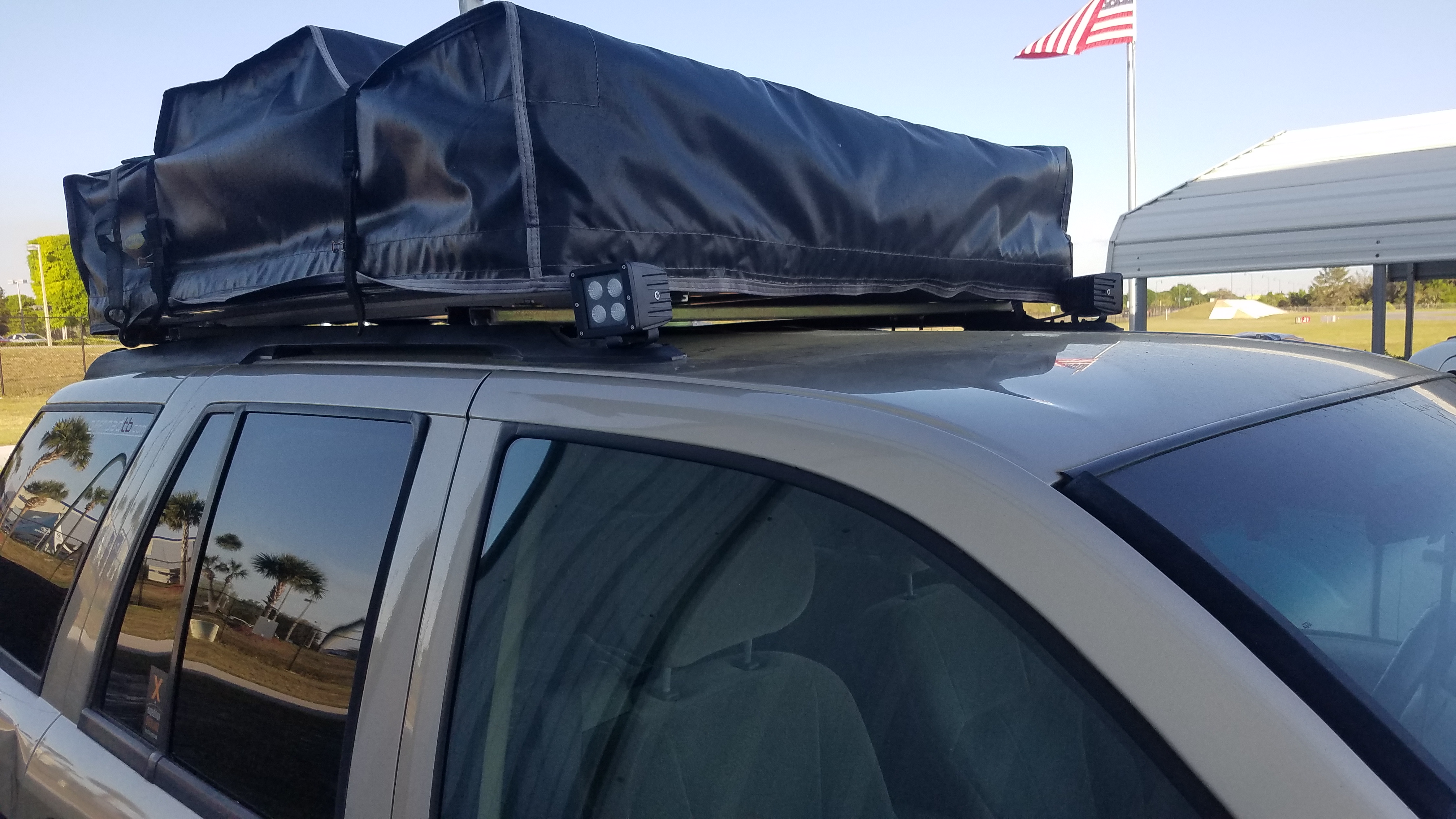

Mounted up some 3" pods as alley lights. Still gotta get them wired up, but the mounting went pretty seamless. Been planning these for a few years... taking my sweet ass time, obviously.
Posts: 3015
by Flyingfischer5 » Sat Mar 16, 2019 10:06 pm
Nice! I also put some ditch lights on mine and they work wonders. Also works great when setting up camp if you roll in late and its dark. You'll love them!

Bacon, if you are referring to the little "horse shoe" shaped clips on the tank, then i did the same thing, and i jsut put some small sized zip ties through the holes and back onto themselves. If you are talking about the same ones, looking at it, there is a small blade looking thing on the tube, so it just gets slipped in front of that. The zip tie worked for me, might for you? I dunno.
Posts: 381
by DirtyBacon04 » Sun Mar 17, 2019 11:48 pm
Anthony Hernandez wrote:Bacon, if you are referring to the little "horse shoe" shaped clips on the tank, then i did the same thing, and i jsut put some small sized zip ties through the holes and back onto themselves. If you are talking about the same ones, looking at it, there is a small blade looking thing on the tube, so it just gets slipped in front of that. The zip tie worked for me, might for you? I dunno.
Yea, I'm talking about those. I considered doing the zip ties, but dealing with fuel and vapors, my paranoia won the battle for a $6 assortment of fuel clips.

I like those alley lights Bacon. Wiring to the roof is annoying, I still run my wires through the rear door seals. Sealing wires through a hole is generally impossible unless you have a jacketed wire and a dedicated boot, or a bulkhead plug. I've never noticed a drop of water past my weather seal, and its been raining a lot here this past year.
If I had to go around the door seal, I'd do something like this:
Its a two-pin bulkhead Deutsch connector, item number DT04-2P-L012... Deutsch makes some of the best sealing plugs out there. We use them in our products at work.
https://laddinc.com/product/?sku=DT04-2P-L012
