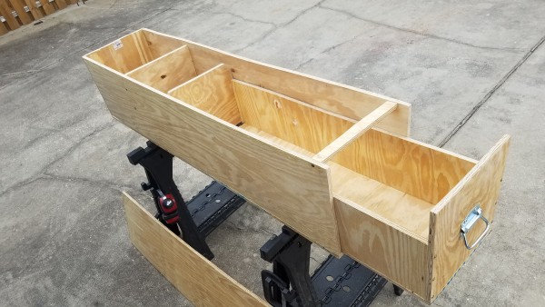

I started building the drawer/sleeper system I designed. This system allows me to reinstall the rear driver side bench, increasing my person capacity by 2. It's a long, narrow contraption. The rear 2/3 of it is a drawer accessible from the rear. The front 1/3 is a trunk type thing with a hinge-up lid. The top the container is 5.5' long so it'll double as a sleeping surface for long road trips.
I don't want to share pictures because I am apparently way better a mechanic than I am a carpenter. I am so far embarrassed at it's appearance, but I have faith it'll look better once i get it all sanded and covered in the trunk carpeting. All I have at my disposal is a skill saw and a scroll saw. I swear if I could get perfectly straight cuts, my blueprints would've been awesome. It's a friggin sturdy sumbitch, thats for damn sure. Bitch is heavy though (approximately 4 tons worth of screws, glue, and 1/2" plywood, i think)

Looking forward to seeing it bacon. In the future, a straight 2x4 can be clamped in place to be a guide for the side of the skill saw foot. Straight cuts every time with that.

by DirtyBacon04 » Mon Jan 08, 2018 1:21 am
That's a damn good idea... it'll be good for when I throw this thing in the fire and start over.

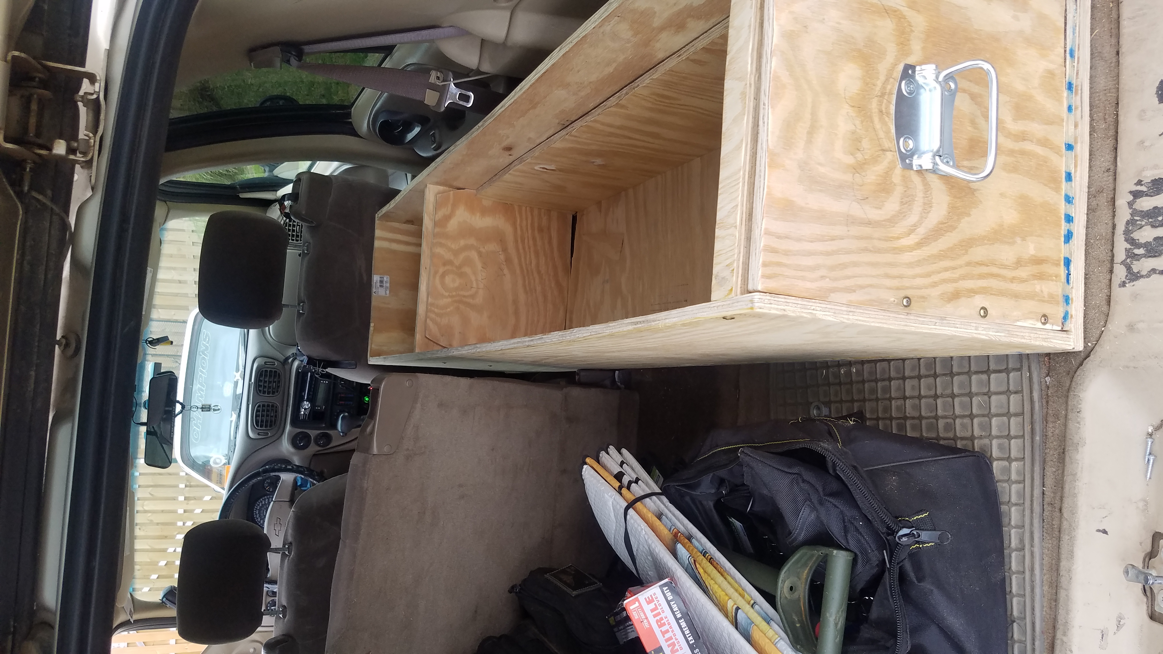

Ok, here it is so far. Obviously the lid is not completed.
Btw, any tips on dealing with bowed sheets of plywood?

Looks good Bacon. No drawer slides? That drawer might get difficult to move if you load it up too much. You going to put a latch on it to keep it from walking out?
The bowed boards should go away once you put your lid on, right, as long as you line up the edges prior to putting your screw in.

by DirtyBacon04 » Wed Jan 10, 2018 9:10 pm
Yea, I didn't feel like messing with rollers. I'm gonna line the bottom of the box with a fancy ultra low friction plastic. Should keep it pretty easy moving.

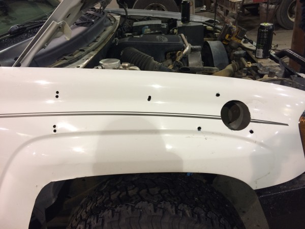

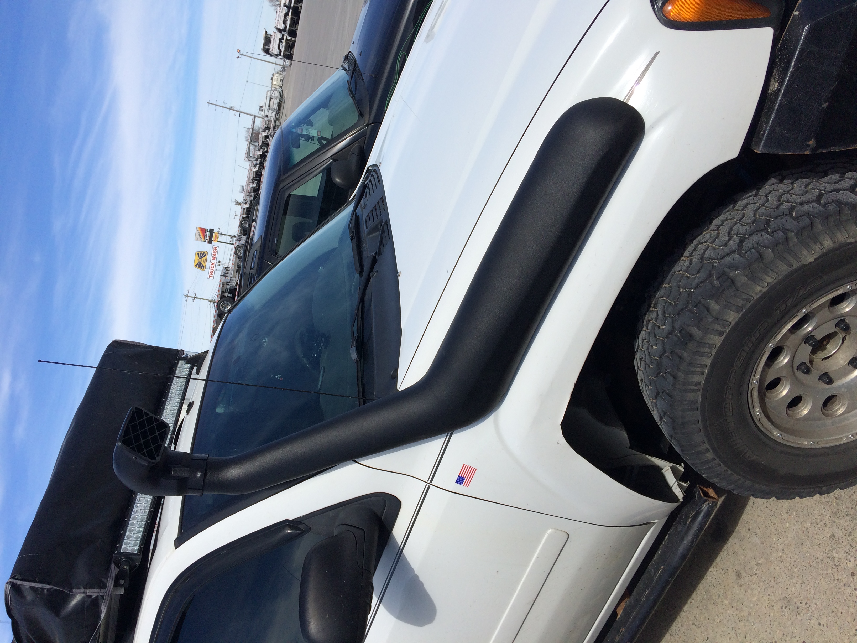

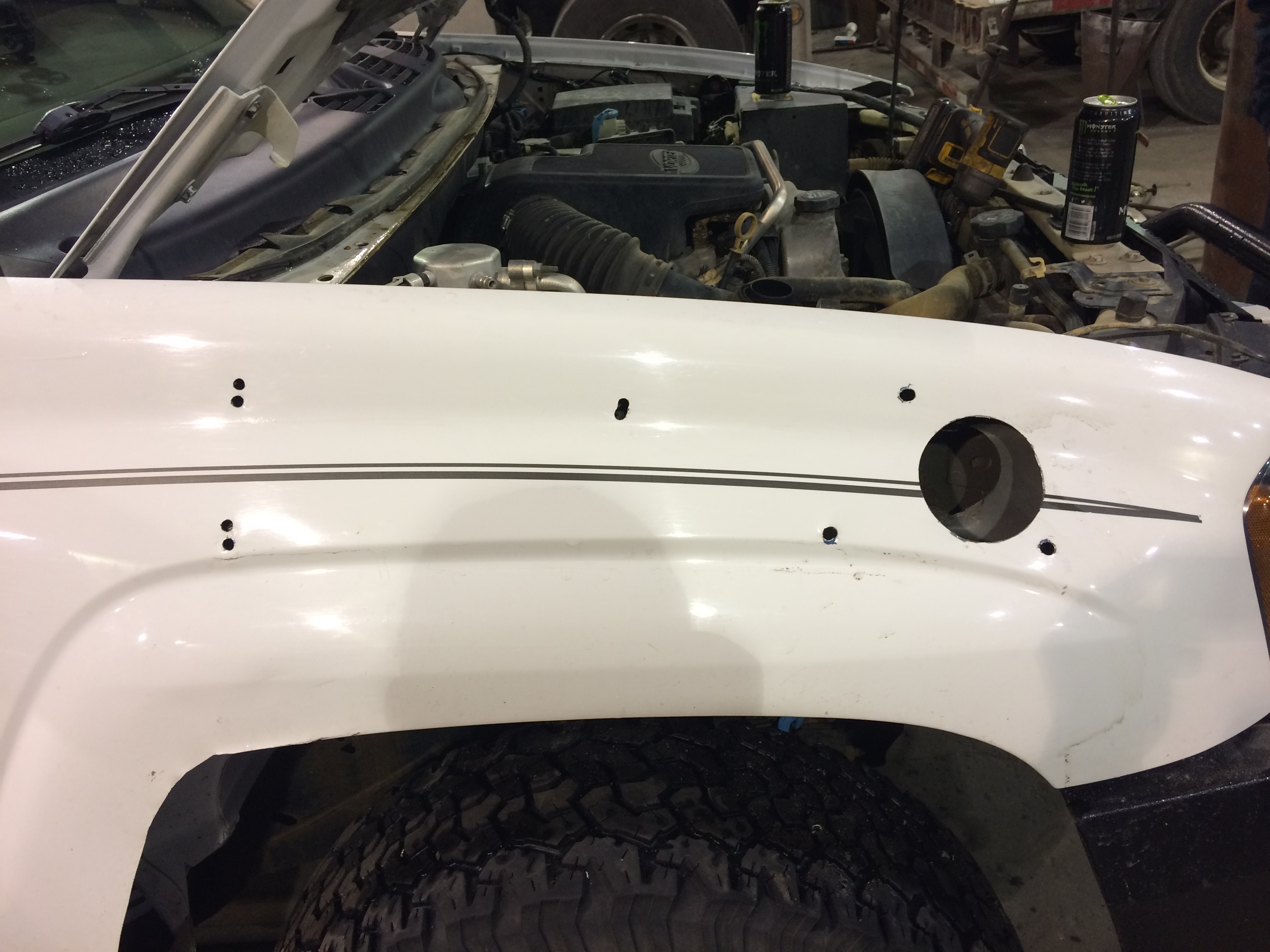

Started installing a snorkel
. Build sheet will come when I’m fully finished. Explaining any and all concerns

I'm definitely interested. That thing looks like it was meant for the TB!

Bartonmd, I’m usinh the inline filter from an f150, any inline filter would work, I chose this because it was free. I have talked to mark from bear tear drop trailers he is actually going to cad design a box for his Tb. I am removing the washer fluid reservoir to make room for it and another battery, I will get a small reservoir to put somewhere to replace. It.
Trailx this is a snorkel for a land cruiser, it is the closest I have found to our body lines

by Trail X » Wed Mar 21, 2018 8:45 am
Nice find! Which specific product did you purchase? I imagine that the different brands might have different lines. The one you have matches up pretty well.
