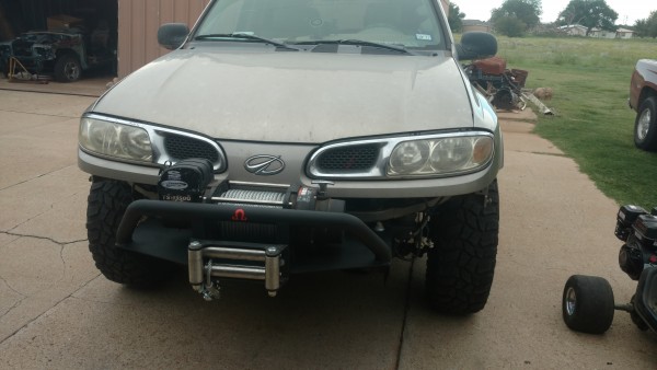

by KingBird » Mon Aug 14, 2017 12:01 am
Got this built so I could mount the winch.
We're gonna do some cool shit with the "wings" and armor for the rad and ps cooler, but I wanted the main structure finished up and mounted.

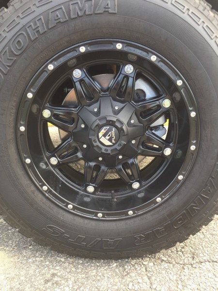

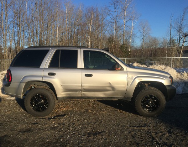

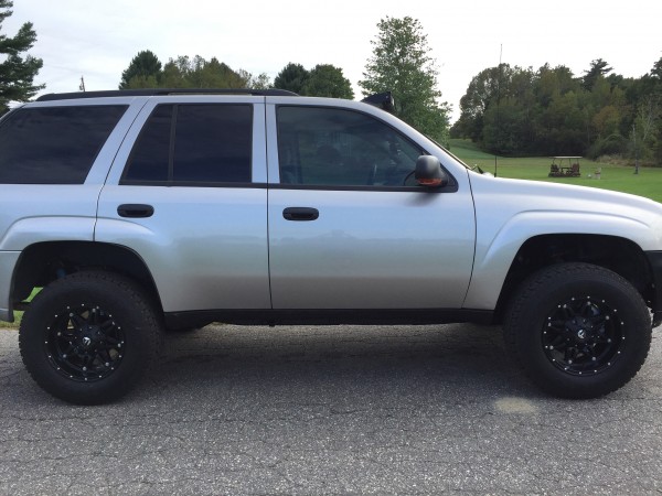

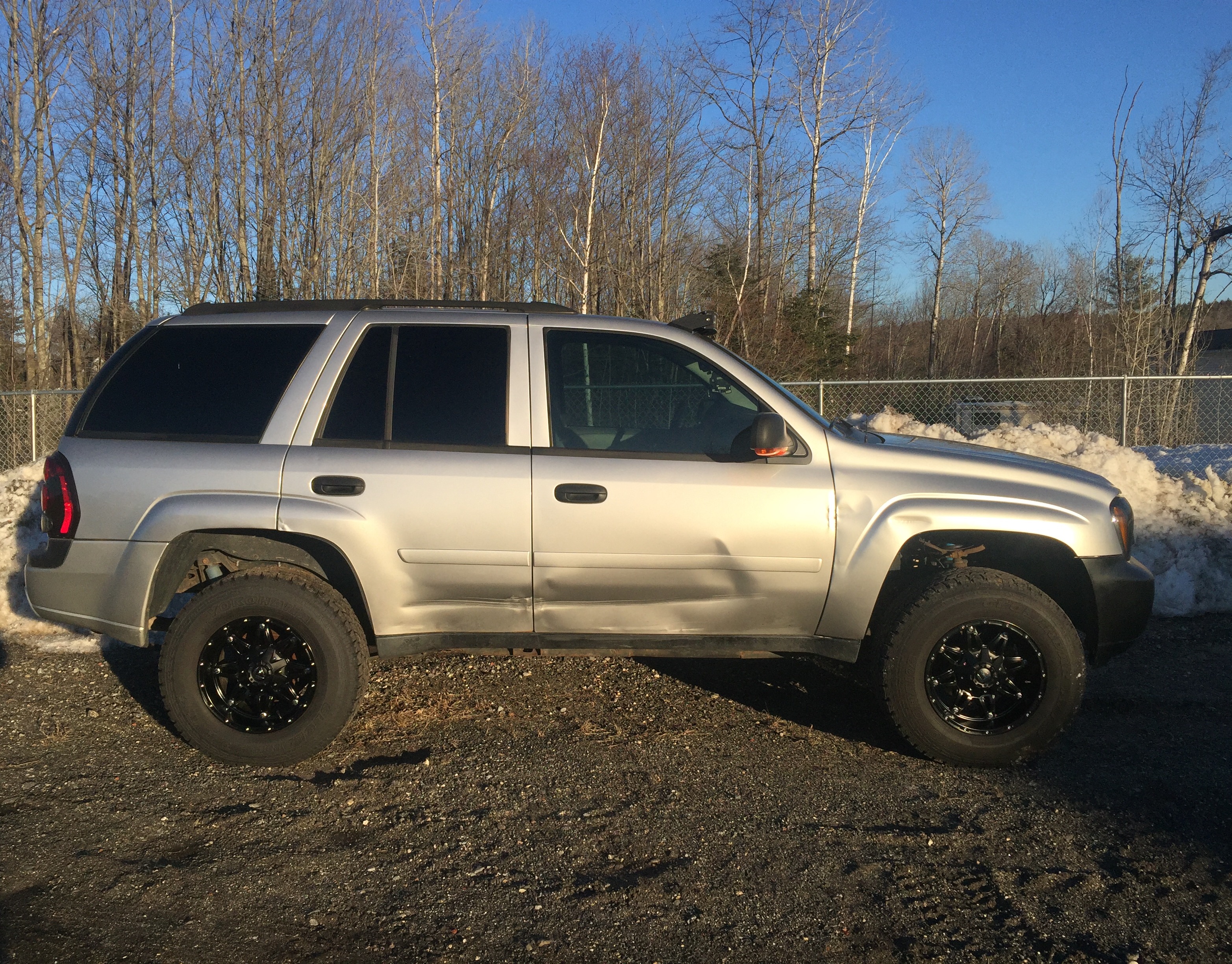

by Rickalicka18 » Wed Sep 20, 2017 8:27 pm
The Tb's been up on jack stands for about a month and a half but today she's finally back on the road. I had BOTH rear calipers start to stick which warped my rear rotors, so started with the calipers that I bought from autozone which was apparently a mistake because one of the caliper I got had a different bigger bleeder screw in it so I brought I back and they ordered me another one which had the right size bleeder screw in it (actually somehow got $4 back from them?). Then with that sorted out I had my rotors turned but they were warped really bad, like a constant scraping noise and it felt like I was driving my diesel when I let off the gas, so I got new rotors and now she rides a lot quieter and stops a lot quicker with the ext rotors up front. Bought some speed bleeders and the motive power bleeder to bleed my brakes with ease this time. Also got new taillights and FINALLY Got my newly painted passenger fender and passenger doors on. Just happy to be driving her again and have her support her own weight! :excited:

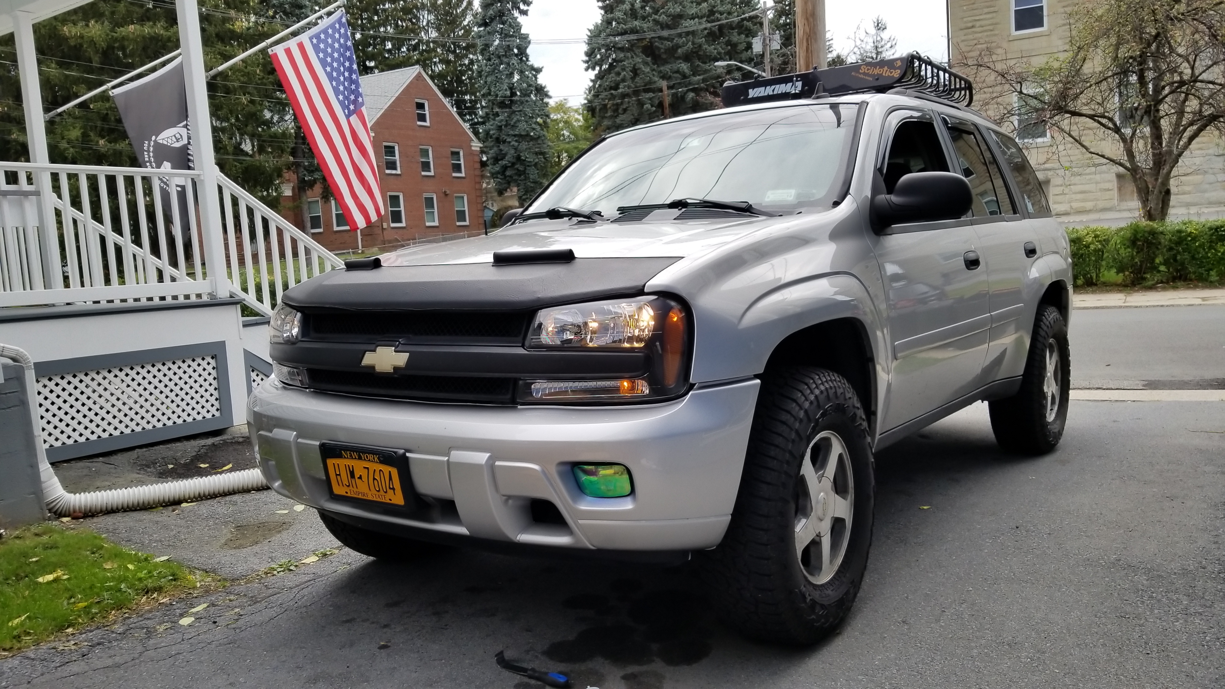

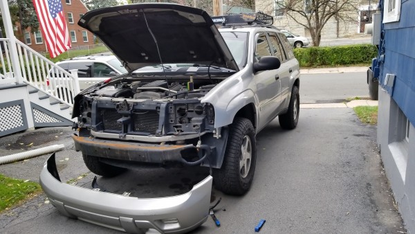

by DeviousPizzaGuy » Wed Oct 25, 2017 5:16 pm
Replaced the front bumper with an 02-05 LT Bumper, replaced headlights, added foglights and license plate bracket. Still need to find me a set of tow hooks.
