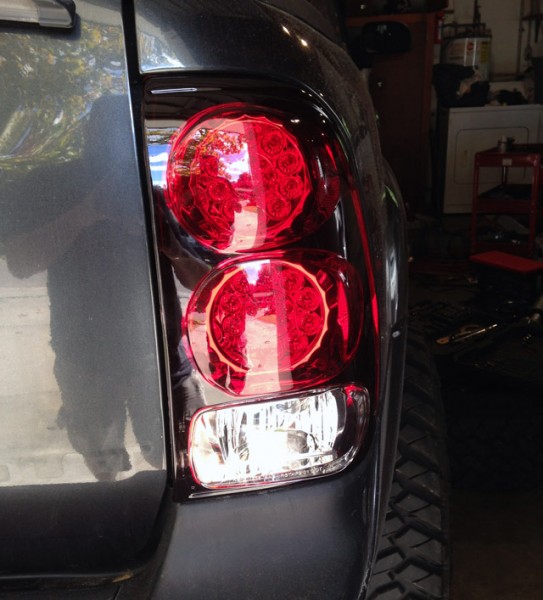

Well part of my order from Moogs showed up today. The upper control arms have the bushings already installed and look pretty solid. Curious to see what the results with the lowers will be. Hopefully not the same that Moot's has had.
Also installed my LED tails. They're bright at frack and hopefully will keep FL drivers from re-ending me.

Those tails do look good Mike. Very similar to mine, however I like those better. You mess with the hyperflash issue yet? I might try something next time I pull the grill.

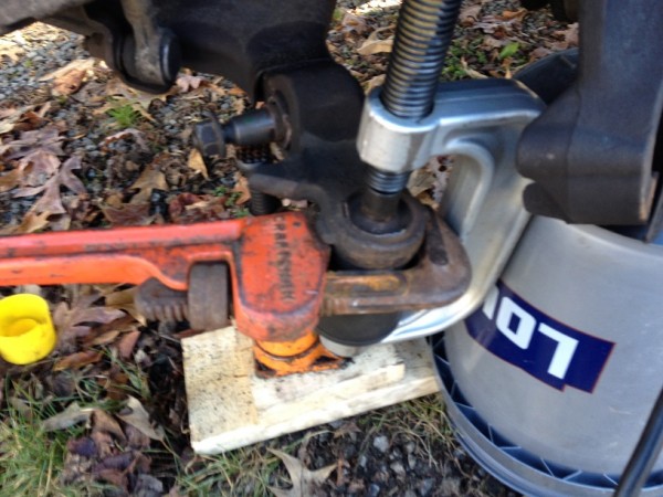

Installation of the RadFlo's went well also installed Upper/ Lower Ball joints and upside down and backwards on the UCA. But in the processes I noticed I need to replace my CV axles, inner / outer tie rods, sway bars links and while I'm at it I may do the front a wheel bearing hubs
The ball joint press I borrowed from Advance Auto did not have the proper adapters to press out the lower ball joint so it took awhile for me to find a shim thick enough to make up the difference.
"Just to clarify, the pipe wrench jaws are being used as a shim to take up space. There was no turning of the PW at all."
