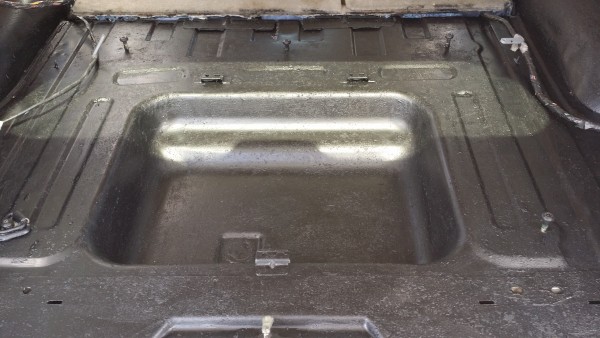

Took out the heavily stained rear cargo carpet and rhino lined it, as well as installed my lightbar. Did the same to my buddies wrangler

Is that actual rhino liner or what did you use? It looks good.
by jrivs4x4tb » Thu Sep 17, 2015 4:55 pm
It's duplicolor bed liner about 3 coats ,I'm thinking of removing all my carpet and doing this.

by jrivs4x4tb » Thu Sep 17, 2015 4:59 pm
It's applied with a brush or roller. Easy job and each coat dried for me in 10 minutes with credit given to the Arizona heat.

by DirtyBacon04 » Thu Sep 17, 2015 5:44 pm
As many times as i've had to dry out my carpets, i've been seriously considering the same thing

by jrivs4x4tb » Thu Sep 17, 2015 9:28 pm
It's worth 8t, I had about 2 gallons of water and oil in the little compartment under the carpet

by jrivs4x4tb » Fri Sep 25, 2015 2:33 pm
Quick tip for anyone attempting this. The can says it fully dries in 24 hours but I found it takes about 5 days to become fully rigid. Found this out the hard was as my big 4 ton floor jack took a nice chunk out of it after I let it dry for a day and a half. After 5 days I purposely dropped the jack on it and no damage was taken.
