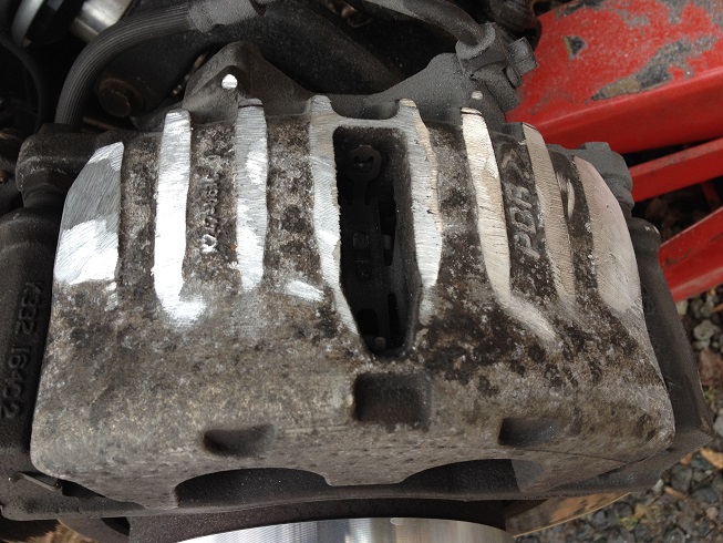

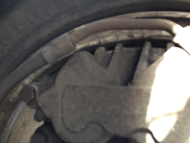

Fitting 16x7.5 OEM H3 wheels with on my EXT
I had to do some grinding on the caliber to get the wheels to roll freely but I ended up with 3/16 to 1/4 inch clearance. Drove 75 miles today without any issues.

by ErikSS » Tue Dec 17, 2013 7:46 pm
Looks good man! How much do you think you took off?
