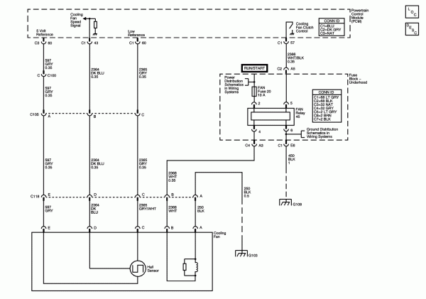

I’ve never really liked the stock fan clutch on these as it has always given me the impression of a great idea on paper that left a lot to be desired in execution, not to mention they have a reputation for failing. Though other than the jet engine sound at startup that had annoyed me years back until dealer replacement and reprogramming, mine seemed to be working correctly—for the moment, as a 2002 it was probably only a matter of time before it failed. It was going to need replacement sooner or later, so instead of spending more money and effort on something I don’t like, I took it as an opportunity for a change.
But the biggest reason for the electric fans, goes back to fixing the “problem” in the system—the radiator. We can’t make it much taller or wider, so for increased size that leaves us with thickness. I don’t see how we can easily fit a thicker radiator with the stock fan in the way. The stock shroud isn’t something you could easily trim very much and still retain its function. It looked like moving that shroud even a little bit would be problematic.

Thanks, guys. I should have noted:
Karo wrote:especially that you have completely done it without using (reprogramming) the stock PCM.
While the PCM plays no part in operation of the fans, I did have to program out the codes it throws when you don't have the fan hooked up.
Karo wrote:You are using a different grill mesh on the “fan sucking video”, could you tell what kind is that?
It's this one, sold by quite a few on ebay:
http://www.ebay.com/itm/2006-2007-2008- ... es&vxp=mtr
It's made for later model vehicles so it requires some modification to fit on earlier models; how much will vary depending upon what sort of bumper you have. While I like it a lot, testing showed it helped cooling but not really as much as you might guess. The really nice thing about it is it gives you a bunch of room to allow you to mount a tranny cooler anywhere you want, you can even mount some lights behind it, etc. And after 10 years of the stock grill, I think the new look is refreshing. ;)

by Karo » Fri Jan 04, 2013 5:17 am
Jon, one more question. For Example when driving the TB in hot weather on the Highway and parking it (completely shut off with no key in the ignition switch) the fan is still running to cool the engine down. Did your setup will do that too?

by Jon A » Fri Jan 04, 2013 10:12 pm
Karo wrote:Jon, one more question. For Example when driving the TB in hot weather on the Highway and parking it (completely shut off with no key in the ignition switch) the fan is still running to cool the engine down. Did your setup will do that too?
No. The controller has a wire that goes to positive ignition and will shut off the fans when the vehicle is shut off. You could wire that to battery, but then you'd need to manually turn them off with the switch every time--and more importantly remember to turn them on again next time you drive the vehicle. I really wouldn't suggest it unless you're a drag racer. Big fans will drain your battery fast so be careful if you do.

by OKTrailblazer » Fri Mar 13, 2015 4:33 pm
This is a great write up, why not just use the PCM controlled connection from the Fan Relay what would be circuit 2368/WH wire? The PCM is going to know when it wants the fan on and off. It is going to throw a fan speed DTC and Check Engine light, but easy to program out.
