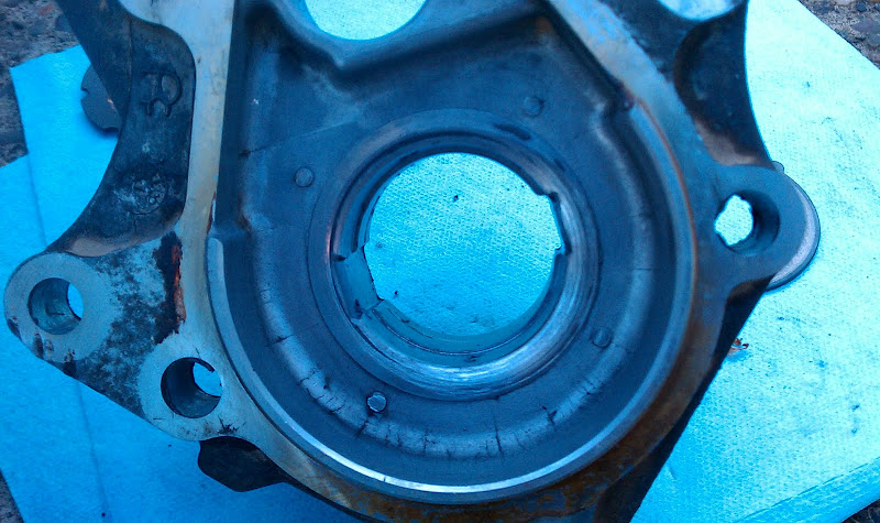

My outer case also showed some signs of wear. Amazingly, the races themselves were in good shape.
Despite all the carnage, the bearing and teeth on my gears looked good, and nothing else had any physical damage.
