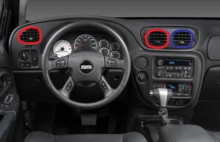

Hey fellas, in my 2002 Trailblazer, an issue as come up with the air conditioner. After a long and frigid winter, I attempted to blast my AC, problem is, it is blowing hot air. The strangest thing is, is that it is only blowing how air out of what I would say are the two driver vents as shown in the picture below (not my TB just example found via google).
Any help would be welcome, I really am not looking forward to a summer of hot air inside and out. The sooner the better would be nice!

Looks to be a problem with the dual climate control switch... seems that the hot air is only coming out the driver side vents, and cool air should be coming out the passenger side ones. This is a question for Bill or James to answer.

Bad actuators. Did you loose battery at all during winter? I have the manual control unit. I need to replace at least 2 actuators, maybe 3. I'm not getting air out of the lower vents and I'm unable to properly control hot/cold air from the upper vents...

Maybe just one bad actuator. Both kinds of systems have the same five actuators. You just have a bad driver's temp unit. Plenty of discussion on the OS.
