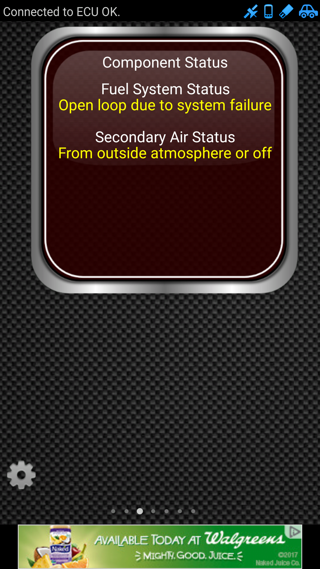

Drove around the block a few times and all was well. No issues. No stumbling, nothing apparent. Decided to bring it out on a bigger road with a little higher speeds. As I was going up the first hill, the O2 readings flatlined. It hesitated for a minute, then the PCM switched into open loop mode.
So in my mind, I started thinking the O2 sensor could have a temperature dependant open or short circuit. Sure enough, a few minutes later, P0130.

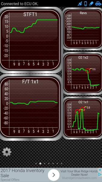

Here's a quick screen shot of what would happen with the O2 feedback and STFT graphs in Torque when it would go flakey. When it did this, it would go into open loop. Unfortunately it doesn't display voltage, I didn't realize that was a separate display till just now. I drove it a bit more today and it acted fine other than popping between open and closed loop. Although, there was a tiny squeak once in 5 times I shut it off. But it may have been doing that for a while, I'm not entirely sure.
I'll try to drive it again in the morning to get some raw O2 voltage data, then swap the O2 tomorrow evening if I have time.

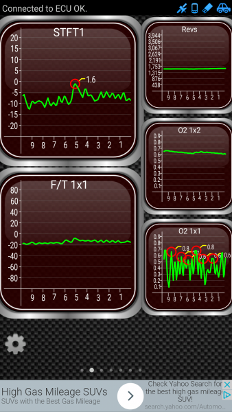

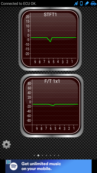

Here's a comparison between how it was acting with the bad O2, and how it acts with the good O2, including voltage displays. These screen shots aren't taken at the same point on the road, but it may give others an idea of what to look for in the future. It's a bit subjective.
I'm going to update the thread title with something a little more descriptive, and a little less dramatic.
O2 sensor incorrectly reporting combustion and causing ECU to incorrectly rich the mixture. CAT had not completely warmed up, as this was a short drive, which I believe is why the O2 1x2 (post cat) sensor went low. It does that a bit before the cat warms up completely.
Properly performing O2 sensors and fuel trims.

Looks like the scan with the new o2 sensor is still running rich. What was the engine temp when you did the scan?
At full temp the stft should be hovering around -5 to +5 in closed loop.
The new o2 is definelty working better.
