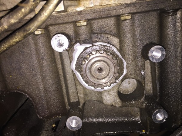

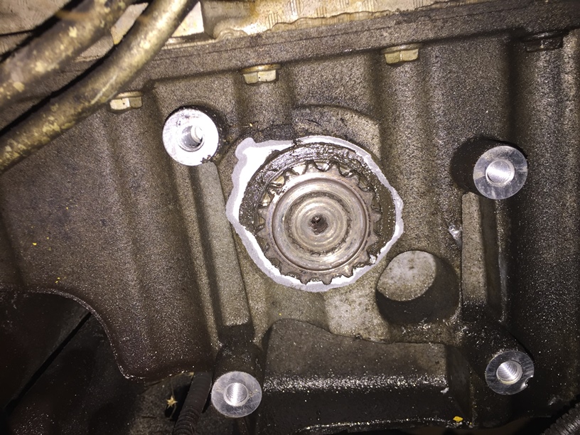

by bljis123 » Fri Nov 11, 2016 10:21 pm
My freaking disconnect housing busted and it stuck to the oil pan. This has me stumped for a while now. I am scared to damage oil pan.

by Trail X » Sun Nov 13, 2016 12:02 am
Others have drilled theirs out. You'll have to do the same. Pull the gear out, and pull the intermediate shaft out, then you'll have to make small drill marks around the perimeter of the needle bearing to relieve the pressure.

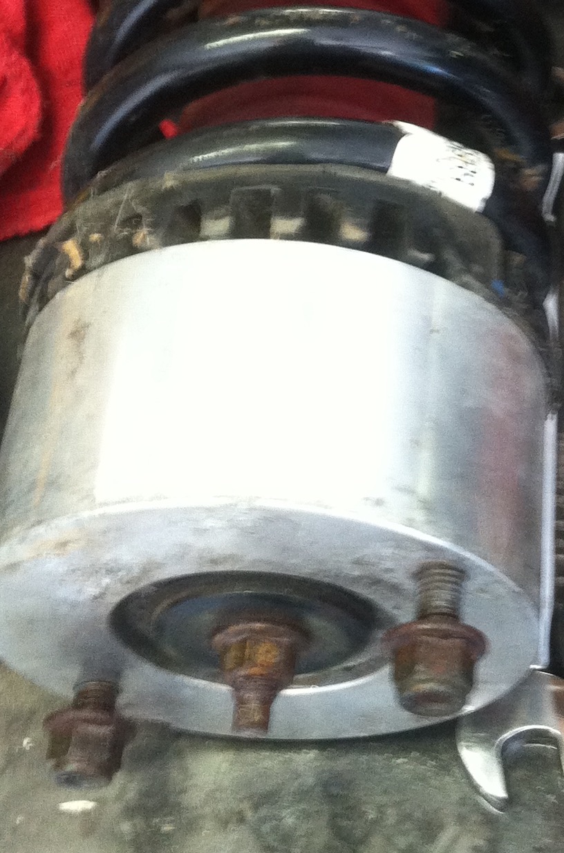

by mason10198 » Fri Nov 25, 2016 1:24 pm
I rebuilt the whole front-end from struts to bushings to tie rods, also installed my '87 springs and brand new struts, new CVs, got it aligned and took it out camping this weekend. Went through a fairly rough 4wheeler trail and started hearing a gnarly rattling sound Everytime I hit the slightest bump. Got out and looked to find this. Driver side strut/lift tearing itself apart. Passenger side is okay but washer looks bent. I guess I have too much lift now with the 3" block and '87 springs and I need to put a 2" lift in instead. But I'm not the only one running a 3" and 87s right??ImageImageImage

by Anthony Hernandez » Sat Nov 26, 2016 1:23 am
What kind of lift do you got mason? The bushing plate is hella small. The one I put on the lift he's selling is the upgraded bds washer. I got it from James, it's supposed to be better.
Posts: 381
by mason10198 » Sat Nov 26, 2016 1:39 am
I've just got Mark's cast 3".
Posts: 501
by mason10198 » Sat Nov 26, 2016 11:03 am
I REALLY don't want to say I could have put it together without the washer plate..... But I don't know how the heck it would have got out of there if I did put it in.
Posts: 501
by Anthony Hernandez » Sat Nov 26, 2016 12:01 pm
Dude my washer palate looks waaaay different, I have marks 3" it pretty much covers the entire bushing and then some and it's not conical

by mason10198 » Sat Nov 26, 2016 1:33 pm
Huh, weird... I guess I could ask him about it and see if he can send me some new ones?

by mason10198 » Mon Dec 05, 2016 4:29 pm
Just for closure... Everything is fixed now. Apparently, I was in such a hurry when putting the front end back together that I completely neglected to put the washer between the strut bushing and holding nut... Complete idiot right? I know. I pulled it apart and the bushing wasn't too bad, so I just flipped the top/bottom bushings and put it back together WITH the washer. All good now!
