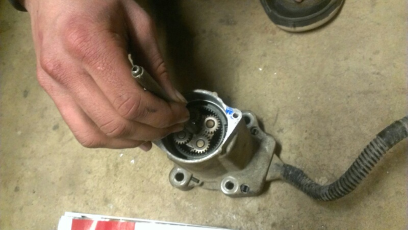

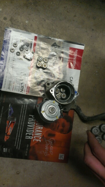

Ok guys. Iv replaced the TCCM which fixed the service 4 wheel drive light. Everything appeared to be working properly. Said I was in 4hi, lo,a4wd but it wasn't. Both the encoder motor and the actuater work. I followed James's schematic on diagnosing the 4 wheel drive system. I have a backround with 4 wheel drive so we did some diagnosing of our own. I pulled the actuator and engaged 4 wheel, seemed to be working fine... I even used an extension instead of the actuater to engage the 4 wheel. So the disconnect also seems to be working properly. Then I pulled the encoder of the t-case and opened it up to see if it was messed up.
All appeared well. I ultimately had to open it up because the splines didn't line up with the t-case because I engaged 4hi with the encoder off and the service 4 wheel system came on and I couldn't spin the encoder anymore to line it back up. So my question to you guys, if in park, with 4 wheel engaged should the front prop shaft spin? I belive it souldnt but my brothers say otherwise. If it is spinning it would be the t-case blown right?
