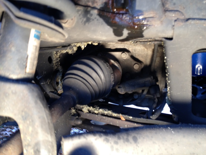

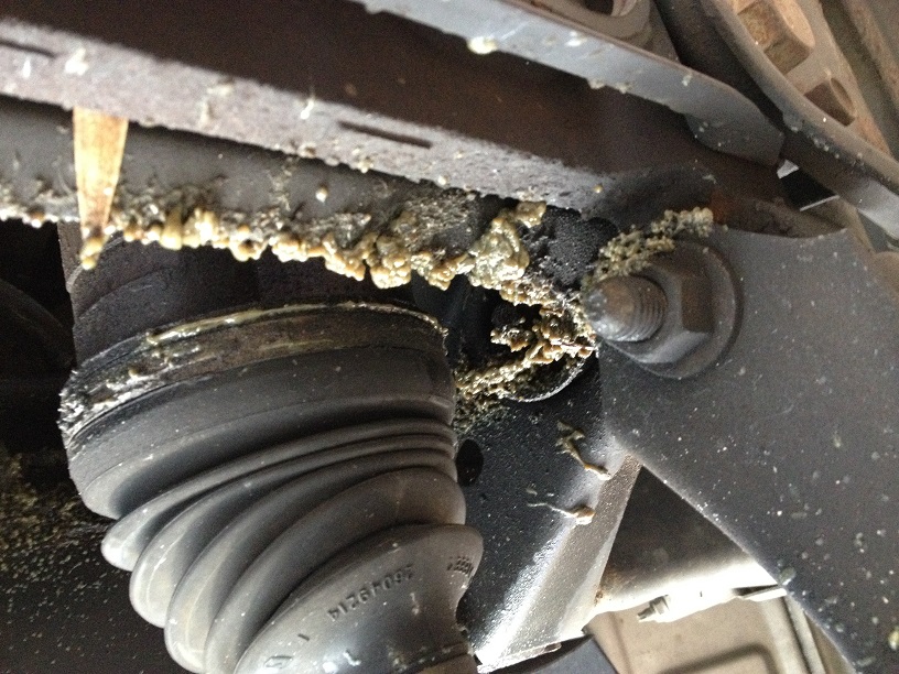

I take it this is a bad CV Axle? :scratch: This gray grease was not there 5 weeks ago when I checked the disconnect.

As long as it hasn't been submerged in water, then you can salvage the axle. Take the tripot off , go buy a can of CV grease for $5, repack it with grease, put a new clamp on it and call it good.

Ah don't worry about it.. mines looked like that for weeks

Yes they are. Your cv joint should be fine, just hose clamp the boot in place. Mine looked like that a few weeks ago and I cleaned out the old grease and pumped in some new grease before doing the clamp.

As long as you inspect your vehicle regularly, there's no need. If you notice grease flung around the inner tripod joint, then replace it. There's a good chance that the band will hold up, mine have.
