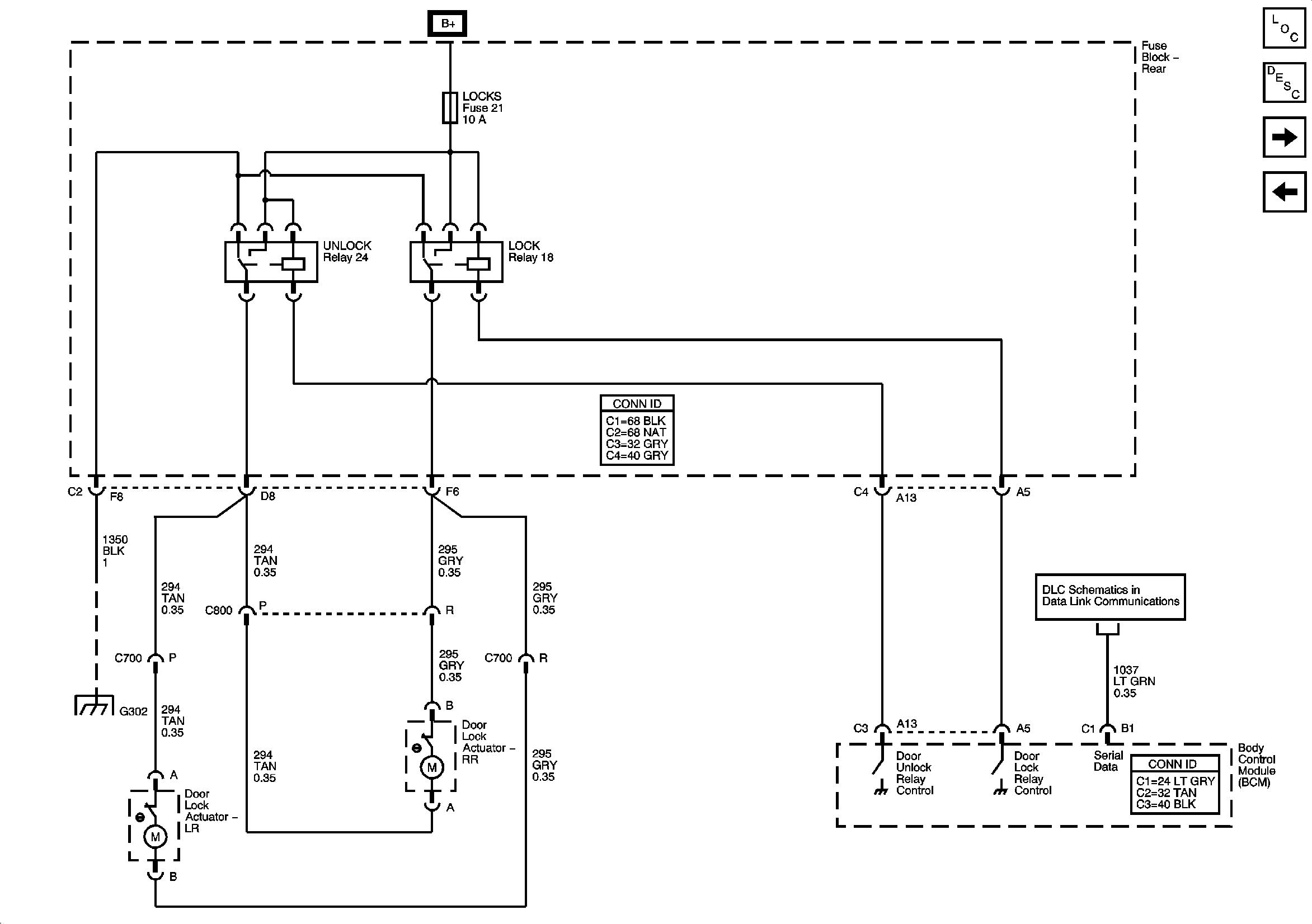

There are two related relays in the rear fuse block under the back seat. One is the rear 'Lock' relay. The other is the rear 'Unlock' relay. Find them and swap them. If they unlock, but don't lock after. Get a relay. Otherwise some circuit testing will be necessary.

I can't post a fuse block diagram from my phone, but the attachment should be the schematic.

by SaltWaterDrinker » Wed Oct 09, 2013 10:34 am
Squared away Walt! I don't know what I did but toying in the fuse box did something.
