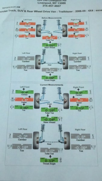

by Bacnbit » Tue Apr 29, 2014 12:23 pm
WOW
I can see vibrations here. This is not yours. But the couple I did find look very simuliar.
Camber and Toe this far out yes vibration on excell when the tires camber off slightly.
Does anyone ever take the time to modify to correct caster or do they just live with someone telling them caster doesnt affect tire wear BS? And an alignment tech that was taught The "green and go method".
I would hope everyone is having their alignments done or checked a couple times a year with the modifications and more so for the guys wheeling. To protect their Tire investments.

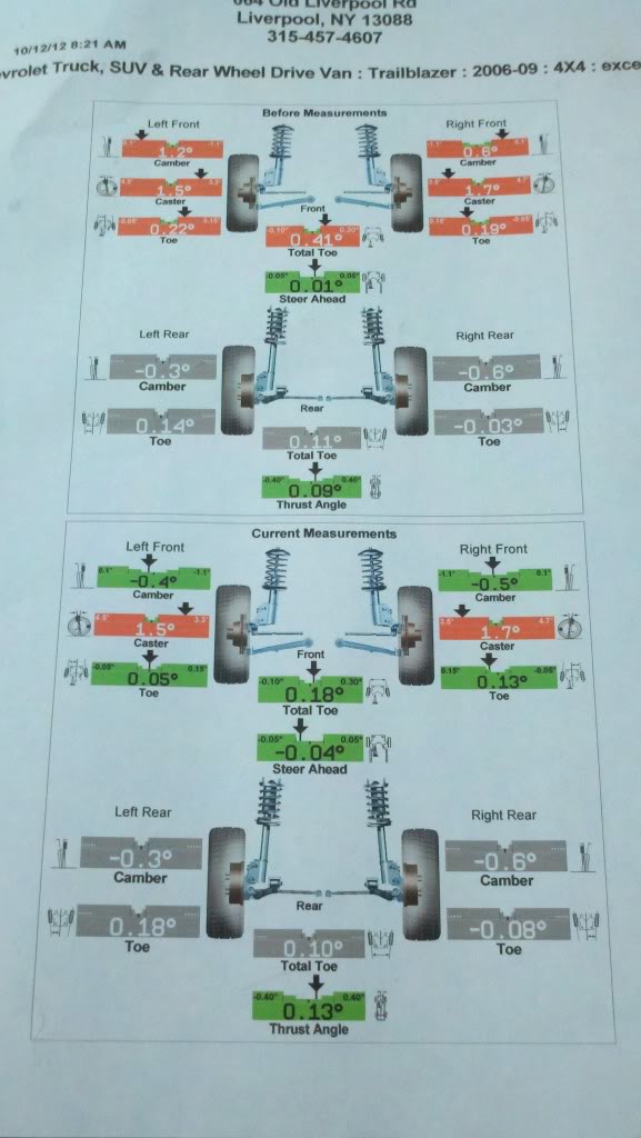

by Opeth » Tue Apr 29, 2014 8:19 pm
Live with the caster or go through upper ball joints with their extreme angle. My tires are wearing just fine and that spec sheet is mine.
