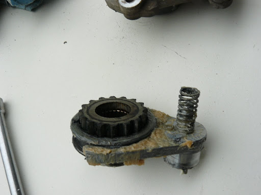

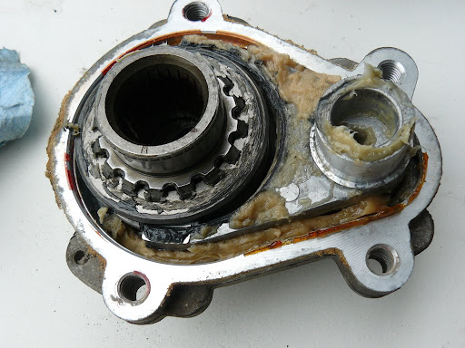

Here's a picture of the internals. (these are not my pictures... just found them so I can shed more light on this topic)
Here's the shift fork on the syncro.
Apparently the small nub under the spring can also shear off. I guess this happens if the engagement is too hard and the shift fork somehow gets bound up on the syncro. Evidence below.
I honestly don't see any down-side to engaging the syncro all the time. It wouldn't induce any more wear on the trans clutches, because as is, they have relative motion between the clutches whenever 4wd is not engaged, as the front prop-shaft does not turn. The only element in the TC that would see more wear would be the front drive chains, as they would constantly be moving. The front diff wouldn't wear any more than it currently does, but it would wear in a different part, currently the diff housing does not spin with 2HI engaged. All motion is therefore transferred through the spider gears... interestingly, spider gears aren't really designed to constantly spin anyways. You would however make the front diff spin all the time, but it wouldn't be any different than a standard rear diff that spins all the time.
So really, by constantly engaging the front disconnect, I only see slightly more wear on the TC front drive chains... nothing else that I can imagine.

Oh, the pressure needed to push on the fork is exceedingly high. Look at the exposed gear train here, and there is yet another stage hidden inside the plunger.
