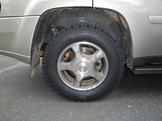

Wheels / Tires: BF Goodrich All-Terrain T/A KO2, in LT265/70-17 Load Range E. Stock wheels with 1.5" hubcentric spacers/adapters.

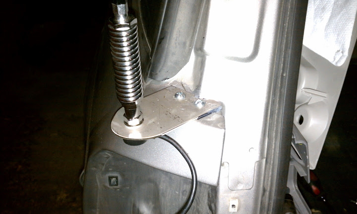

- Cobra C75-WXST CB Radio, and associated antenna (seen below)
