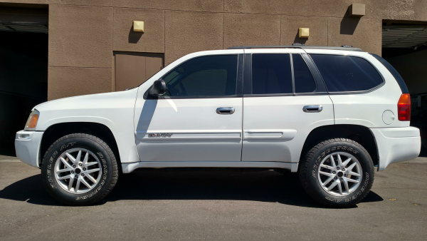

https://supremesuspensions.com/pages/pr ... c~md_envoy I run just the front 2.5" with suburban XL rear springs and no rear spring spacers I'm currently running a 255-70-18 (32") tires on mine with no rubbing but did have to adjust the fender to the rear of the front tire
